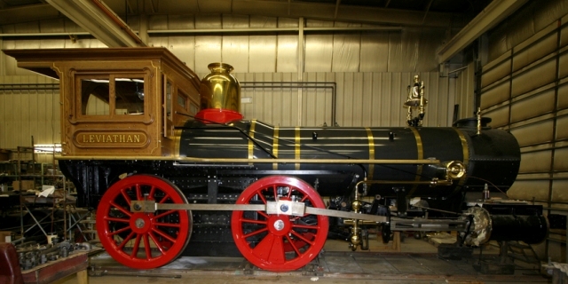

Here's a photo from this week showing the progress on David Kloke's replica of Central Pacific #63, Leviathan. Leviathan was a sister engine to Jupiter. Photo credit belongs to Christine Funk.

Looks beautiful! Will she burn wood like her sister? Hope to see travel around a bit, after the Michigan event. An engine this size would be perfect for that. It happens very frequently in the UK but not so much here.

Sadly, she's an oil burner. You'll have to wait for the "Lyon" replica to be completed before you see any new woodburners out and about. www.vtlyon.org
She will travel around, but I'm not sure how often. I would definitely head to Michigan if you can.

Very nice! Concerning the recent thread, you know, this locomotive isn't not quite a mainline 4-6-2 like the British A1, but it's in the ballpark.
It doesn't seem like a monumental leap to progress from building new locomotives like this to an NYC Hudson replica or whatever.
