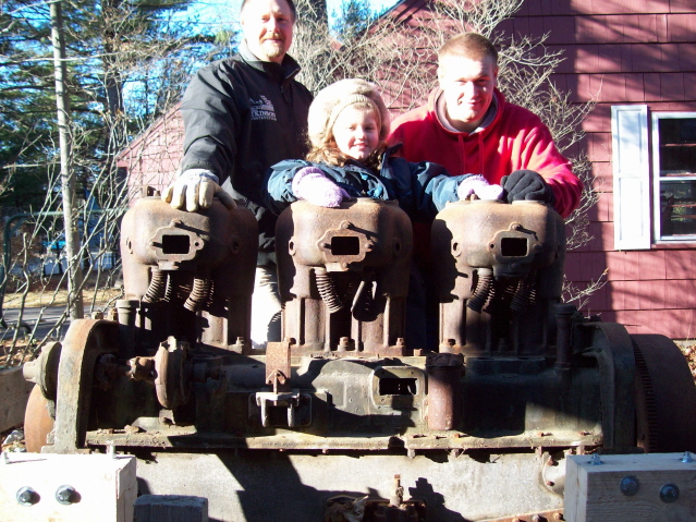

I guess this could be considered off-topic but it does involve two of my favorite subjects - locomotives and old engines.
Iam currently deep into the restoration of a 1924 Wisconsin Model PT engine. (6 cylinder, water cooled, T-head, 5-3/4 Bore, 7" stroke) it originally powered a Lombard Log hauler. Anyways I need to replace all the intake and exhaust valves. All the originals were bent when the bronze lifter guides were scavanged many decades ago. (I have replacements for those!)
Needless to say finding original valves for this engine - or any parts at all is impossible. They were not a high production item. Mine is No. 1145 and these days most people associate Wisconsin with air cooled engines.
The original valves are: 2-5/8" head, .5" stem, 8-3/8" long.
I have 3 used valves that came from a Cooper-Bessemer that powered a 70 ton GE Locomotive. They are a bit oversize but I can machine them to fit. I need at least 9 more.
So.... if you have any laying around the shop............
Below is a photo - Note the crankcase is a 500 lb bronze casting.
Best regards,
Terry Harper

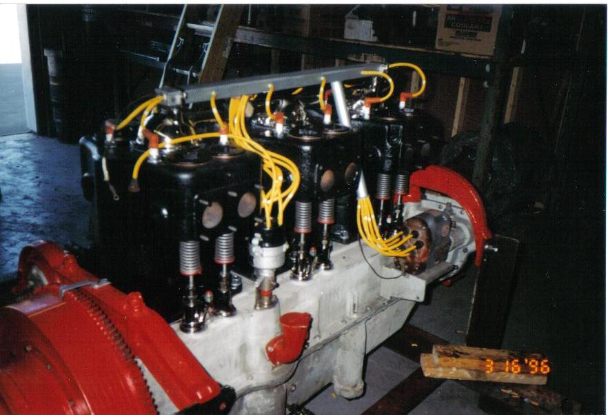

You also may want to look at old fire engines specificly Lafrance. The old "Jug head" engine they used up untill the 30's has a very simular design.
 Post subject: Re: Valves for an engine project
PostPosted: Wed Mar 18, 2009 7:24 pm
Joined: Mon Aug 23, 2004 5:11 pm
Posts: 373
Here is a picture of a 1924 lafrance I restored a little while ago. note the simularities in valve layout and design.
