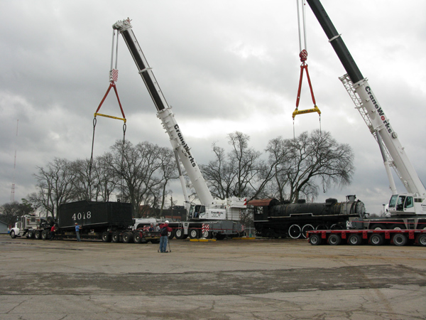

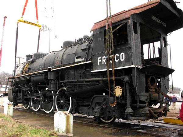

Today was the first step to relocate the locomotive that has been on display at the Alabama State Fairgrounds Fair Park since 1952. Final destination is Sloss Furnaces NHL in Birmingham.
The first step was to lift the locomotive and hold it for 30 minutes to verify crane weights, integrity of lifting points, and crane handling. The tender has been loaded onto a trailer and will leave the park tomorrow. In the morning the locomotive will be re-lifted and loaded onto a Goldhofer Transporter and moved across the Fairgrounds to CSX where it will be loaded onto a depressed center flat car. Once at Sloss the locomotive and tender will require mulitple lifts to reach the final resting place.
This project has been made possible by efforts of the City of Birmingham, Jefferson County EMA, Historic Machinery Services, Crane Works, and Barnhart Crane and Rigging. This move is being used as training and demostration exercise for heavy lifting and moving for the local EMA's in Alabama.

Wow, what happened to the cab roof and the handrail?

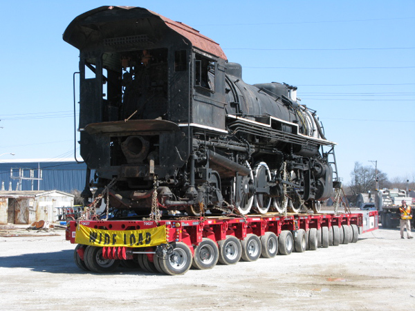

The locomotive and tender were both damaged when the canopy was removed. The concrete and steel roof appearently disinegrated as it was being removed.
The attached pix is the locomotive on the Goldhofer Transported, moving into position for lifting onto the flat car.
