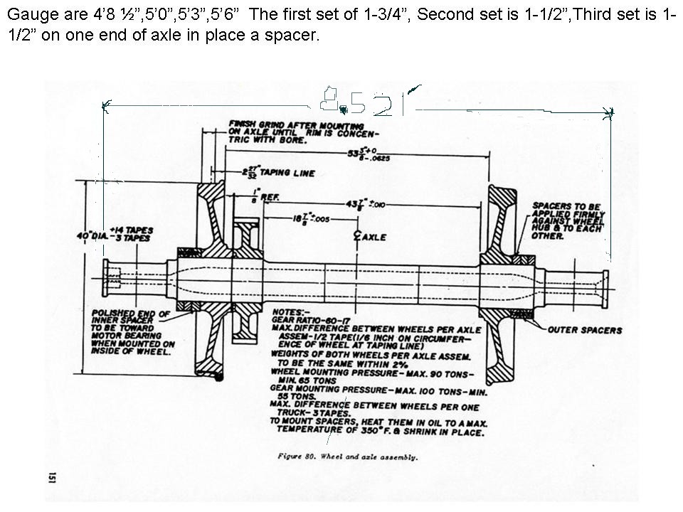

Here is the Drawing that show the Axle and Wheel.
Want I need a the AAR Specific and Mircoinch in the Gear and Wheel area.
Stan Paulsen
