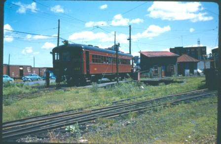

Of course there is one more way to turn cars around, but I don't think we will see an electrified turntable, like the one shown below, in the near future!
Pete Schmidt
File comment: QRL&P turntable in Quebec City
Peter Schmidt
