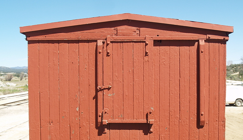

We have an old all-wood boxcar on our site in Campo, CA. Old photos show it on the ground near the 1916 depot since around 1916. Some people speculate that it might have actually been the "depot" while the regular one was being built. In the last few days we have put it on trucks on a snap track, and are considering how to best "un-remodel" it. One question has come up: there is a relatively small door mounted high on one end. Was it part of the original boxcar? Was it something added when it may have been in MOW service? What was it used for?
One suggestion is that it was for loading lumber that was too long to load through the regular side doors.
Anyone have any suggestions?
Thanks,
Jim Baker, PSRM

 Post subject: Re: End Door on a Boxcar
PostPosted: Thu Mar 19, 2009 1:29 am
Posts: 140
Location: Northern California
My understanding is that you are correct - the door was for loading lumber.
Joe Magruder
PostPosted: Thu Mar 19, 2009 2:10 pm
Joined: Tue Nov 09, 2004 12:27 pm
Posts: 157
Yep that is a lumber door, used to load long lengths of well, lumber.
Richard Wilkens
PostPosted: Thu Mar 19, 2009 3:20 pm
Posts: 269
Location: San Diego area
Thanks for the information. I wonder why the lumber door is only on one end. Seems that could complicate loading sometimes. Did some cars have a lumber door at each end?
Thanks again.
Jim Baker, PSRM

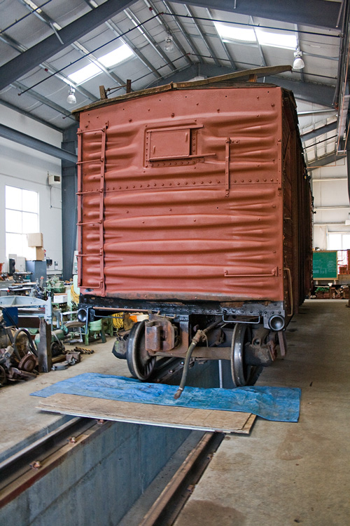

PostPosted: Thu Mar 19, 2009 3:31 pm
Posts: 157
Usually the lumber door is on the "A" end but I guess it would be possible to have it on the "B" end as well. I have included a photo of the lumber door on NP 14794, a single sheathed boxcar built by the Northern Pacific in 1932.
Richard
PostPosted: Fri Mar 20, 2009 8:34 am
Thanks again.
Jim Baker, PSRM
That's because the use of this door is misunderstood. It's not used to put the sticks into the car, it's used to poke the end of long lengths out so the other end will clear the door post, kind of like poking the ends out the window on a stairway landing when carrying long lengths up to the second floor. If the car only had a lumber door in one end, the loading crew just had to load toward that end.
Remember, back in the days when boxcars were only 36' long, lumber was commonly available in 22' and 24' lengths, and those lengths were required for two story buildings built with the "balloon framing" common in those days.
PostPosted: Fri Mar 20, 2009 10:29 am
Posts: 269
Dennis: Your explanation as to how the cars were loaded makes perfect sense. Thanks a lot.
Jim Baker
PostPosted: Fri Mar 20, 2009 3:12 pm
Richard
Richard -
Care to tell us where NP #14794 is located? Looks like it is in a shop building for restoration purposes.
PostPosted: Sun Mar 22, 2009 3:03 pm
Joined: Sun Oct 30, 2005 12:15 am
Posts: 170
The NP boxcar is located inside the Conservation and Restoration Center in Snoqualmie, WA. Here is a brief overview: http://www.trainmuseum.org/RHC_CRC.asp
