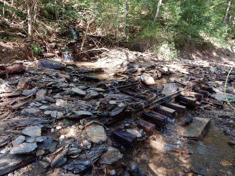

File comment: This track crosses a concrete box culvert which is plugged and completely covered with tons of rock washed down the tributary stream. The downstream channel is totally filled with rock and debris.

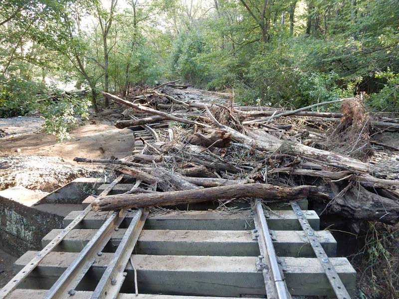

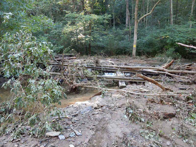

File comment: Debris deposited on the deck of the 13 foot B-3 bridge. The bridge was undamaged but the flood diverted the stream through the roadbed north of the bridge washing out the track.

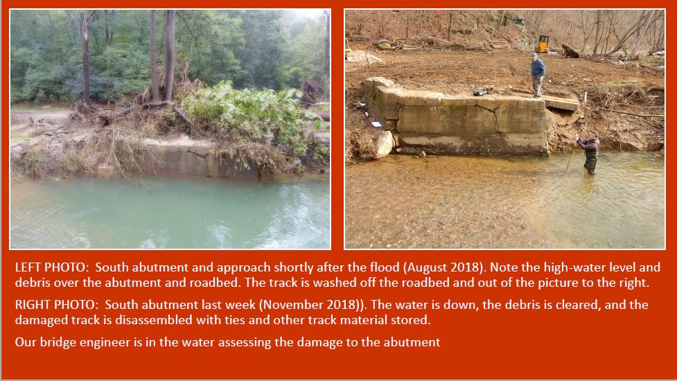

With all due respect, to call this a repost is a complete mischaracterization.
None of the information about our recovery efforts, the work now in progress, and the expected cost of track repairs has appeared in RyPN previously.

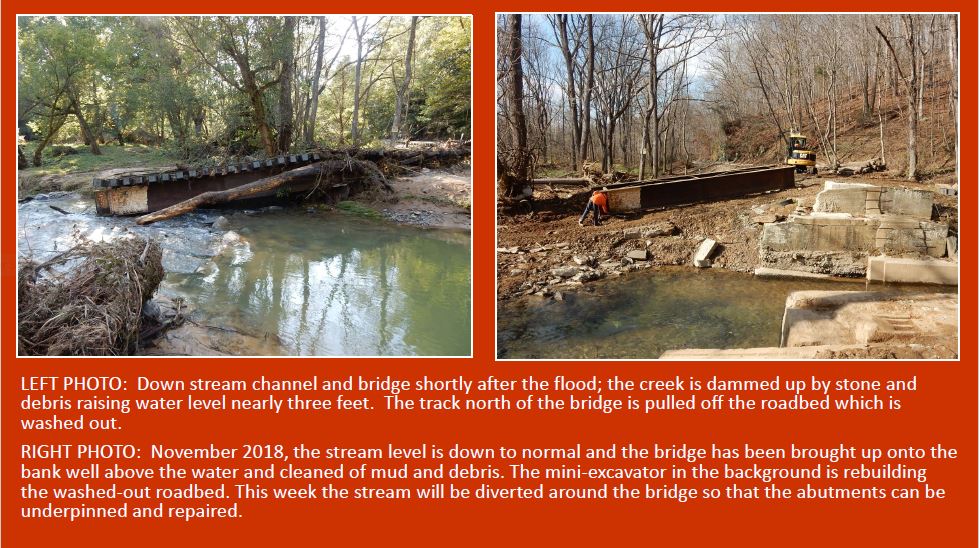

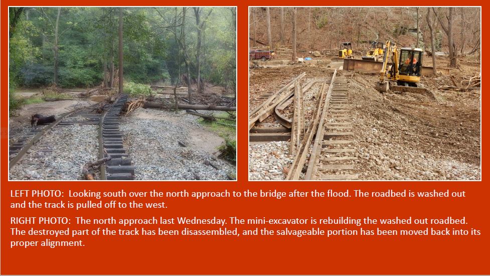

Perhaps linking to our Facebook page for the progress pictures was not a wise choice. For easier access I will copy below our yesterday's Facebook post that has new pictures of the recovery work in progress.
Craig Sansonetti

Count me impressed, when I first saw the photos of the girder bridge washed up on the shore I thought it was a lost cause for a small all-volunteer group, you have done well already.

I visited Muddy Creek Forks last Friday, including the site of the bridge that was washed off its abutments. The power of the water roaring down through the ravine must have been astounding! One wing wall of the bridge was lifted and carried more than 100 feet downstream and deposited on the opposite bank of Muddy Creek itself! I saw a photo of this unnamed stream pre-flood, and it was a mere trickle about a foot wide. Ever since the flood, I was told, the stream has continued to run high and strong, presumably due to almost continuous rain events.

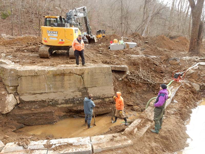

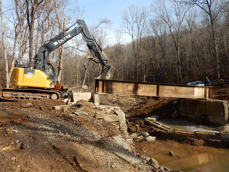

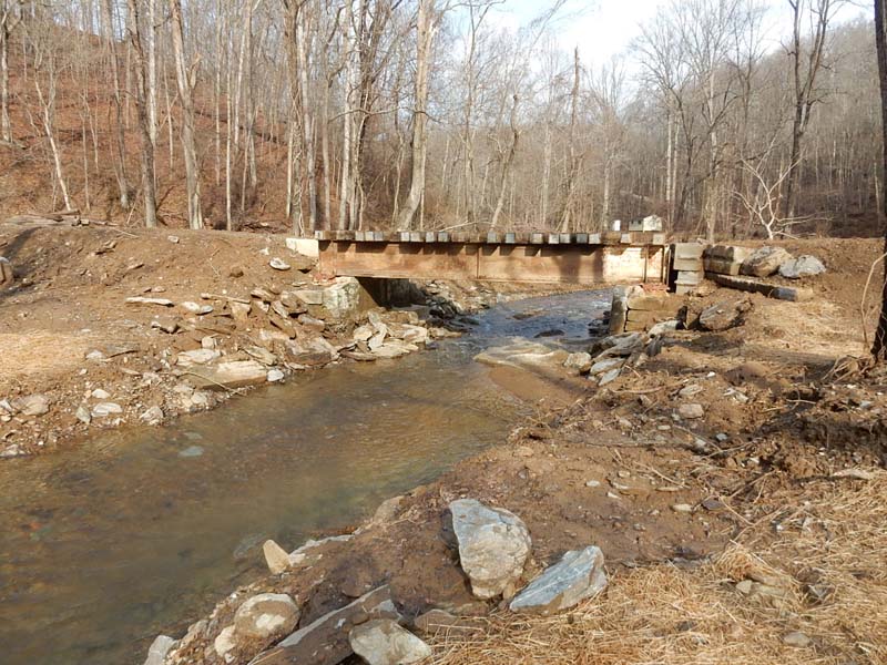

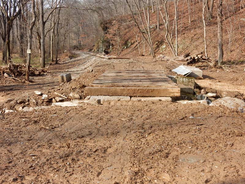

A lot of progress has been made at the site of the most serious damage where a 30 foot plate girder bridge was washed into the creek and the abutments were seriously damaged. After cleaning up debris, the tributary stream was diverted and 16 yards of concrete were poured to underpin and jacket the base of the south abutment. The bridge span was retrieved from the creek, cleaned up, and found to be undamaged. Our contractor, John Nolan, was very resourceful in replacing the bridge on the abutments using only log rollers, tie plates as skids, and the large excavator he had already on site saving about $10,000 on the quoted cost of bringing in a crane.
The bridge is now in place and secured to the abutments, the north and south approaches have been regraded, the stream is again flowing freely under the bridge, stone has been placed to armor the stream banks, and the bridge timbers have been placed on the bridge.
Since the remaining work at this site does not require a permit, Nolan will begin next week to work north from High Rock on the repairs required at our four other damage sites. Relaying of the track will be deferred until spring.
There is also good news on the permit front. The Society has requested and received an extension of our Emergency Permit from the Pennsylvania Department of Environmental Protection. With the extension to March 1, we expect that all work requiring a permit for work along Muddy Creek and the tributary streams will be completed barring unusually severe winter weather.

File comment: In addition to diverting the tributary stream a cofferdam was needed to excavate the south abutment since its base was lower than the water level in Muddy Creek. Concrete was poured to underpin and jacket the base of the abutment to guard against future floods.

File comment: By devising a plan to replace the bridge on its abutments using only the large excavator already on site, John Nolan saved about $10,000 in costs to the Society.

File comment: The roadbed both north and south of the bridge has been rebuilt and timbers placed on the bridge.
File comment: The bridge is now secured to the abutments, all of the streambank work is complete, and the approaches have been rebuilt.
