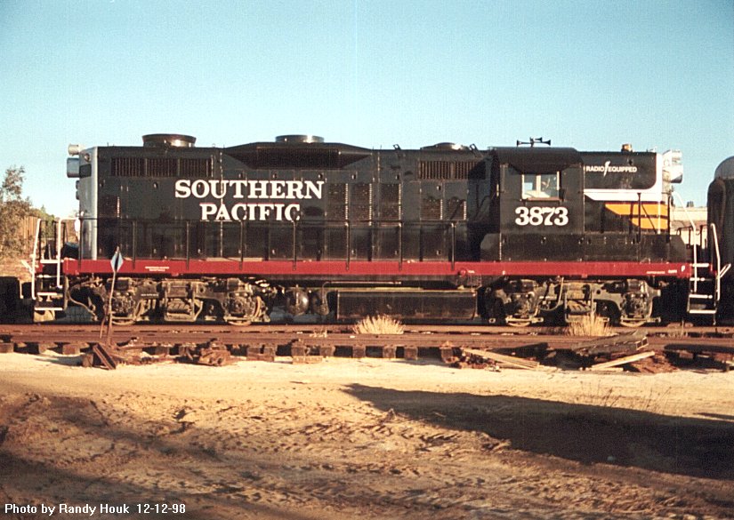

Running this weekend from Campo to Tecate, BC, Mexico.
