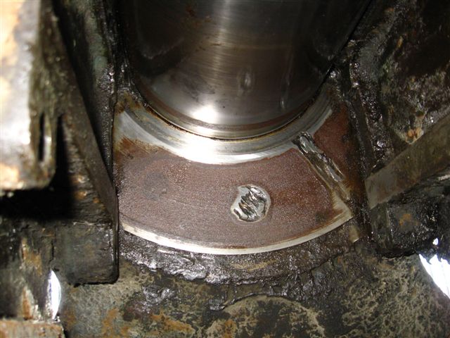

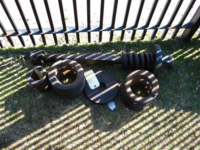

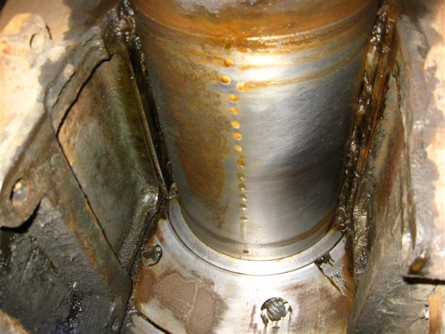

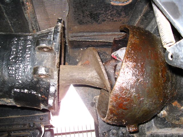

Last Saturday we dissasembled the Radial Buffer, removed all the Barco flexible joints, and pulled out one of the drawbar pins. We also examined the condition of the journals on the tender trucks, and have begun on the driver journals.

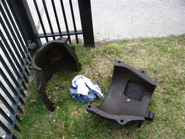

Today we opened up the rear bowl on the stoker conveyor, but we couldn't get any of the bolts out of the unviersal joints. We torched off the heads of the bolts on one of the joints, but its totally seized in place. We tried heating the area up with a torch and then tried to knock it out, but nothing. 6213 has been so well looked after over the last 25 years that I was able to climb into the stoker compartment, and using a pipe wrench on the universal joint, I was able to turn the stoker screw by hand!

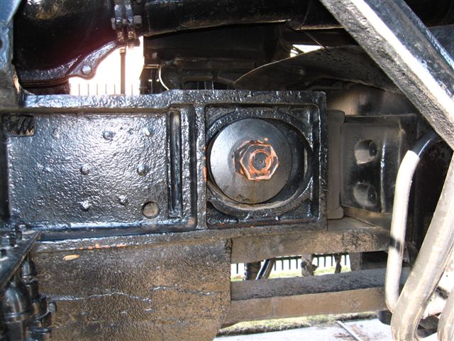

File comment: The journal on one of the driving wheels.

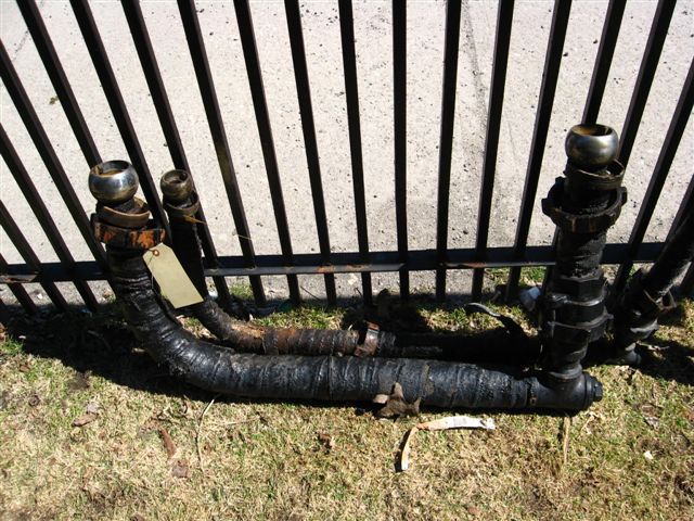

File comment: The Steam Heat line and the Stoker Engine Steam Supply
File comment: The Springs, Washers, and pin that compress the wedges in the Radial Buffer

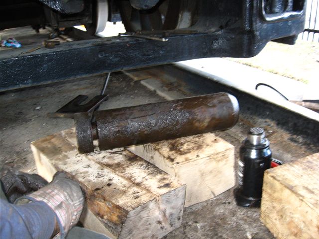

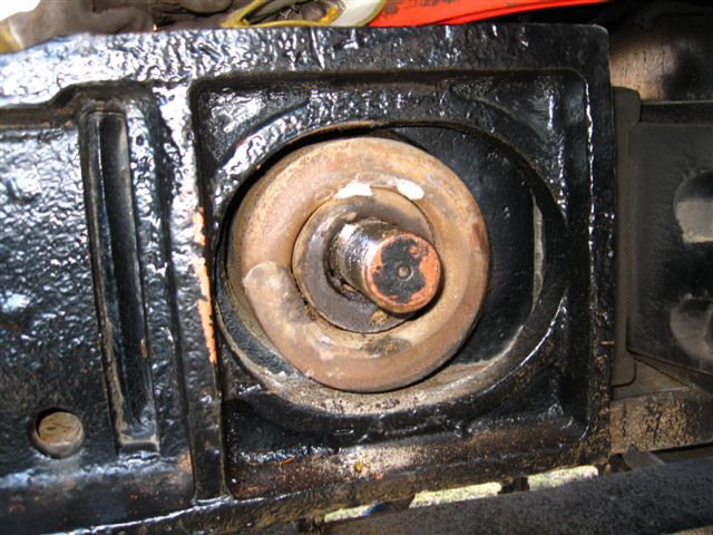

File comment: The Front drawbar pin (the one in the tender was seized in place).

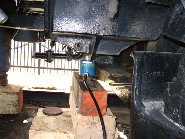

File comment: Working one of the drawbar pins out using a 50 ton jack.

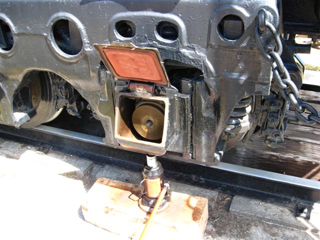

File comment: Jacking up the tender journal box so we could remove the wedge and lift up the brass to inspect. Some of journal boxes were seized in the pedestal, so in some cases we ended up lifting the the whole truck. The first movements of any sort in almost 50 years...

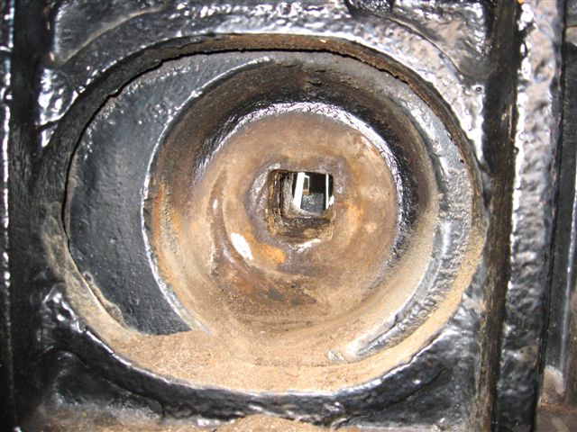

File comment: The rear bowl on the stoker conveyor. You can just see the universal joint on the right.
File comment: The two halves of the rear bowl on the stoker conyeror.
File comment: Another Journal.

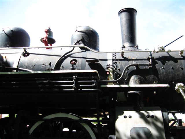

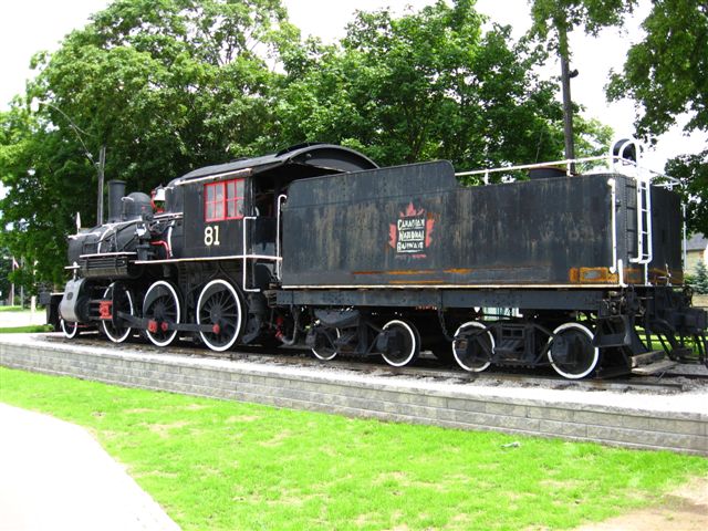

Well, I visted the 81 last August and she looked pretty wrecked to me. It appears that some one has been doing something to it lately - some landscaping for example. It seems to be completely unprotected from anything.
That's the old look. It has been restored since. I found a more recent picture of it on the web a three or four months ago, but can I find it now? NO! :P
