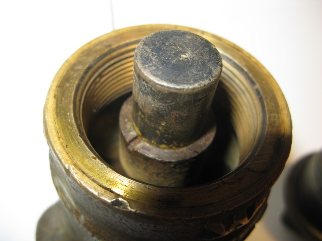

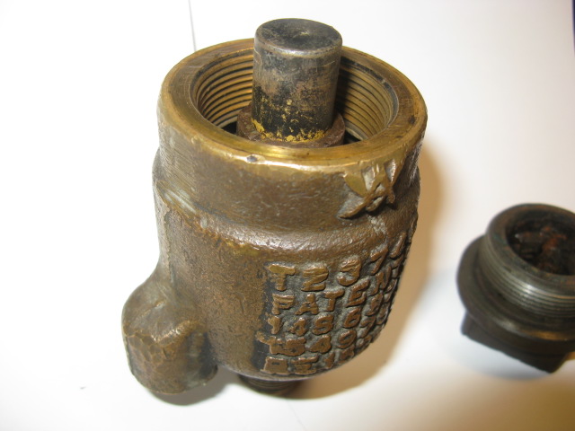

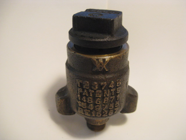

I imagine that many will recognize the item in the attached pictures as a Westinghouse B-3 oil cup. We need two of these for a compressor that we're overhauling and, although I do realize that they can be bought from Backshop Enterprises, this isn't an option for us. Quite apart from the question of whether something that consists of just four quite straightforward parts (including the cap) can really be worth USD1,463.12 (each), this kind of money isn't in our budget.
So thoughts have turned to a DIY solution. We do have two body castings that a member of our group made for an unrelated project some time ago, so if we can get the functional parts right we'll have cups that not only work but also look right.
Does anybody have any experience with the innards of these cups? I do have a diagram in a Westinghouse booklet and understand the principle of operation. And I've also the cup shown in the pictures. It's required elsewhere and is therefore not available, but it does allow for some reverse engineering.
My key questions at this point are
1/. Is the stem a force fit in the body or is it screwed into the body? I suspect the former but am reluctant to try forcing the stem out (from the bottom) until I've confirmed this.
2/. Just how wide is the annular opening between the stem and the sleeve that is pressed onto it? This dimension appears to be the "magic ingredient" of the whole design (and the precision required the only thing that, IMHO, could possibly justify the price).
