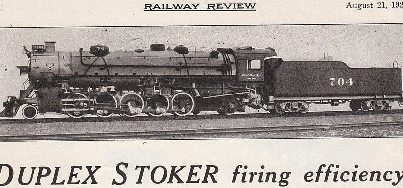

Pic of C of GA 704
File comment: That tender sure looks familiar...

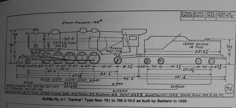

Here is a drawing and details for the Central's J-1 2-10-2's 701 to 709. I located it in Richard Prince's book "The Central of Georgia". The J-1s were built by Baldwin in 1926. All equiped with Duplex Stokers (HT's later applied to 702, 703, and 706) Tender capasities were 16 tons and 12,000 gallons. They served the hilly line from Columbus to Birmigham, and were all retired by 1953. I would assume that the one that found its way on to 4501 either got traded to a another loco for a short period or went directly into MOW service - quite possibly on a MOW unit based in Birmingham. I'm curious if Bill Purdee found it in Norris Yard and thus the tender began its new career. Now which loco did it come from, well you have an eleven percent chance of guessing the correct one.
File comment: J1 2-10-2 drawing
