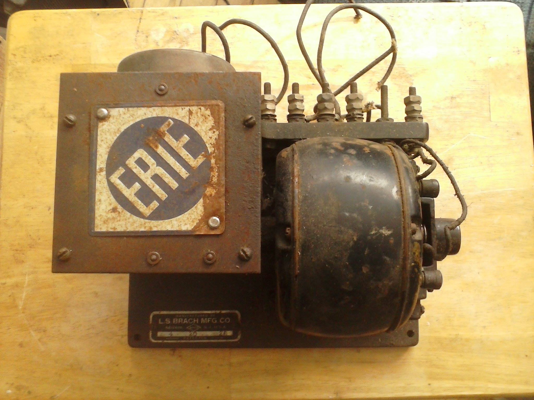

Another long lost company is Brach. I have this odd little lighting sequencer made by Brach which runs on a motor and seems to be something of a "chasing" sequence mechanisim. very cool, very old, and fully functional, although I have yet to figure out where in the field it would have been used for. There doesn;t seem to be much literature on the comapny anywhere that I have found, so it remains a mystery.

Thanks for the information about Hall Signals on the old D&H. I can tell you what that Brach device is that you have :
It was made for the Boston & Maine's DW style Wig Wag signals that were built by US&S. Your guess as to it's function is correct; it fired off a series of CHASE LIGHTS that were mounted in sets of twelve, six on one side and six on the other. What is really interesting is that some of the CHASE LIGHTS were made by Brach, and some by Dressel !
Check out the B&M style DW wig wag at Conway Scenic RR.
Kevin K

I always imagined that the lights at North Conway on the old wigwag were indeed the type of lights that this thing would have lit, but those lights seem to be connected to some kind of contacts on the banner itself, as the lights are in unison to the motion of the swinging banner.
Were there different wiring styles with the different light manufacturers?

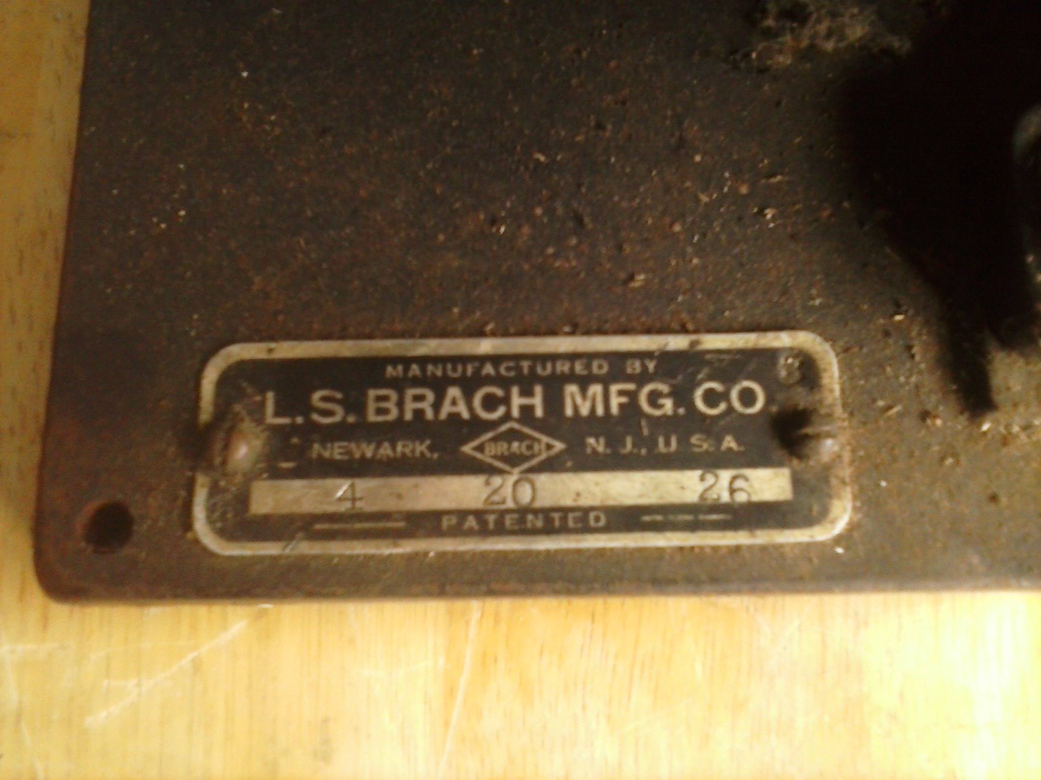

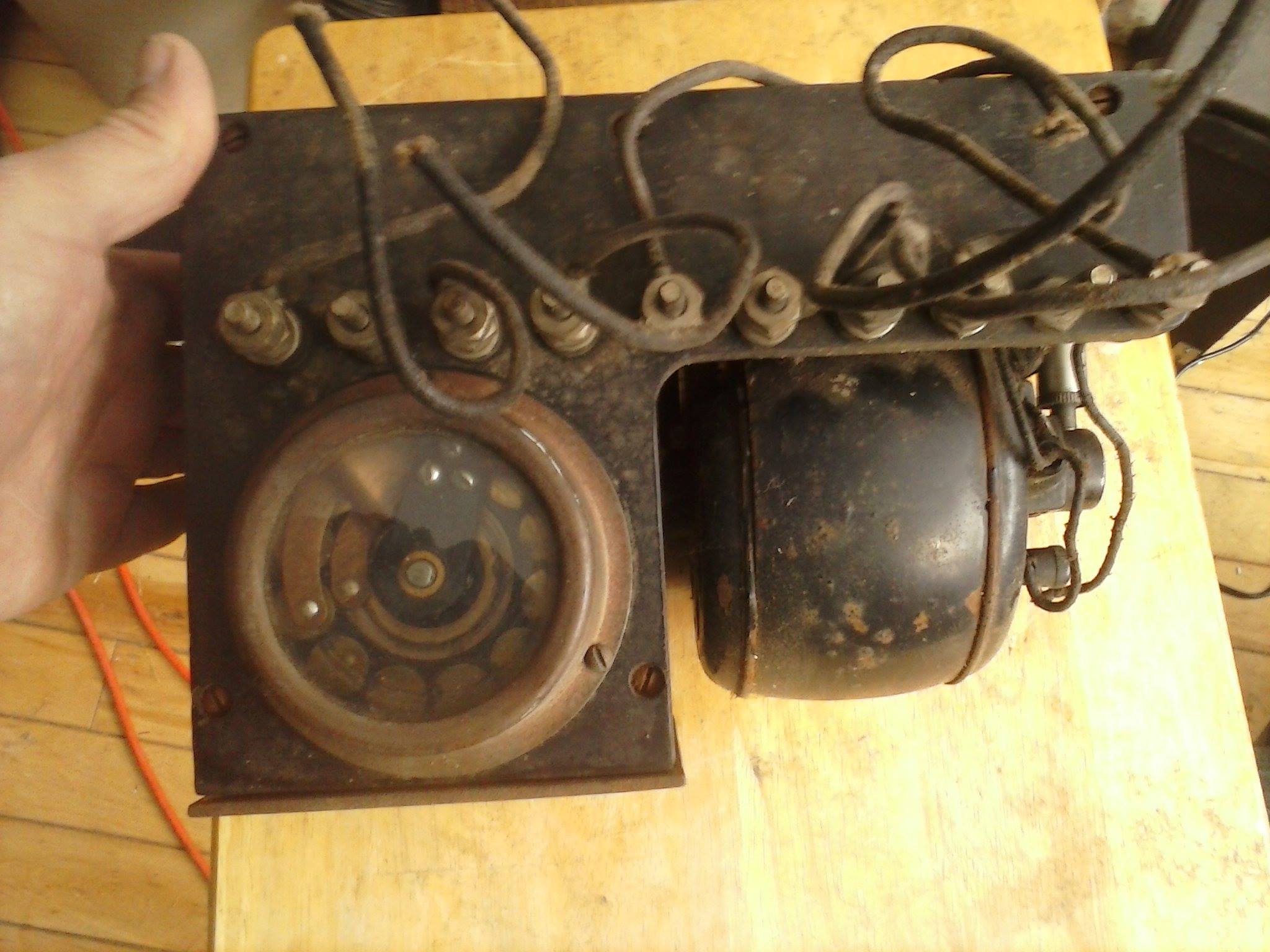

Bringing this back to life after a few years as I finally got around awhile ago to take pics of the sequencer unit that I had originally mentioned. I ended up finding what I believe is the patent for the full original installation and I figured that others here would find it of interest.
The patent:
https://www.google.com/patents/US1232888?dq=ininventor%3A%22Leon%20S%20Brach%22&hl=en&sa=X&ei=63r1VP_wLKq1sATZmYDQDw&ved=0CFQQ6AEwCDgK
10847356_10206302195012509_2429067980987790985_o.jpg [ 261.37 KiB | Viewed 7998 times ]
10269118_10206302190892406_3339889812713143829_o.jpg [ 284.38 KiB | Viewed 7998 times ]
1556364_10206302196012534_8164594257806749483_o.jpg [ 209.04 KiB | Viewed 7998 times ]
