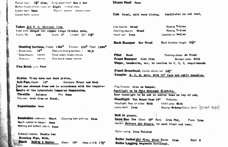

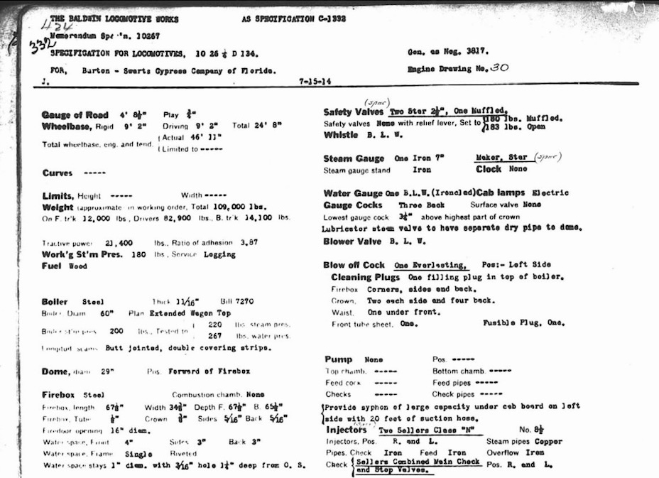

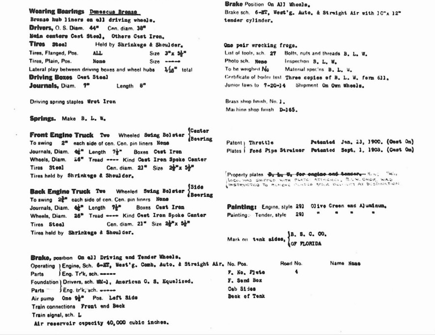

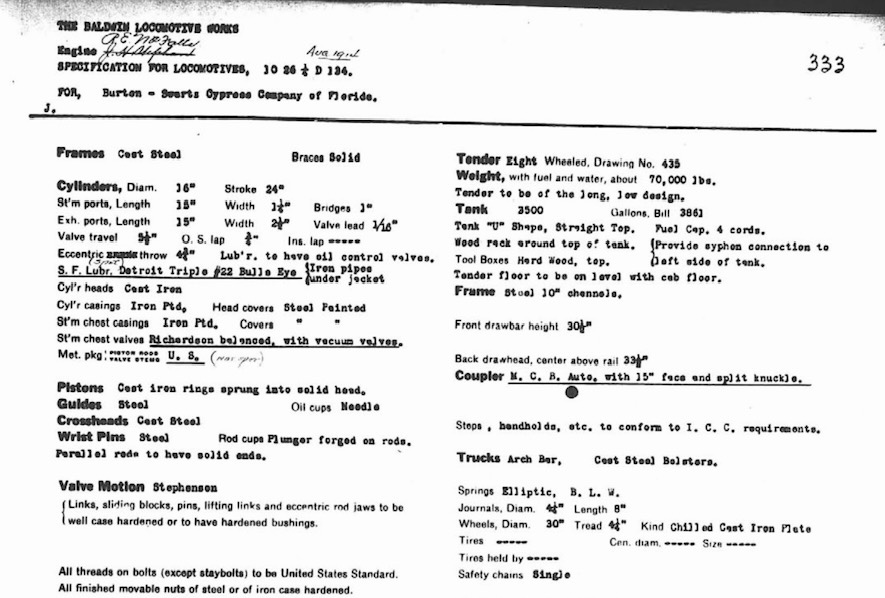

For anyone interested here are the
Baldwin "vitals" from 1914 for this locomotive:
Again, because of that "..." 1000 pixel limit here I have to cut the 2 pages into 4...
