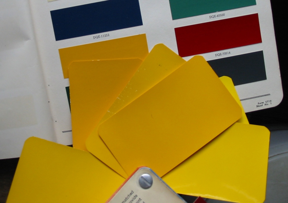

The Ditzler chip shows slightly richer in this photo due to a less glossy finish but it does match the fan deck if I look at it with my right eye instead of my left, or is it the other way around?... LOL

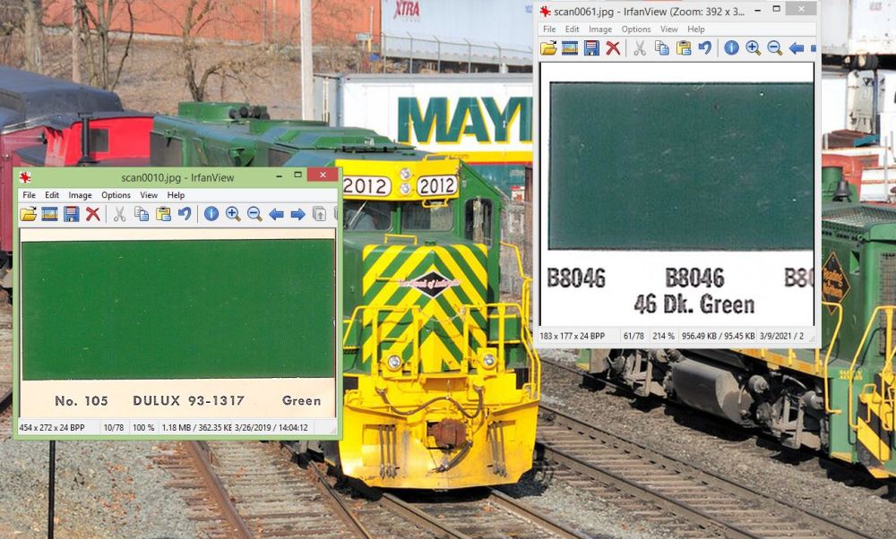

I've got a new problem with the Mayflower colors. Apparently, at some point, they had changed to B8046 Green and 54701 Yellow so I'm going to have to go back and redo that RBMN/Mayflower comparison...
http://paintref.com/cgi-bin/colorcodedi ... nd+Storage
B8046 is one of the General Motors Woodland Green codes which became a big green fleet color in later years...
http://paintref.com/cgi-bin/paintdetail ... pont=B8046
I'm thinking that might put 1317 on the RBMN instead of 5316 since the Mayflower reference color will be a bit darker. The yellows weren't that far apart which did mystify me a bit earlier but now it doesn't.
That's right, I already have B8046 scanned so I'll do it post haste.
And there you have it...

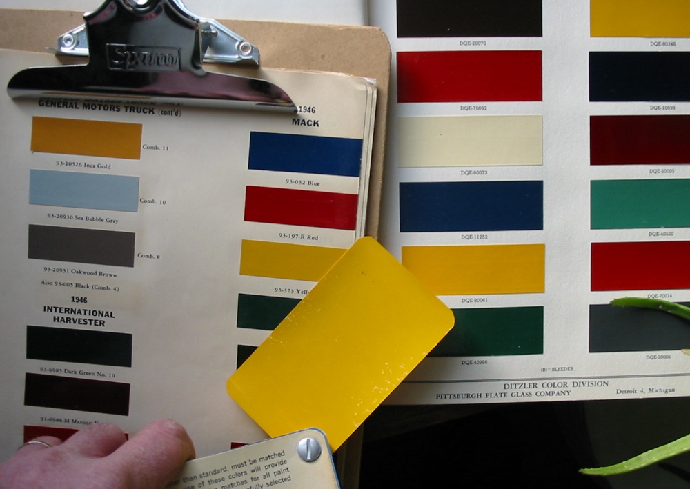

Back to Ditzler/PPG 80061 Yellow...
Tucked away at the beginning of the yellows in the fan deck is GM WE5930. For some reason, this color is segregated from the rest so I'm thinking it's actually one of the national school bus yellows. I do have some of those chips handy so I'll look for further matchups and numbers. The Martin-Senour code in their catalog is 3857.
http://paintref.com/cgi-bin/paintdetail ... ode=WE5930
WE5930 is the exact match for 80061, Stan. It was hiding from me the other day so I apologize for that oversight on my part. To the right are WE5910 ( DuPont 373), WE5909 (DuPont 6808), WE5919 (DuPont 5248), and WE5918 (DuPont 54701)...

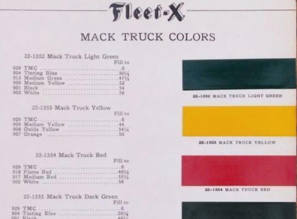

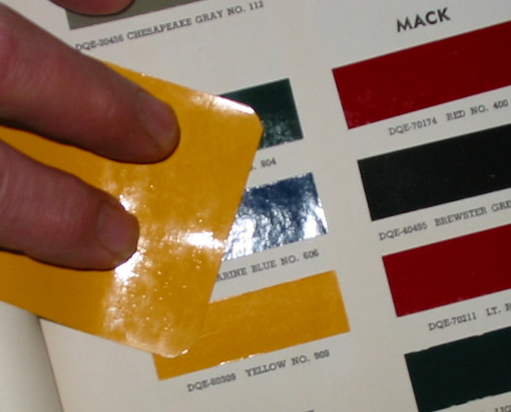

Here it is, Eric, 1947-1954 Mack Truck Yellow, Ditzler/PPG 80309, which is also listed for the NYC...
http://paintref.com/cgi-bin/colorcodedi ... ame=Yellow
The DuPont Bulletin 11 doesn't have this color...

This is a photo of a 1949-50 Acme sheet on eBay. I saw an old Rodgers sheet there as well. Mack Truck Yellow is not the same color as the more common Mack yellow, Kiltie Yellow, 93-24067, which is shown in Bulletin 11. Still no luck finding a DuPont number for this one, however, but I'll keep looking for later matches...

Okay, here's where it gets messy with the 1967 DuPont fleet catalog. The best match for WE5930 appears to be 93-74035 but the slightly darker 93-75306 is indeed National School Bus Yellow. 93-74085 is a bit darker than WE5930 as well. I think I've had about enough of this for the day. LOL

Upon further review last evening under intense artificial light, all three of those 1967 DuPont colors turn out to be darker than WE5930. The best matches continue to be Ditzler/PPG 80061 and 80309.
Unfortunately, I can't compare the 80061 and 80309 chips directly since they're on different pages of the catalog so, for now, I'll have to settle on using the WE5930 card as an intermediary.

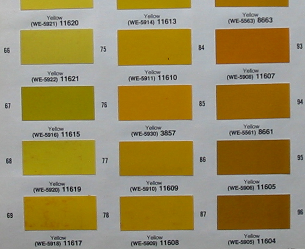

WE5930 does separate itself from the other similar yellows on the MS sheet quite nicely but this color is becoming almost as baffling as 80061 itself...
