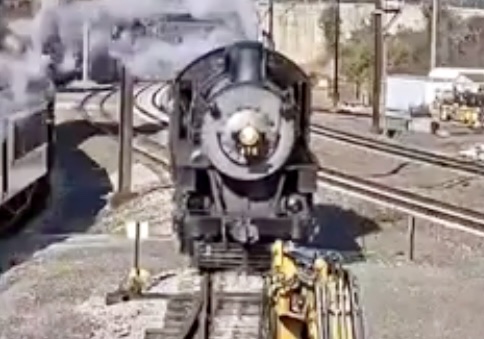

I wonder if the crew was in the practice of calling the switch positions when approaching them? When I was with TVRM, the practice was to call the position of each switch as the train approached it. The switch was either in the right position for the move or the wrong position. In all the years I was there, I can only recall one incident where a switch was run through-the Road Foreman of Engines inadvertently went through a switch lined against his move and derailed the pilot truck of the locomotive. That incident served as a reminder to always check the position of the switch.

To respond to anything relating to any special bulletins or notifications relating to the excavator being placed on that spur, I would note that a check of Google Earth shows the flatcar into which the locomotive pushed the excavator sitting in the spur at least since mid-August, the date of the most recent GE imagery. If the railroad has been issuing daily track bulletins or the like noting such occupancies, I doubt the addition of the excavator would have triggered anything new at least on the paperwork end as the spur has been occupied by m/w equipment for at least three or so months.

I’ll also add the switch stand is very clearly on the engineer’s side of the locomotive. I’m not sure how anyone who has watched the video could be remotely confused about that.

We can see the nature of the mistakes made here, and use it as a potential MAJOR "teaching moment" or warning of "THIS could happen to YOU!!!", and we normally have in this forum a dearth of the utterly useless reactionary commentary such as usually found on YouTube, Facebook, VirtualRailfan chat, etc.
In a sense, I would compare it to the differences between watching a live TV news reporter's report on an accident, a newspaper report the next day, and a final NTSB or emergency-management agency report on the incident. True, we have to wait ages for the latter, but I already chatted with one magazine editor on prospective coverage--"We just put the next issue to bed the day before, and given this is Strasburg they'll have it fixed before we put together the next issue......"

For all it is worth, coming from a retired FRA Inspector/Investigator (not much), I refuse to speculate on fault or cause without having all the facts. Even though I have some thoughts, based on what I (and a million others) have seen on the various videos, I will not, or ever draw any conclusions regarding fault or cause without all the facts and relevant information. This would include:
• Crew and Employee Interviews
• Reviewing Railroad Operating, Safety, MOW Rules, Special Instructions, Track Bulletins, etc.
• Clarification of main vs. other than main track for this location
• Reviewing employee history and post-accident tests as applicable
• Reviewing railroad training and operational testing programs
• Reviewing railroad operational testing data
• Other relevant information
I no longer work for FRA, and I am not privy to any of these or other pertinent data regarding this incident. In my world, it would be irresponsible to speculate without investigating thoroughly. Historically, railroads, and others were quick to find “blame” without really drilling down to the “root cause” of the incident. In many accident investigations that I have worked, sometimes there is more than what we see on the surface. I am sure there are lessons to be learned resulting from this incident, but I won’t guess as to what they might be without having all the facts.
I do not know, but have no reason to believe that this incident would be investigated by FRA as there were no injuries (that I know of) and similar incidents happen on railroads all over the country all the time.
