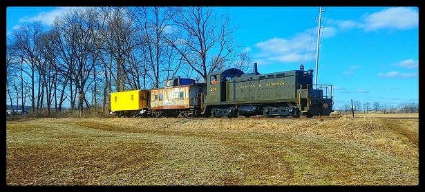

Just read that PRR 492406 has been moved to the Allentown & Auburn Railroad where she was seen moving in a train over the railroad! Amazing restoration thus far considering her condition when the project was started and where she was described as "looking like a bonfire waiting for a match..."! Really looking forward to the next step and her completion.
 Post subject: Re: PRR N6b on ebay
PostPosted: Mon Feb 28, 2022 12:24 pm
Posts: 728
Location: Wall, NJ

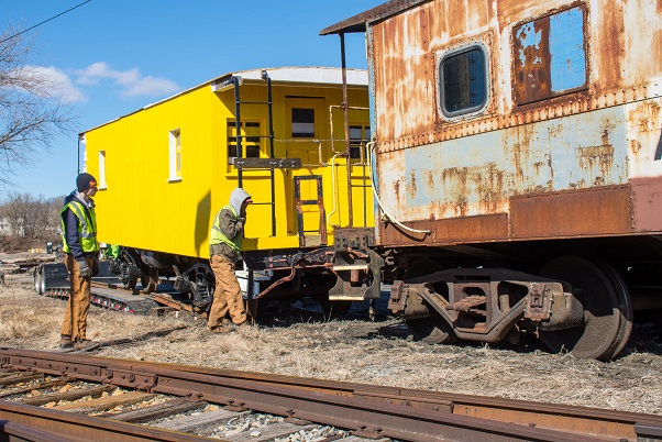

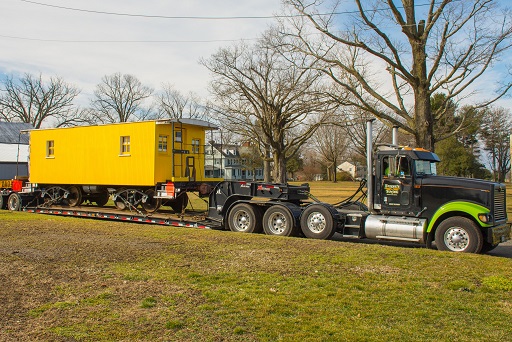

You beat me to it! Yes, we are very happy to announce that our PRR 492406 was moved over the weekend from Columbus, NJ, where we have been working on it for a number of years, to the Allentown & Auburn Railroad in Topton, PA. This will allow us access to a full shop and resources to complete the project, and allow the car to be used on revenue tourist trains and photo freights when complete. Saturday was the first time since the mid 1960s that this caboose has moved on live rail, and we are excited to begin this next chapter in the caboose’s history. Huge thank you to Dunne’s Towing and the A&A for making this all come together!
For a series of photos, without using Facebook, you can visit:
https://drive.google.com/drive/folders/ ... sp=sharing
Appreciate the support and positive thoughts from everyone,
J.R. May
