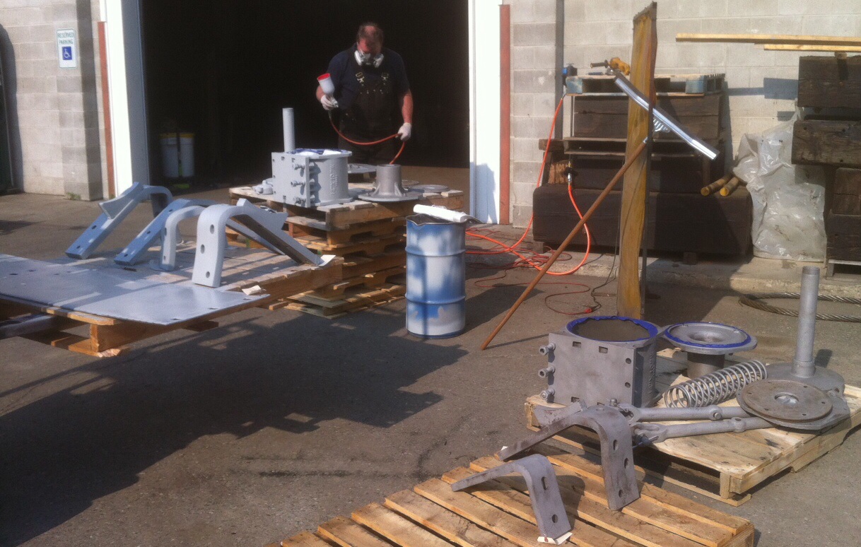

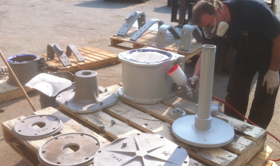

Thought folks might be interested in how we are doing on 557's progress. It's been a bit since we add to RYPN post.
Progress.... Lots.
Removal of the firebox is complete and the new sheets and crown are in the process of being manufactured. We have completed almost all of the work to remove the needed components in the boiler shell. Work has been accomplished to correct a defect found in the frame that Dick talked about earlier. The pump/compressor has been rebuilt and the reverser is being reassembled. Listening to the pump is music to the ears, and almost brings tears. Yea, sort of pathetic, but with all the blood ( yea, there was.) sweat and effort put in by the greatest bunch of volunteers in the state, she is very close to us. Many of the parts that have seen repair work and are ready to stand by for the reassembly are now sand blasted, sealed, and will be painted as needed for the reassembly work. The drivers are TVM getting turned and will soon be on their way home. Added are some in work photos to give a sense of where we are at.
File comment: Jeff on the parts...
File comment: I finished sandblasting, Jeff seals em!

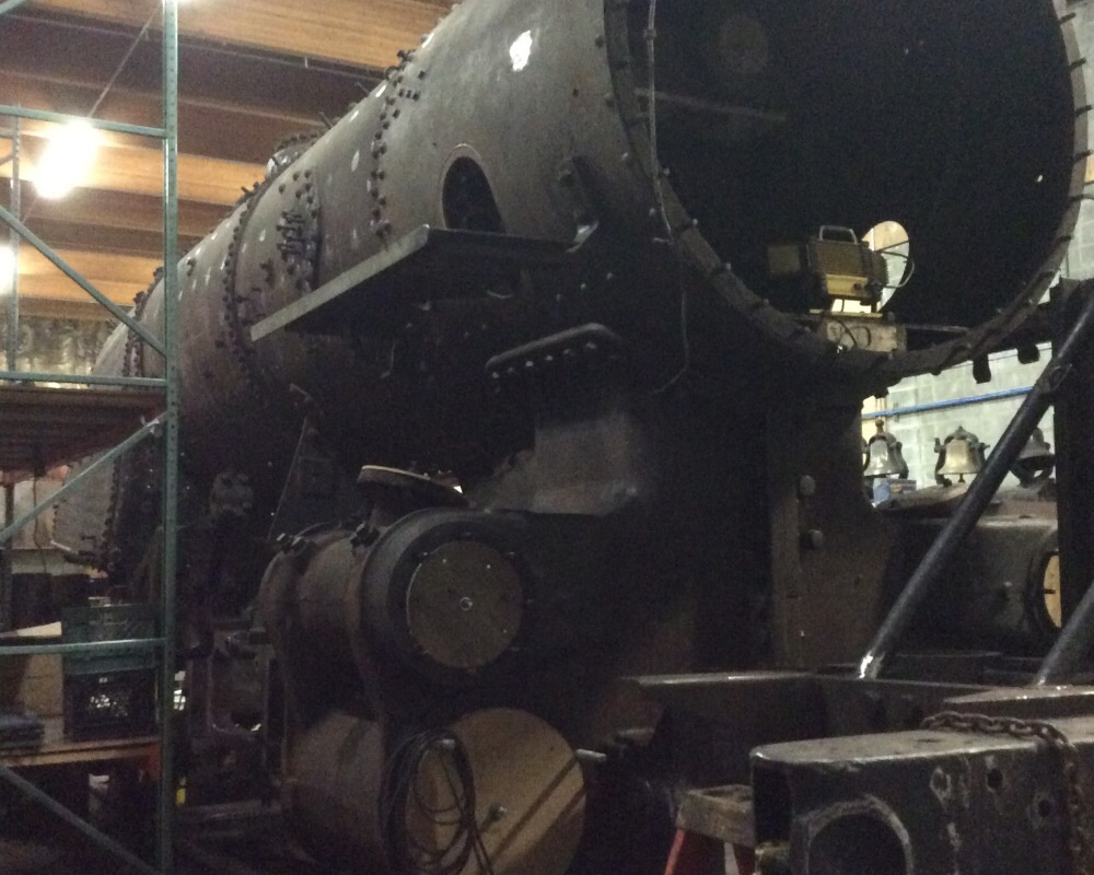

File comment: Gypse Rose showing her front end.

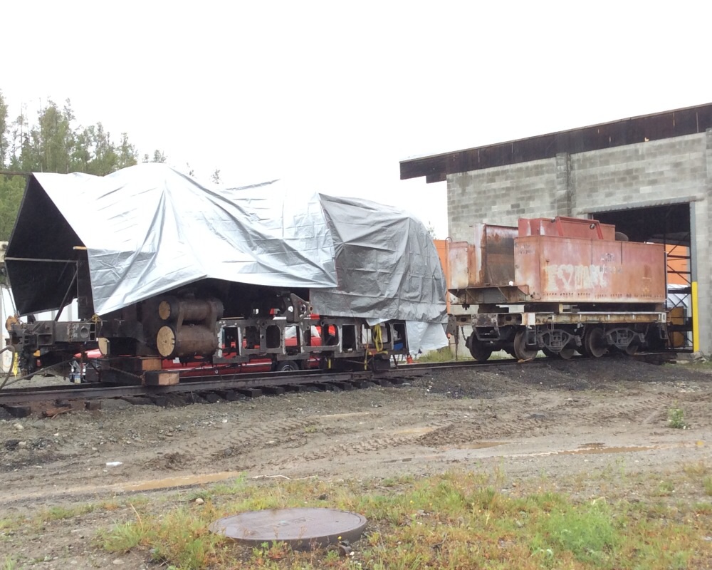

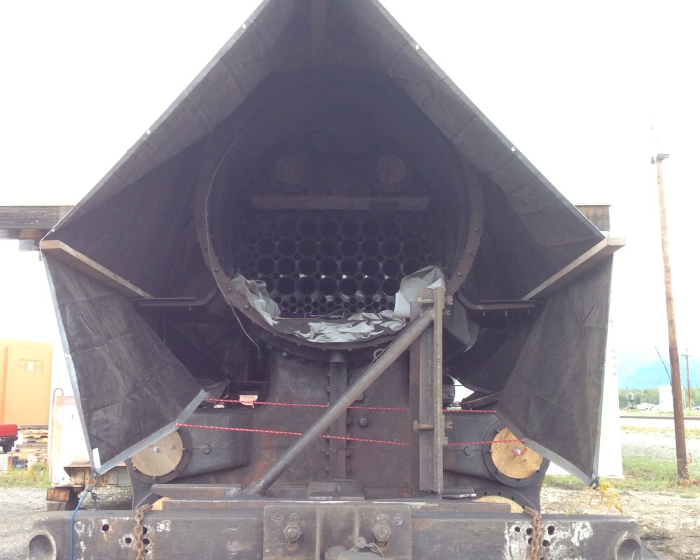

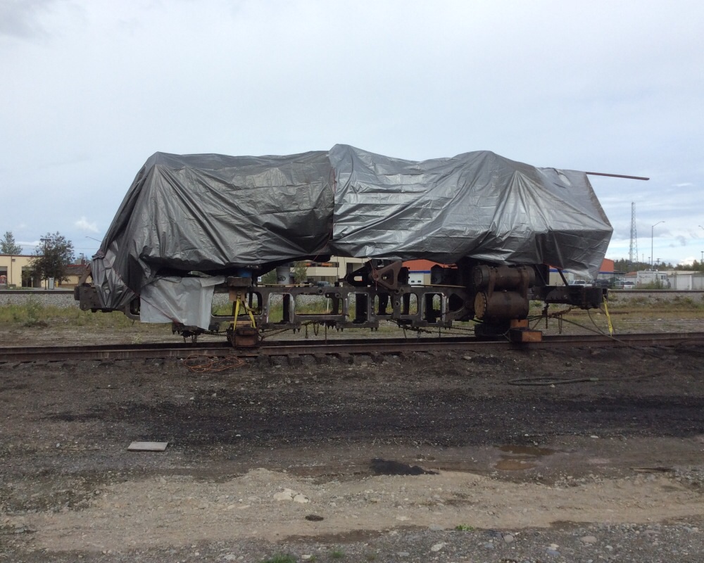

part 1 Saturdays update-
Just sharing another up date from the rainy land of the midnight sun.

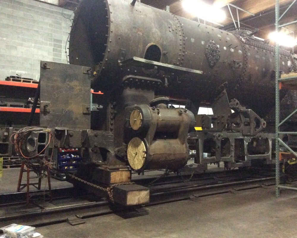

Work steadily continues on 557 as we finish up the final processes in deconstructing her, getting ready to begin reassembly. There was nothing but rain in the forecast for this last weekend, but we have a schedule we are striving to complete, so we find way.

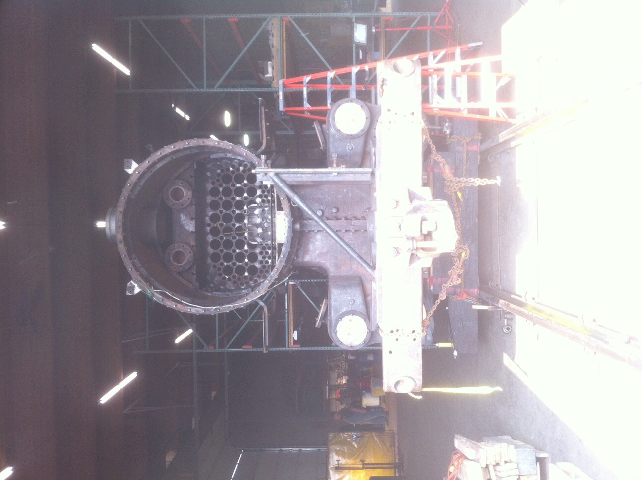

I've added a few pictures from Saturdays work after finishing the day. Was pretty exhausted from 9 hours of sandblasting the interior of the boiler, but you'll see we have pulled 557 out into the lead track to the shop. We prepped her before to continue working while the rain came down. The work sand blasting the interior boiler barrels for final inspection and repair where needed, and had to be accomplished. From all indications, the interior boiler looks good. Ultra sounding on the barrel has been very positive. The boiler interior barrel, the dry pipe, the anchors, the fire box are all getting completely cleaned and will get their final inspection soon. It took all day, and we managed to out last the weather. Or at least the crew did!

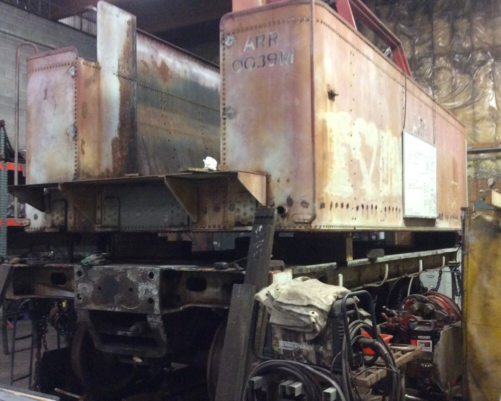

While the boiler/frame was out side the shop, we also moved the the tender out where we could remove the tank in preparations for it's complete stripping and rebuild.
It's hard to believe that 18 months ago we started with a loco shell and an empty warehouse. Now we almost look like and engine house.
File comment: Tender before we moved outside for some air...
File comment: Cylinders covered, front end details....
File comment: Saturday morning prep before we move her outside to do a little sandblasting...

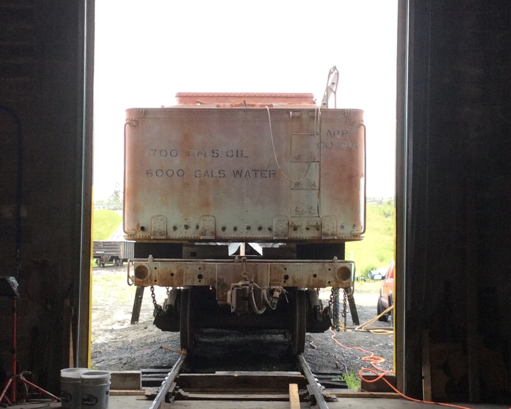

Part 2 Saturdays update.

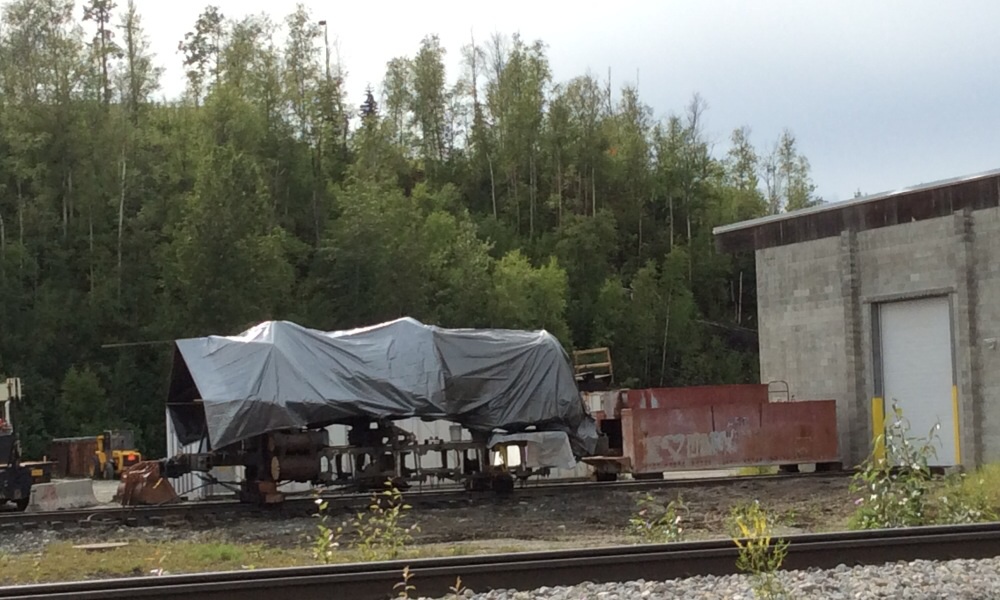

File comment: Frame/boiler in her wet weather gear...
File comment: First time the tender has been outside in 18 months...
File comment: We moved the boiler and tender out to do the sandblasting...

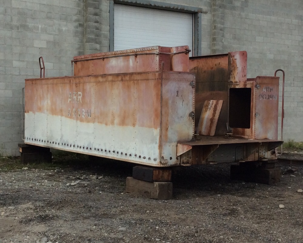

Part 3 of Saturdays update.
File comment: After a hard days work, a little rest for all of us.
File comment: Tank removed from tender....
File comment: Can't see me, but there is a lot of sandblasting going on it there....

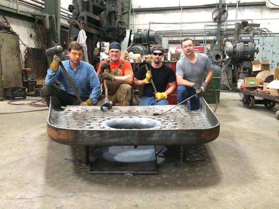

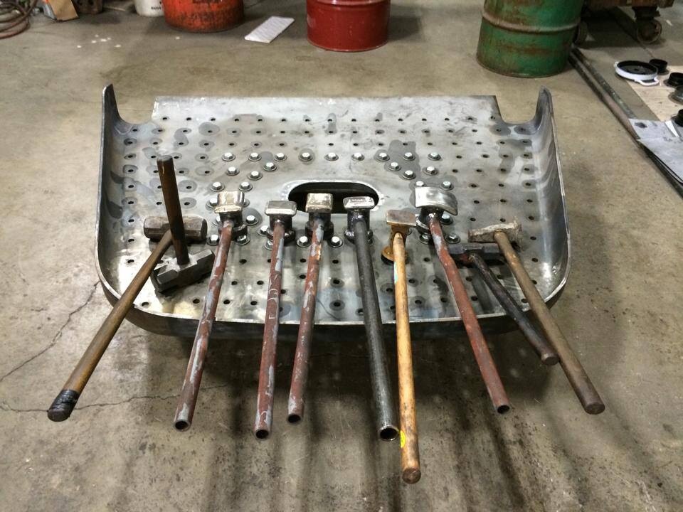

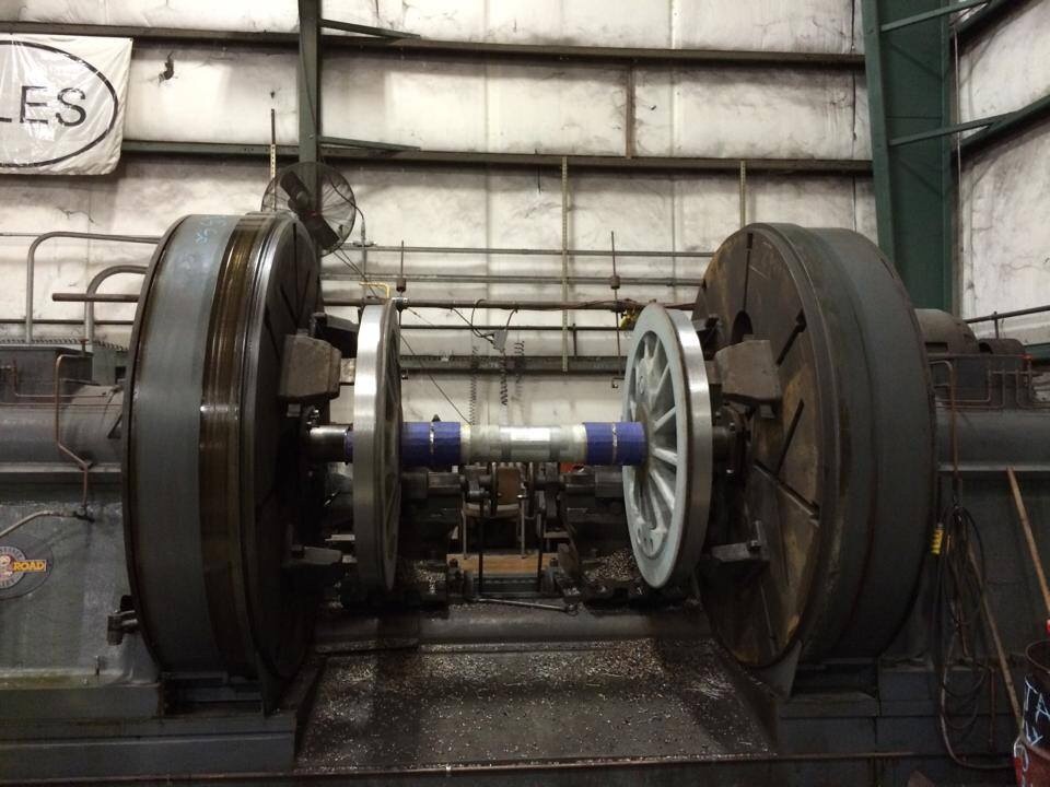

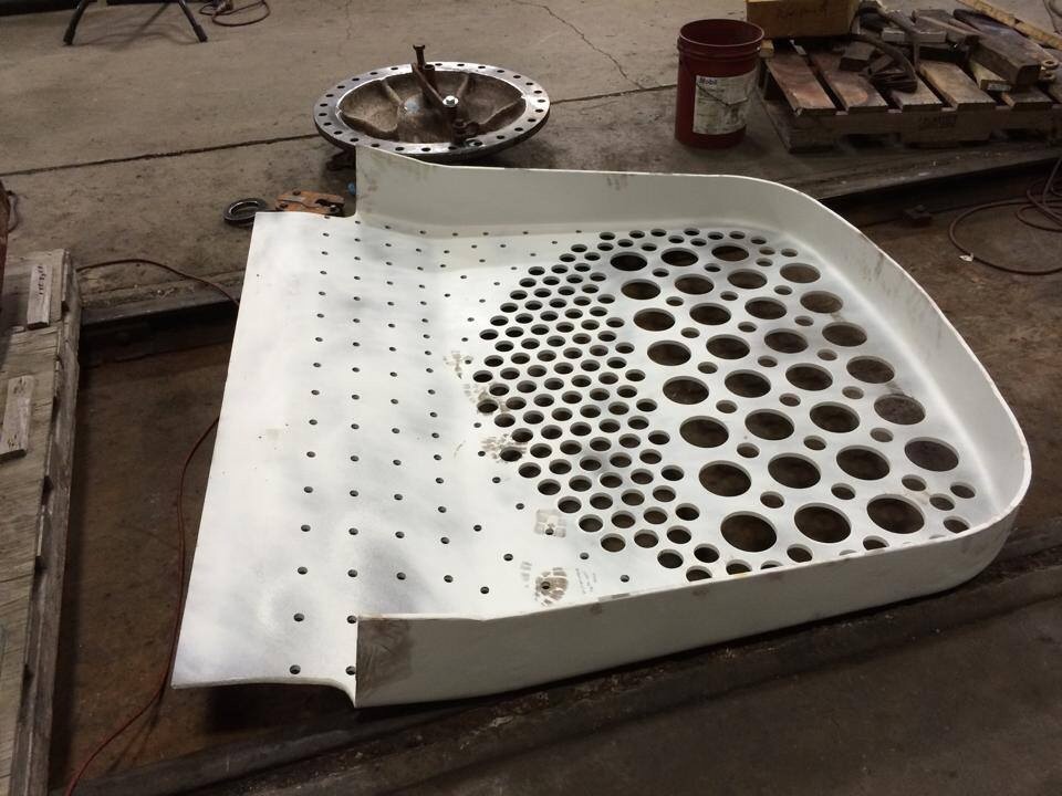

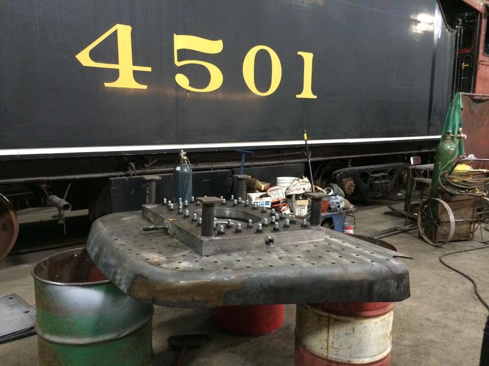

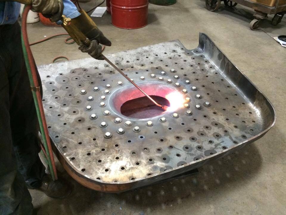

Received word from Robert's Steam Services of America that our drivers and fire box sheets are complete and ready to head back to Alaska. With Roberts permission I am sharing his photo's. Here are a few of the firebox sheets and the drivers... Making progress.
File comment: Good company.
File comment: The hammer crew!
File comment: Front firebox flue sheet...

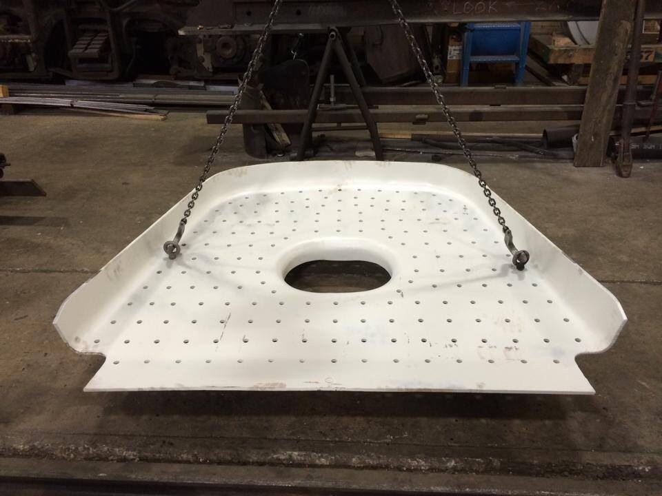

Some more...

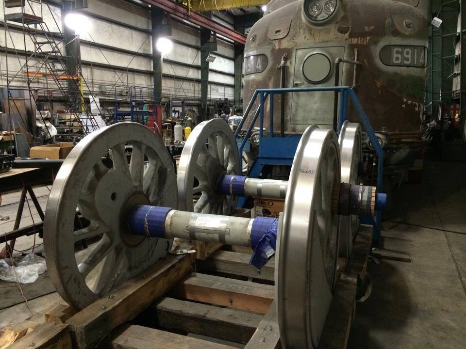

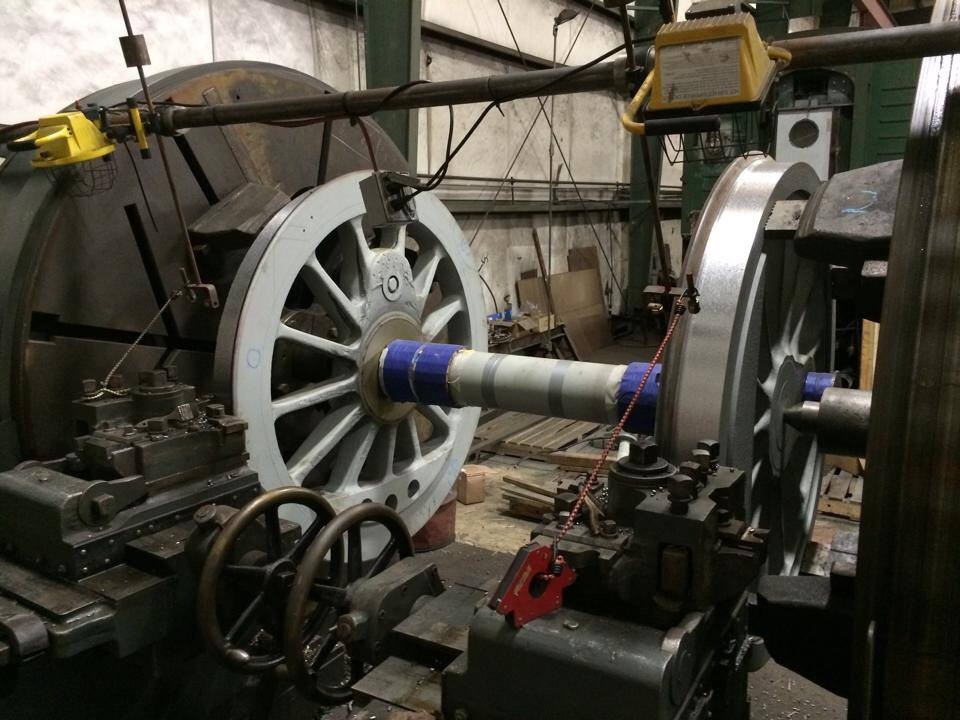

And drivers....
