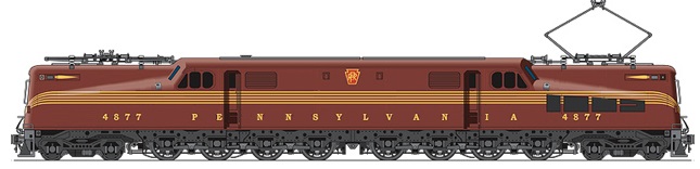

David H. Hamley wrote:
The mention above of the PRR's planned Harrisburg to Conway electrification brings to mind several Westinghouse/BLW proposals for the required motive power. One of the more interesting concepts from the historical standpoint was a 2-D+D-2 loco with the same carbody styling of the GG1. Short time rating of something like 7500 HP. No PRR class was shown, did PRR ever have a letter for the 4-8-0 type? Maybe a "UU-1?"
Something like this?:

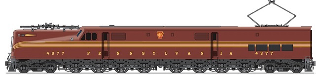

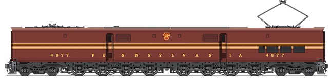

Or these?:

I thought the American Steam Syndycate had heating coils in the water. That would heve allowed it to be electric-steam locomotive.
I do not thik the PRR had Mastadon 4-8-0s but they did have the 4-8-2 M class. how about an M&M1?

The first image, with two cabs, was essentially what appeared in the 1944 Westinghouse Electric/BLW proposal. The accompanying text did not mention any other configurations, but did specify MU and oil fired boiler.
