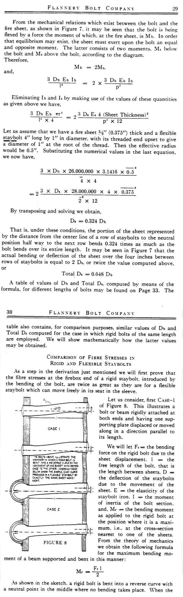

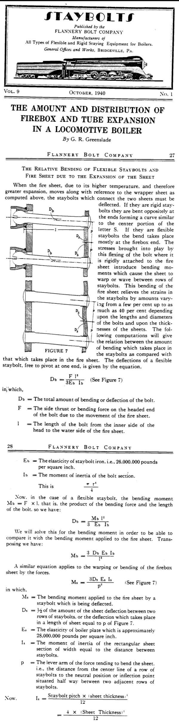

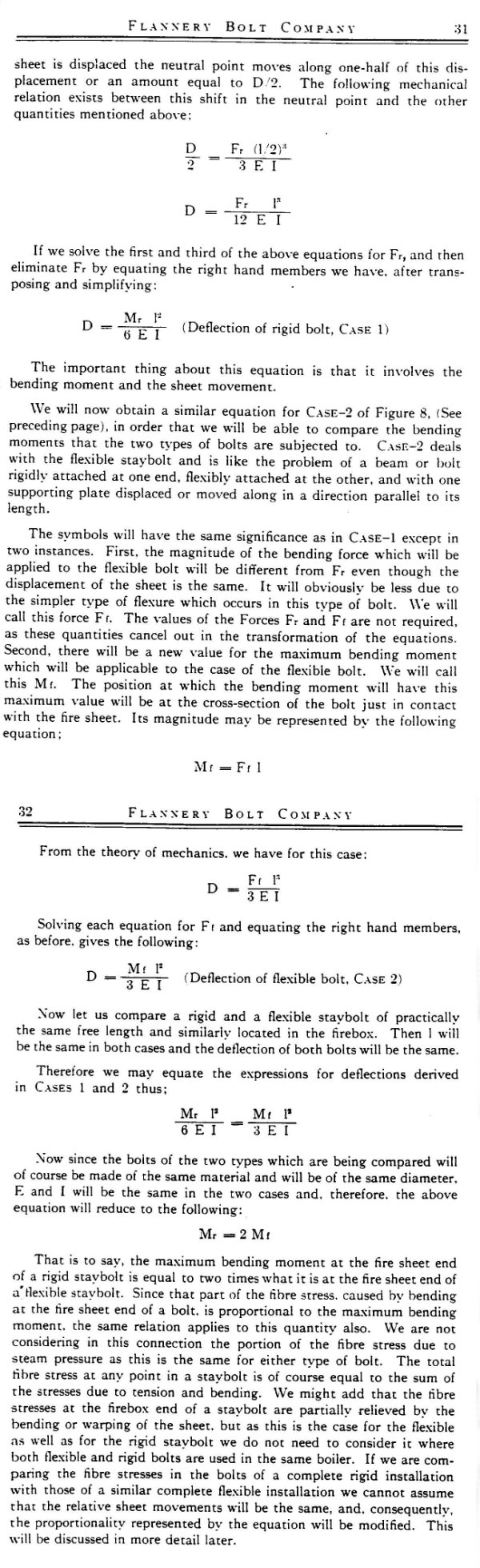

STAYBOLTS
Flannery Bolt Company
by G. R. Greenslade (1940)
courtesy of Dick Stone (about 15 years ago)
Download Full Book(2MB)

Matt:
That's a really interesting piece. Tross's work (1951) explained that maximum staybolt stress occurs as the firebox plate cools from expansion.
When the firebox plates are hot, the staybolts are preventing expansion. Corrugation occurs rather easily due to the very high plate temperatures which allow it to deform easily compared to the cooler staybolts. The plate is essentially gathering up material so the staybolts are relatively straight when the boiler is under fire. When the fire is extinguished, the plate material becomes much stronger, and as the plate cools and shrinks it exerts great force on the staybolt. This is Tross's explanation for why cracks occur at the same clock positions.
Tross went further to examine these localized effects and how they do things to the boiler in general like make the sides of the firebox "hog" etc.
I think it was the discovery that boiler deformation was the cumulative effect of different local bending stresses that caused Greenslade to endorse Tross so heavily. Unfortunately, the product of this collaboration was mostly unrealized.

Thanks for the Flannery booklet. I recalled seeing some of the illustrations in a Flannery catalog and it's nice to know where they came from. Since this was from Vol. 9 No. 1, I wonder what the other booklets would have covered and indeed if they still exist? I assume this publication was either a Flannery house organ or a series of marketing pamphlets.
As an aside, the boiler used in the firebox temperature determination appears to be from a NYC L-1 Mohawk. I would speculate that it was either 2500, the first Mohawk, which was a one off that was extensively tested before more were ordered or 2569, which was rebuilt into a 3-cylinder experimental while retaining its original boiler. Either would be logical candidates for boiler capacity measurements.
I think this work by Greenslade and Tross compliment each other. Greenslade determines uncompensated expansion and Tross works on where it goes -- buckling, bulging, and plastic deformation.

On a second perusal of the Flannery booklet, pages 27-34, I noticed that the modulus of elasticity of iron was used for the staybolts while the modulus of elasticity of steel was used for the sheets. Also, on page 32, the derivation comparing rigid and flexible staybolts uses the same modulus of elasticity for both. This implies that the the flexible staybolts were wrought iron as well. This was appropriate for an L-1 boiler built in the 1916-1918 timeframe. Indeed most rigid staybolts were still wrought iron at the end of steam, but later flexible staybolts were manufactured from steel. The derivations and caluculations need to be changed to reflect the modern practice of using steel staybolts.
In particular the table on page 33 needs to be reworked. The expected result of this would be greater bending of the sheet relative to the staybolt.
This has me thinking about the replacement of old wrought iron bolts with steel bolts in repair situations. When deflected by sheet movement, which would reach its yield point first? Would a single steel bolt surrounded by iron bolts break first? I think I have some materials to research and some numbers to crunch.
I'll try to give some consideration to what the additional sheet bending will do as well, but, as I don't think the problem is as straight-forward, I don't promise firm conclusions.

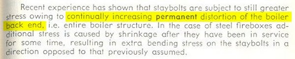

Matt J
Both the Henschel Locomotive Design Book and the Tross Papers describe a permanent backend distortion or "vaulting".
Would you be so kind as to summarize this phenomenon? I have never been exposed to this.
Matt A

The most general description is that there is installation and operation distortion of the rear boiler.
The two forces at play are pressure and heat related deformation. Pressure creates as much as a 5mm deformation (on a German Class 44 boiler), especially in the transition zone from the sidesheets to the crownsheet on a radial stayed boiler.
Heat related deformation is partially due to the natural tendency of the sheets to curl inward from being heated - whether from a fire or welding.
Interestingly enough, the two stresses are generally counteracting up to the point where component stresses (ex. staybolts) are exceeded. Then, a direction of permanent deformation becomes more prominent.
The firebox sheets shrink over time. The sidesheets tend to push the wrapper out at the center and give the sides of the boiler some "hog" while the crownsheet tends to sag, particularly in front. Radially stayed crownsheets being particularly susceptible to the later.
On the project we worked on together, we experienced the results of both stresses- which greatly increased my curiosity when I later found Tross's explanation of it - better described in his paper, "New Knowledge of thr Rear Boiler." The wrapper sides were hogged-out which we somewhat improved with elaborate strong-backing. During installation of the firebox, it moved around quite a bit and the welding plan was adjusted continuously as we shot the position of the firebox relative to the wrapper and deformation of the sheets much like Tross did with his observations using a light.

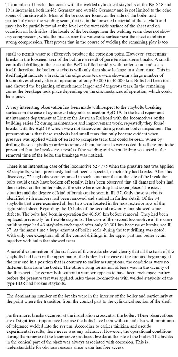

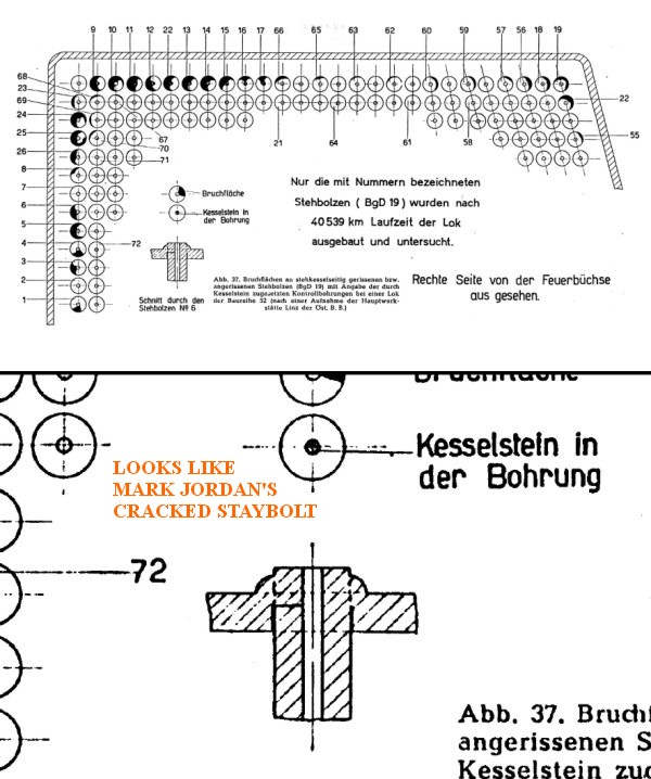

SEEMS LIKE Prof. TROSS WAS NOT TOO HAPPY WITH FILLET WELDED ROUND BAR STAYBOLTS
BgD 18 & 19 refers to 18 mm and 19 mm round steel bars
Boiler and boiler side refers to the wrapper sheet
Crosscut is equivalent to cross-section

Matt A:
Yes, Exactly.
