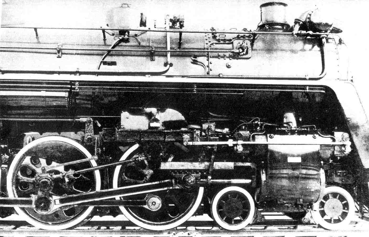

There are some pictures of No.6184 with poppet valve further along in this link:
http://www.exporail.org/can_rail/Canadi ... 7_2002.pdf
A friend also sent me a bit of data from a "Locomotive Cyclopedia", 1950-57 issue - Sec. 18 'Poppet Valves' with another view of the Northern Type. It states:
"Equipped with Poppet Valve Gear, applied to existing piston valve cylinder castings at Montréal Shops, 1949. One 14-in. piston valve in each steam chest replaced by two 7-in. diam. admission and four 7 in. diam. exhaust valves."
 Post subject: Re: USATC 2-8-0 No. 611
PostPosted: Sun Jul 07, 2013 5:32 am
Posts: 488

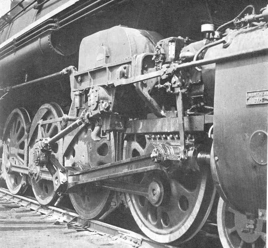

Thanks for the link- you DO learn something new every day!
"...experimental rotary valve gear developed from Czech patents by Dominion Engineering."
It's hard to tell a lot from the photos. The drive is very much like Franklin Type B. It looks as if they may have somehow retained the original piston valve cylinders. I'd love to see a drawing of this setup.
Hugh Odom
The Ultimate Steam Page
http://www.trainweb.org/tusp

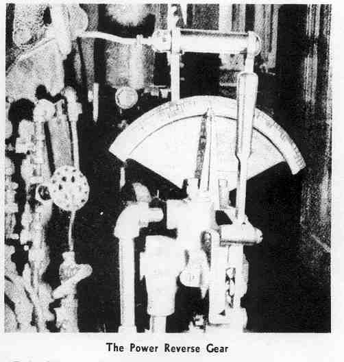

I'll try to attach some pictures. A couple of (hopefully) better views of the gear on No.6184 and then some Franklin material a friend sent me.
PostPosted: Sun Jul 07, 2013 4:06 pm
Posts: 445
Location: Ontario, Canada.
And the Franklin pages - I hope they have not already been posted.
