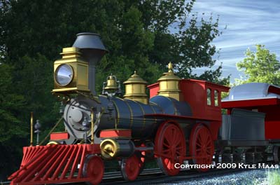

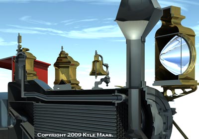

Here's a couple examples of what it looks like. It's an 1870's 4-4-0 with Stephenson valve gear. Almost all of the parts in these renders are perfectly accurate to the original (the smokestack's about an inch too far forward in the external shot, and the cab's missing the forward windows, but that's about it). My goal for this was to build it accurate enough that it could be built in real life off of my model and work exactly as the original did.
When I'm done with this one, I've got access to be able to do the same with (among others) a New York Central Mohawk, which will really be good for demonstrating a few of the later developments like air brakes, injectors, and Baker valve gear.
Anyway, it being an older engine, it's a very simple machine - no brakes, no injector, none of that newfangled stuff - so it would make it an ideal teaching tool due to its simplicity. So, like I said, I plan on making it available for museums and such to use to show how it works.
I've got an animation showing more of the engine, and one of it in motion with pistons pumping. If I can get it up online to show you, I'll be sure to put a link here so you can see. But, I think 'ya get the general idea of it from these.

Your computer renderings are in many ways impressive. However, I believe that these images, coupled with your own comments, only underscore the superior educational value of an actual sectioned locomotive (subject to all of the candidate criteria previously discussed - lack of rarity, lack of any special intrinsic historic worth, low operational potential, etc.)
You say of your virtual locomotive as follows :
[quote="tyrok1"] It's an 1870's 4-4-0 with Stephenson valve gear. Almost all of the parts in these renders are perfectly accurate to the original (the smokestack's about an inch too far forward in the external shot, and the cab's missing the forward windows, but that's about it). My goal for this was to build it accurate enough that it could be built in real life off of my model and work exactly as the original did. *** I think 'ya get the general idea of it from these.[/quote]
Presuming that the original of your design sufferered an immediate and catastrophic boiler explosion on its maiden run, you have succeeded in your goal of accuracy. I refer to the complete absence of radial crown stays, which would likely have caused a rupture of the crown sheet, the wagon-top roof sheet, or both. If this occurred at significant pressure, the boiler might have violently catapulted off the frames and landed disasterously some distance away. I say "likely" and "might," because you've also depicted some sort of weird combustion chamber (the angled slope sheets) with what appears to be a second firehole. It's not clear if the fire goes above (and the coal is to be shoveled upward and through) the angled sheets (in which case the lack of combustion air would probably prevent a crownsheet failure by ensuring that no water is ever boiled). If indeed the fire goes below this device, the choking of the draft by that second aperture would similarly result in practically no steam being produced.
Also, the "combustion chamber" plates are not stayed to each other, meaning that they would probably pretty quickly bulge and fail if indeed their design is meant to indicate a water space. If the gap between them is not a water space, then after a period of glowing red hot, these portions would simply melt and drop. My uncertainty as to whether these parallel sloped sheets contain water is due to the fact that they are attached blindly to a single plate that curiously serves as a combined doorsheet and backhead (I believe George Stephenson tried that on the "Rocket" in 1829 and quickly learned that a proper stayed firebox was essential; your locomotive's firebox would have glowed red-hot inside the cab, an effect that would be both extremely unnerving and highly uncomfortable for your virtual engine crew. Also, with the whole boiler being unlagged, any steam produced would have suffered from serious heat-loss inefficiency and your nice glossy "Russia Iron"-colored external finish would not have lasted many hours (no barbeque spray paint in the 1870s).
Perhaps you've misinterpreted a drawing? For example, maybe you mean to depict some kind of arch tubes or circulators in the firebox - a bit anachronistic, to be sure - and you misunderstood a cross-section of a tubular shape as two parallel plates? Or maybe this information come from some other source... maybe the old 1970s plastic-kit model of "The General"?
Please do not misunderstand my point. I'm not simply having a go at you; animation design problems can presumably be resolved. But you appear to sincerely believe your locomotive would work - you say that it would "work exactly as the original did." However, these are quite fundamental design flaws that I daresay anyone with steam experience (actual or theoretical) would recognize immediately. Presentation of this design to museum visitors, no doubt with utmost best intentions, as an explanation of how a steam locomotive works is rather like a physics professor teaching that the earth is flat (maybe that happens in some of our "faith-based" educational institutions, but I digress... ).
What all of this really points to a high potential for significant deviation between the way a computer animator might understand a locomotive design when creating a virtual sectioned version, and a proper engineering understanding, which - in condensed, essential form - is the message sought to be conveyed. The "real thing" suffers zero depiction inaccuracies when sectioned - it is what it is.
-G.J.C.

You'll notice I mentioned "...all of the parts in these renders..." - it's because not all of them are done/there. I guess I should have made that more obvious. None of the parts are riveted together yet, and there are no stay bolts of any kind. That firebox was a pain in the neck to build, not being able to use welds. All of the pieces are separate pieces of sheet metal, cut to overlap enough that they could be riveted together. If you look close, the lower section of the firebox is just hanging there - it would drop onto the tracks. It's also missing the throttle, pressure relief valve, water pump, grates, sight glass, and all other instrumentation in the cab, among other pieces. As I said earlier, this is a work in progress, and I'm not releasing it until it's done.
But, yes, I certainly wouldn't _want_ anyone to build it _exactly_ the way it is either - it's a lap-seam boiler and has link-and-pin couplers. But, as a preservationist, I'm trying to exactly duplicate the original.
I'll post more when I'm a bit further along.
**EDIT**
Actually, come to think of it, it didn't even have radial staybolts. It had straight (and a bit odd) ones attached to bars which were then bolted to the outside of the boiler. These were rough times. :)

Just re-read your post, and I see your point. The space between the sections of the firebox is indeed water space, and this engine ran long enough that it was later equipped with air brakes. The drawings were from an 1870's edition of the Railroad Gazette, so they're certainly not a recent invention. I know it's a bit odd, but that's exactly how it's depicted.
Also, the metal can't get much hotter than the surrounding water due to convection in the boiler, so it still would have worked without melting the firebox, I would imagine. Maybe it was a primitive form of a pre-flue spark arrestor (the diamond smokestack has relatively little) or brickarch? I don't know. But it was most certainly a two-part firebox.

George Jackson Churchward wrote:
My uncertainty as to whether these parallel sloped sheets contain water is due to the fact that they are attached blindly to a single plate that curiously serves as a combined doorsheet and backhead...
I'm very much enjoying answering your comments on this - I find them quite interesting, and it really shows how carefully you're looking at this. It really makes me feel good to know that all that time to build it is going to good use.
Those sheets have exactly 3" of water between them. You can't assume so much from one view.
Now, to address the point about the lagging. You'll notice, if you look at the cross-section view, that the bands that hold the boiler jacket on are curiously far from the boiler, while in the external view, they're touching the jacket. What you're seeing as Russian iron got lost in the cross-sectioning and is not visible in that view. The lagging is not finished - it's waiting for me to finish one remaining missing part on the outside of the boiler.
For the fire burning in the top section of the firebox, I must be missing something, because I don't see the logic in it. That section would quickly fill up with ashes (along with the flues) due to the fact that it's not resting on the grates. On top of that, it would get relatively little air due to the size of the opening between the two parts of the firebox and the fact that it gets no air underneath. Plus, by plugging up the flues, exhaust would also be restricted. That is, if you could get the fuel up there and get it lit through that opening. If you could explain this further, that would be great!
I appreciate your careful observations on this - I'll be sure to run it past you all when it's finished to make sure I didn't miss anything. And if you have anything else you notice about it, feel free to PM me, and I'll do my best to answer it to the best of my ability. Thanks!
