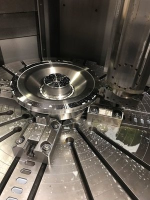

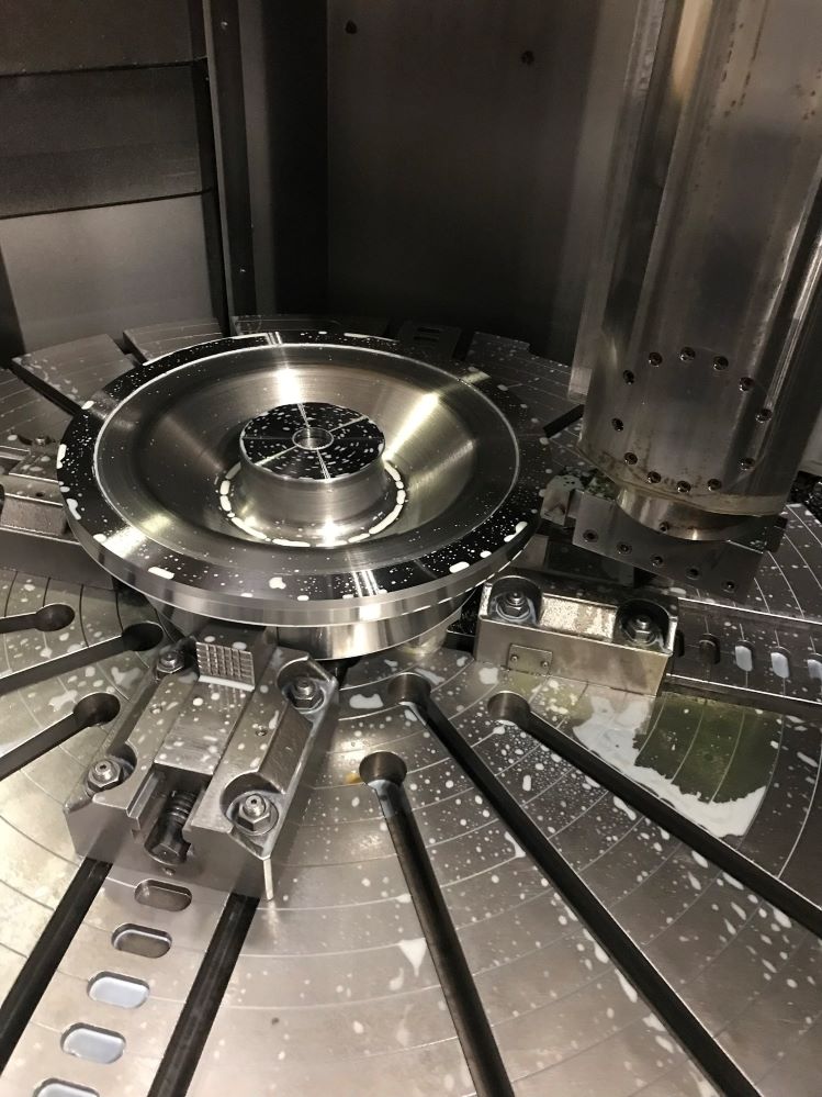

1309's piston(s) in Maine (not sure if it is two or the same one in different states) a week or so back: https://www.facebook.com/WMSRailroad/po ... QVhsqn7UFl
464403447_944787121024084_7456031711568183619_nb.jpg [ 105.35 KiB | Viewed 12845 times ]
464519423_944787154357414_1637538450736650035_nc.jpg [ 121.13 KiB | Viewed 12845 times ]
