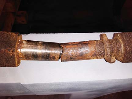

Steam locomotive restoration is never easy, it is certainly not cheap, and you always find more things to fix once you get started. This particular bolt was one of 14 that attaches the cylinders to the frame. This bolt and several other frame bolts have been replaced. How many restored locomotives have been returned to service without someone climbing under the cylinders and carefully inspecting each bolt?

I didn't expect to see a Baldwin Flexible Frame Bolt in use on a Porter.... nice find.

It’s a two-piece bolt for mis-aligned holes. My favorites come pre-stripped for easier over-torquing.

That's a good suggestion, but we didn't think of it before reaming the holes and making new bolts. We're going to have to over torque them the hard way.
