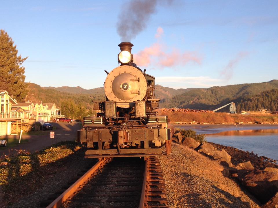

The railroad, via a FB post, says Skookum is "out and about".

And apparently Why metal got bent and How it was fixed and corrected will remain a secret?
From the Trains Newswire story today (currently not behind a paywall):
"Parts that had been bent on the low pressure engineer side were straightened, machined, and re-installed. Then the engine was towed in the yard to make sure all running gear parts were moving freely. Then a fire was lit and Skookum’s boiler brought up to working pressure of 200 psi.
Team Skookum diagnosed the problems suffered by Skookum’s low pressure engine as a timing issue that actually originating in the high pressure engine valve train. Once this was corrected with new keys made to set the high pressure eccentrics and installed, the bind in the low pressure mechanism went away, and Skookum was ready to be tested."
For the full article, click here: http://trn.trains.com/news/news-wire/20 ... s-resolved
Big Jim Video Productions
Morrisville, PA
 Post subject: Re: Stretching her legs 63 years later
PostPosted: Fri Dec 07, 2018 5:24 pm
Posts: 171
Location: Arizona
Maybe somebody smarter than I am can explain how having the rear high pressure engine's valve gear out of whack cause the front engine's valve jam and turn the valve gear into a pretzel.

Most low pressure steam engine cylinders are designed for about 60-80 PSI if I remember my triple expansion steam engine setups right. The middle cylinder of those was low pressure the 3rd was very low pressure. Well you hit a cylinder designed for 80 PSI with a full shot of 200 PSI steam when it expands to try and condense back into water and things are going to break and bend. The back cylinders where exhausting to soon feeding higher than expected pressure steam into the front cylinders and things got bent. It would be like shoving a turbo from a C15 Cat OTR engine onto a VETC Honda 2 liter. Things are going to shatter.
PostPosted: Fri Dec 07, 2018 8:16 pm
i.e. too much pressure on the slide valve, causing it to seize, and then the momentum of the wheelset bending the return crank and link motion.

I’m glad people took notice to the silly “explanation” of why the valve gear got all bent out of shape.......
Further showing they are not willing to admit and explain what in all really happened.
I’m more curious as to how exactly the parts were repaired. From a few people that were at the charter I’m told the parts were bent more then once.......curious as to their integrity now if they decided to try to repair again.
