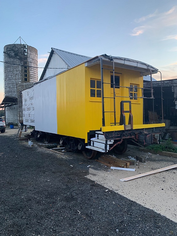

Yes, it's been a while since we have posted an update on PyPN. A great crew of young talent has really driven the project forward. Siding is now going on after a great deal of prep work, much of which will never be seen once the siding is on. Another day or so and this side will be done. Hope to have all for sides done for winter. Fingers crossed! What you see here are original windows and door installed in the new body structure. Again, we created an N6b kit of sorts as we disassembled the body originally.

Again, tremendous save. No windows on this side, eh? There aren't any photos from when you recovered it of one side.

There are windows on the side, we just did not cut the siding around them at this stage of the game. Various pieces of window trim have to be installed inside first then the siding cut to match the trim. There is a process here.

I'm a bit ignorant as to the construction techniques so I was wondering what is the plastic looking material towards the far end that is not yet sheathed? Is that just tarp to keep the elements out or some sort of underlayment you are putting between the framework and the sheathing?
Were these cabin cars originally insulated (with horsehair I'd guess?)?

As built, the car had thin tar paper under the siding. We went with Tyvek from Home Depot as its cheaper and just easier to handle. We took some liberties with some modern materials here and there to keep costs in check. We are paying for this out of pocket so budget is a consideration.

Thanks JR. Does Tyvek have the same or similar permeability as tar paper? The reason I ask is because it is my limited understanding that, in a regular structure such as a home, putting a full vapor barrier between the sheathing and the siding is fine because the home is insulated such as the air on either side of the Tyvek will be the same or very similar temperature. In this application, if the caboose is heated and not insulated such that the warm moist air contacts the interior surface of the Tyvek, and the Tyvek is a vapor barrier, then if it is cold enough outside the inner surface of the Tyvek will be below the dew point and it would appear that you could get condensation at that inner surface.
This is why I inquired about the insulation.
The car looks great. Is the yellow you used a final match to the yellow in the photos? Were you able to get any paint flakes from the rotting carcass you saved?
My main concern was driving rain. It will probably be a very rare occurrence that the caboose will be heated in the winter time, or really ever have any great variance between inside and outside temperature.
There was no insulation in the walls when we dismantled the body. Only the tar paper.
We have plenty of exterior siding to make a match to plus photos. This is a second try at the color actually. You really can not go by what you see on a computer monitor as they vary so much. Actuals are more dependable as is an actual hard copy original color photo.

"Tyvek from Home Depot" (presuming this is a reference to Tyvek 'Housewrap') is not impervious like one might assume a plastic sheet is. From the product description:
The world's leading house wrap has the optimum combination of properties to deliver the best balance of weather protection, moisture management, and durability behind residential facades. Reduce household drafts and make your home insulation work better with TYVEK HomeWrap 9 ft. x 150 ft. roll house wrap. Its vapor-permeable material helps expel internal moisture while repelling rain.
https://www.homedepot.com/p/TYVEK-HomeW ... /308793219
Housewrap is supposed to block liquid water, but not block water vapor.

Rader, thanks for the background on Tyvek. In truth, I looked at tar paper, but it was very expensive compared to the Tyvek. In addition, to me at least, tar paper seemed delicate, prone to tearing, ripping, etc. I have found Tyvek to be easy to work with, and as tough as nails. Trying to trim small pieces with a brand new knife blade proves difficult. Its amazing stuff. Again, my concern was driving rain more than anything else. If good enough for a house, I figured it was good enough for the cabin car. Oh, and it fit the budget.
