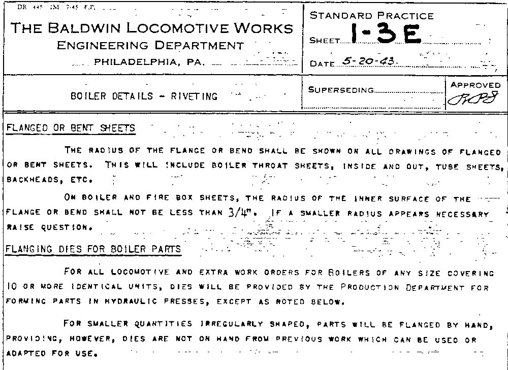

Baldwin's magic mass production number was 10.
That's interesting. What do you suppose they would have done with a frame for a single model like this one, or had they stopped agreeing to one-offs by that point?

"M Austin wrote:
Baldwin's magic mass production number was 10."
But this is for boilers, which have no relation to modern frames whatsoever. Furthermore, they apply to the sets of tools used to form the boiler plate for riveted construction, something that wouldn't apply anywhere to 5051.
As a potentially interesting aside, a similar set of progressive dies is used in forming the eyes of Timken light-alloy rods. Precise drawings and information for these exists in the N&W archives, and this qualifies as an 'intermediate stage' between the absence of the tooling and, as Baldwin noted, the existence of the tooling from a previous order.
Baldwin obtained cast beds from its subsidiary in Granite City, and I do not know by how much (if at all) the cost of one of the 25 T1s they produced was reduced by having all the cores and patterns made up to make the beds. None of that is even remotely relevant to the situation involved with making a new cast-bed equivalent. And certainly Baldwin provided plenty of bids for locomotives (or via GSC even for individual cast beds for other people's projects) in small quantities.

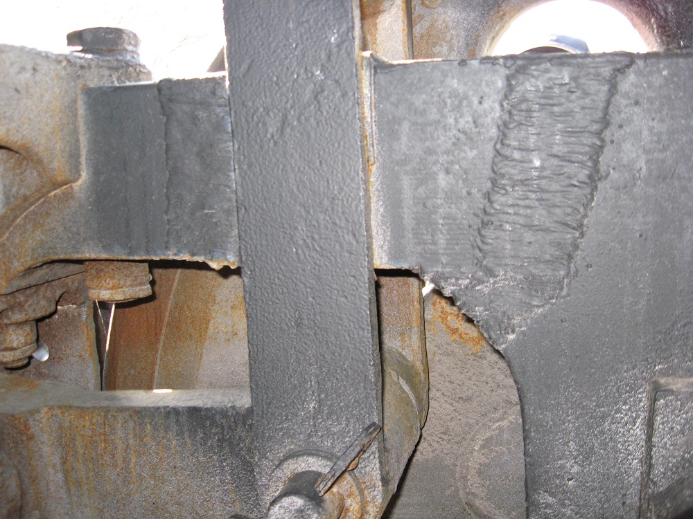

I've seen some massive weld repairs on the frames of several of the CNR engines that I've crawled around, from 2-6-0's all the way up to Northerns.
