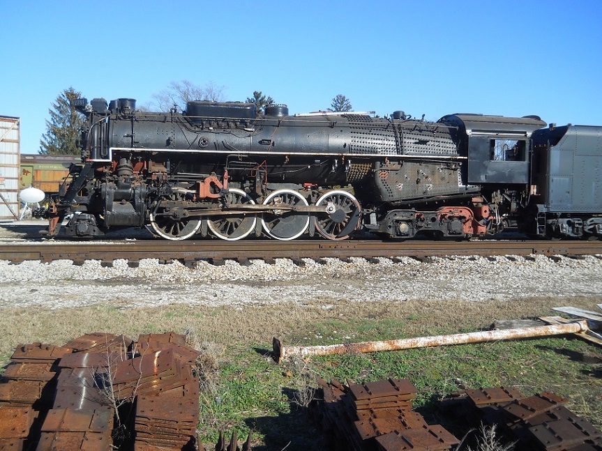

J3a-614 has brought C&O 2789 into this discussion as an example, and his photo of the Kanawha was a bit jarring to me. After many years, the 2-8-4 at North Judson finally got her sand dome put back on, as in the photo below.
