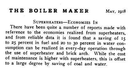

The economic value of superheat:

Nobody's arguing ( at least I hope not) that for a locomotive working intensively such as hauling a freight across a division in 1935 or hauling a long string of passenger cars from Durango to Silverton today, superheaters provide good economy. It is the infrequent short runs with a lot of idling in which it is of lesser value.
dave
Seems to me that there was an awfully large number of superheated 0-6-0 and 0-8-0 switchers in service. They moved heavy cuts of cars but were frequently idle.

Going back to the comments on switch engines with superheat, I believe some others will agree, there is another factor. The superheat makes the engine more responsive to the throttle, and reduces condensate in the cylinders. These would be good performance factors for intensive switching jobs.

Yes, the NWS&W 0-8-0s all were superheated to the end (not saying that there might not have been the odd unit or three blanked off).
One preserved locomotive which was converted from superheated to saturate steam is former Crab Orchard & Egyptian 2-8-0 No.17 which was converted because someone at the CO&E thought that superhearers were a maintenance problem.
I happened to stop by their shop and saw the superheater units lying on the ground, asked about them and was told the story
The units were like brand new, still with Canadian Elesco metal tags wired onto them. They were about to cut them apart to salvage the clamp blocks and bolts.
I made a deal with them (on behalf of Illinois Railway Museum) to supply new blocks, bolts and ball ends with "U" shaped tubing in exchange for the units.
They cut out the portion of the tube sheets where the superheater flues were and made patches with just 2" diameter holes.
CO&E got No.17 running, but were never happy with it and eventually purchased a diesel.
J.David
PS: At Valley Railroad, we find that our No.40 2-8-2 which is saturated, uses about 25% more coal and water than our No.3025 which is superheated (and has a combustion chamber) doing the same work on the same 10 mile (round trip) run. One of my dreams is to superheat No.40 someday. JDC
