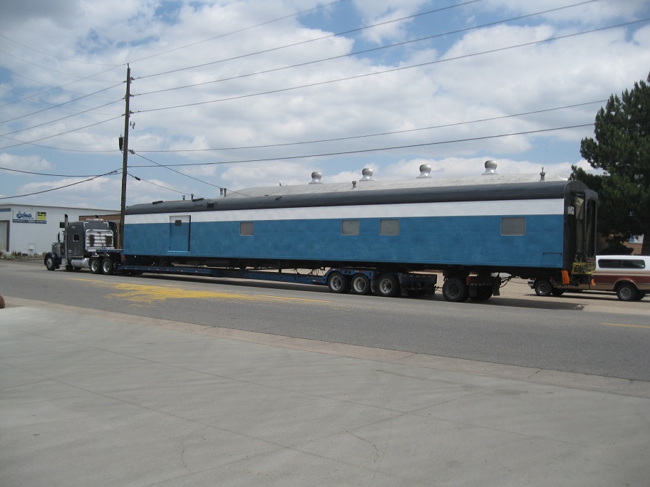

"In the above photo from Jody Moore's website and in the main photo on the Ozark Mountain page for the Loch Tay, I noticed a third car, also painted deep red, and in the above Jody Moore photo, a fourth car in Amtrak Phase I. Does anybody know the identities of either of these cars? Thanks in advance!"
The 3rd red car is a former Amtrak, former Army SLC 1952 baggage dorm. The car in Amtrak paint is what may be the only surviving baggage dorm from the Mid-Century Empire Builder, built by ACF in 1951. Both cars, like the others in the picture, were on blocks, sans trucks.
The GN car is owned by the same party who owns the 2 slumbercoaches. It was painted Big Sky Blue a few years ago and is currently stored in an industrial park in the Denver area. It is fairly complete inside, everything considered, but as can be seen the car is missing a few items underneath.
