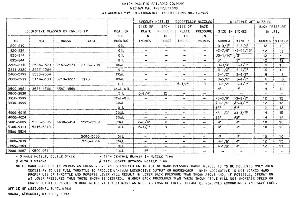

Posts: 488
Note that UP decreased the nozzle diameter from 3-1/2" to 3-3/8" on the Big Boys in the winter months and allowed for an increase in back pressure from 14 psi to 15 psi to account for combustion of denser ambient air. A seasonal adjustment of 125 thousandths of an inch in a 7000 HP machine for optimal efficiency is not voodoo, trial and error pseudo-science. People that proclaim "it's not PhD rocket science" can't do PhD rocket math.

Thanks for the orifice data. Since the critical back backpressure is around 11 psi, afaik, it is clear that the UP locomotives could operate above the sonic barrier. My understanding is that velocity cannot increase but since the pistons keep on pushing, the mass flow remains the same and the density increases. As momentum that has to be transferred to the combustion products has velocity squared in it and density only linear the combined effect is not what one would want.
Now for the extra orifices, if you Google "diffuser performance" a chapter of the fluid dynamics handbook by Blevins is made available, look at Fig.7-12b
It shows performance data of diffusers, in our speak tapered chimneys or stacks. The chimney of the BB is 49.5 in high and has a throat diameter of 24.5 in., that would give a length ratio of around 4. However since 4 orifices use this chimney, for each of the four flows the length/radius is 4 times larger and is around 16. The diffuser angle is about 7 degrees, it increases 6 inches over its length and the performance indicator of the diffuser is around .72. This is the ratio between the recovered pressure and the velocity pressure at the mouth of the diffuser. Now adding an extra orifice would raise the length ratio to 20 with a Cp of around .77, so
all things being equal the vacuum goes up by 77/72-1 or 7%.
From the present data I could calculate that below a steam consumption of 37 tons no problems with the sound barrier would exist, reducing the orifice area would lower that amount. I do not know how much extra air is requested because of oil firing but in the coal case the orifices could have been made larger if the extra vacuum was not needed. The maximum possible would be a seven orifice system, Cp goes up to close to .80, clearly diminishing returns.
Kind regards,
Jos Koopmans
