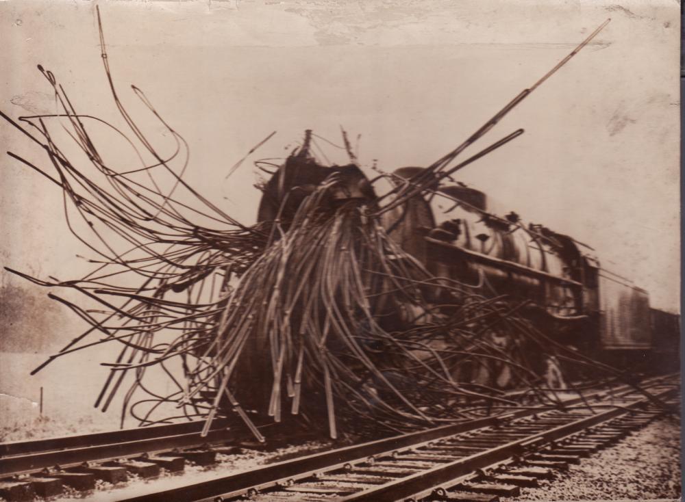

This shot is making the rounds of Facebook. No details given, but it is an impressive shot.
One thing I don't quite understand is that most (all?) of the tubes seem to be small and have the ends doubled over. Are these all superheaters? Would there be that many? Is this a water tube boiler?
 Post subject: Re: An old wive's tale
PostPosted: Sun Feb 17, 2013 12:18 am
They have the "hairpin" look of superheater elements on my monitor.
PostPosted: Sun Feb 17, 2013 1:41 am
Posts: 3014
dave
That's what I meant about them being doubled over. I'm just surprised to see quite so many. Any idea what would blow out all the superheaters like that? It's pretty hard to tell but it looks like they may all be superheaters?
PostPosted: Sun Feb 17, 2013 1:58 am
Joined: Fri Mar 21, 2008 11:12 pm
Posts: 95
Location: Boulder, CO
My guess is that they are actually shredded pieces of ordinary flue tubes, split, bent and twisted as they simultaneously tried to exit the smokebox. They appear to me to be way too small to be superheater tubes, and smaller still to be superheater flues. The boiler spilled its guts for all to see. Looks like the front flue sheet failed for reasons unknown on a railroad unknown.
Demonstrates why a steam locomotive must be operated and maintained with an excess of caution. Remember, that boiler on your locomotive is a mobile bomb.
IMHO, of course.
Mike
PostPosted: Sun Feb 17, 2013 8:44 am
Looks like an AMC/Van Sweringen 2-8-4, and it barfed up its Type E superheater. Those are superheater units; the bands and unit supports are visible on many. Engine didn't even derail!
