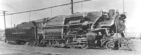

The DELAWARE & HUDSON RR had such a beast
Not that I'm aware of. Other than the Alaska Railroad, the only somewhat large railroad I've heard of which used an S-160 was the Maryland & Pennsylvania (Ma & Pa). That was the poppet valve equipped 611 which was loaned to them by the Army for testing shortly after the conversion.

This is what I am rather was thinking of and her sisters ..
Mr. Starr

PostPosted: Sun Jan 19, 2014 10:20 pm
Posts: 383
Mr. Starr
http://www.douglas-self.com/MUSEUM/LOCO ... Ahp.htm#ha

Steve Freer wrote:
Mr. Starr
Exactly!
Mr. Starr

Holy smokes, and people say the S-160 is homely. I am glad our engine is not one of those complicated monsters.
Jeff
