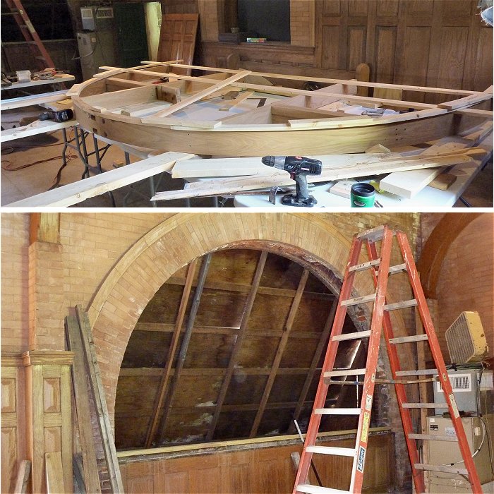

This large arch window for the downriver side of the waiting room is nearly ready to be set in place in the opening. Both the window and the brickwork had to be rehabbed due to water damage.

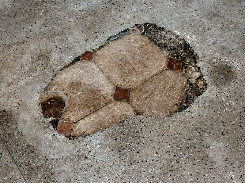

Original floor tiles have been uncovered in the Depot waiting room. When the Depot was built in 1891, the tiles were laid over a wood and composition subfloor which was supported on bedrock. Eventually the wood succumbed to rot and began to sag, resulting in an uneven floor. Probably around 1930 a layer of terrazzo (concrete mixed with marble chips) was laid over the entire waiting room floor to level it out. It is hoped that the floor can be pulled out and that most of the tiles can be preserved and relaid over a new subfloor. This could be done mostly by volunteer labor, but will be a time-consuming effort, so there is no immediate plan to undertake the effort.
