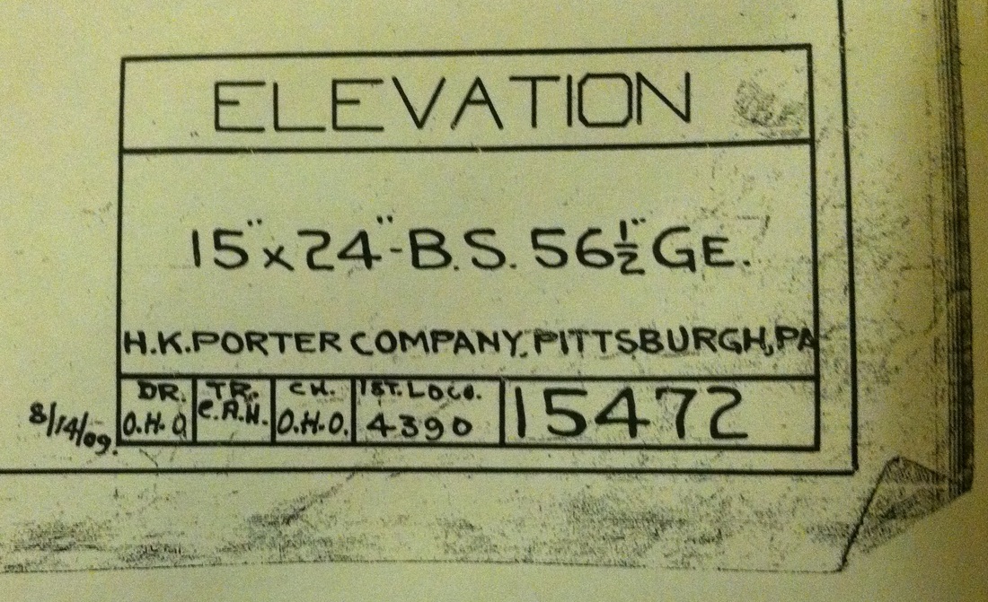

Lucien -
Thanks for pointing out this obscure steam locomotive restoration which seems to be progressing along very well. However, there is a statement on the referenced Facebook page that reads as follows:
"Built in 1909 by Porter, SCPC 2 was the FIRST of her kind, being the prototype for HK Porter's new line of 0-4-0t locomotives."
Certainly Porter built 0-4-0T's prior to 1909 and long thereafter. What made number 2 "different" from what Porter had built before? No explanation of that statement is on the Facebook page. If anyone can provide enlightenment, it would be appreciated. Thanks!
The project website hints it had some improvements over the previous design:
"The first of Porter's 'new and improved' 0-4-0 standard gauge tank engines."
http://www.scpc2.com/locomotive-specs.html
Would be a fun homework assignment to research what all the changes were, and why.

Les,
SCPC #2 is my personal locomotive, so thanks to all for your interest in the project. Builder's number 4390 is the prototype for HK Porter's new designs of 0-4-0 based upon the following data. While searching the CSRM microfilm collection of porter drawings several things became apparent. One, builder's number 4390 was the first boiler for an 0-4-0 according to the drawing collection with buttstrap construction of the barrel. The drawings were organized chronologically and dated, so this was easy to infer. Also it helped that the drawing for the boiler was marked "1st Loco 4390." After more searching I also located the drawings for the cylinder saddle, driver centers, brake rigging, frame, etc. also marked "1st Loco 4390." This was further corroborated by a friend sending me a copy of the erection drawing from the Canadian Museum of Science and Industry which also was marked "1st Loco 4390." Although HK Porter did continue building smaller 0-4-0s to the older designs, the DNA present in my locomotive is easily seen in all the later 0-4-0s up until the piston valve era of HK Porter products, and the boiler design lasted almost until the end. A very interesting facet of this locomotive's history! For more information check us out at:
Thanks!
Stathi

Stathi -
Terrific explanation. And as the gentleman used to say, now I know "the rest of the story!"
Continued success on the restoration of SCPC #2.
