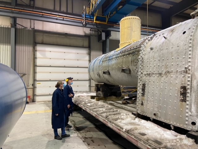

Audrey's boiler has arrived at Boilersmith's facility in Seaforth, Ontario and the process moves along another step.
I'm told the young lady in the photo above volunteers on steam locomotive crew at a local heritage railway in addition to working on the engineering staff at Boilersmith.

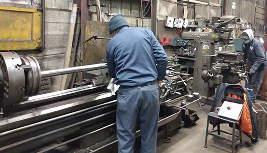

Meanwhile, back at the McHugh Locomotive shop in Pennsylvania, one of the piston rods in being polished in the lathe and a driving box is getting some attention in the milling machine.

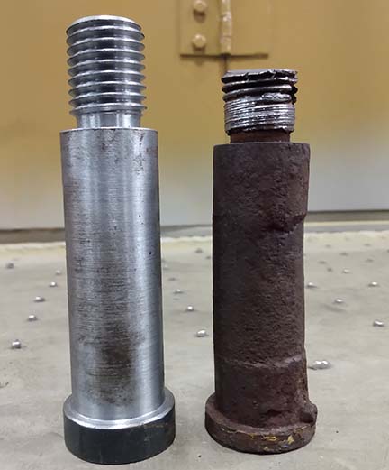

Here is a new spring hanger pin compared to one of the old ones. All of the pins have been machined and are ready for installation.

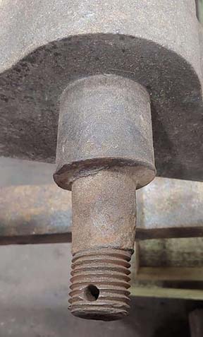

Brake rigging is often neglected on heritage equipment. The brake hanger pins are in terrible shape, they have been removed from the frame, and new ones will be made in the near future. Fortunately, because Audrey is so small, we only have 4 of these pins to worry about.

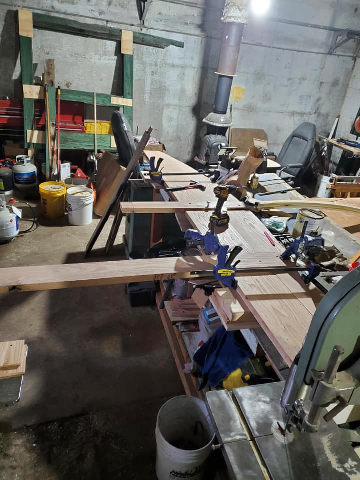

New cab progress at the Vintage Rails Restoration 'silo' in Cheyenne, front cab is on its way to being assembled.

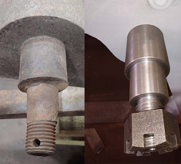

I've not not posted anything in some time. A lot of parts have been fabricated and are sitting aside waiting to be installed. Here is a before and after photo of the pins through the frame that the brake rigging hangs from. The way I took the photo and the cropping distort the view a little, rest assured that they are right.

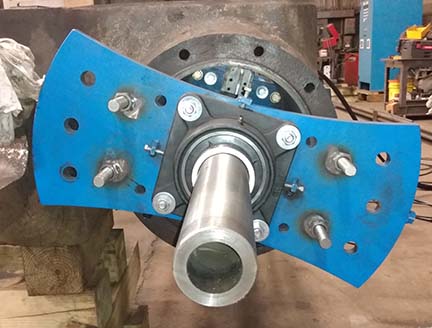

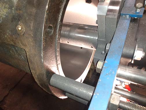

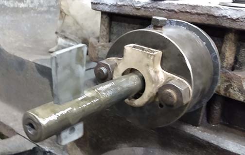

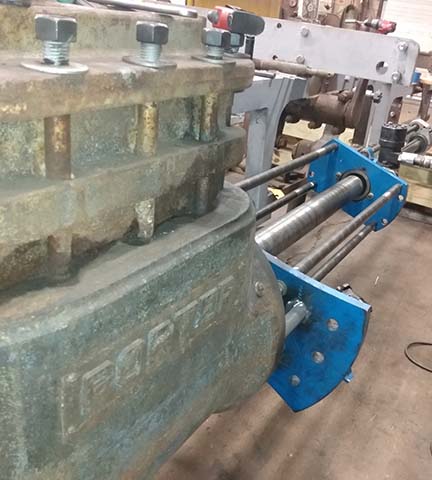

The latest work underway on Audrey involves boring the cylinders. I hope to post more in the near future.
