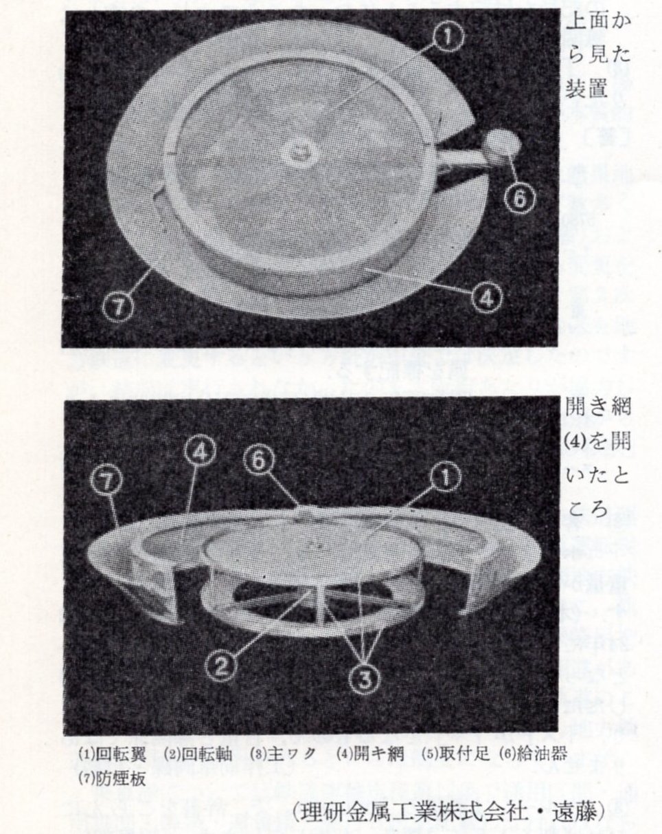

Ron Travis wrote:
I also wonder how effective a spark arresting device can be if one were starting with a clean sheet of paper and were freed from the constraints of historical appearance.
Here is diagram of a device (which RyPN member Shogo Takizawa provided), installed on Japanese steam locomotives from the early post-war years until today, that I am very curious about. Japan's railroads in general aren't known for wasting money on things that don't work, so I suspect that it has some amount of usefulness, how much is the question. Could a test be performed, say with a thermal imaging camera and some type of particle counter? Intentionally make a lot of sparks go through the stack without the device and then install it and repeat? Also, would these really be that unhistorical looking? I too would not want some complicated vacuum-type contraption up there, but this looks unobtrusive to me.

PMC wrote:
I remember that we had talked about that device in an earlier thread. I don't know anything about it. I get the impression that it is spun by the exhaust gas as if it were a turbine rotor. If so, it seems that the purpose might be to pulverize hot embers so they are cooled by dissipating their heat into the relatively cool outdoor air before they land on the ground. That may be a more effective idea that simply trying to catch all the hot embers with a screen. The spinning rotor would never need cleaning. It would never inhibit the exhaust draft like a screen might.
If that is a steam turbine driven by exhaust steam, it raises the question of driving a rotor for the same purpose by an actual steam turbine motor driven by high pressure steam directly from the boiler.
The typical kinetic approach to the spark arrestor challenge seems to have been to use the exhaust steam and guide it into a cyclonic action. Going a step further and using boiler steam directly to drive a turbine that powers an ember smasher might open new avenues of solutions.
If that Japanese device works the way I think it does, its rotor impingement on the stream exhaust particulate would be dependent on the velocity of the exhaust stream to spin the rotor. That dependency may impose a limitation in the ember smashing. If you break that dependency of the rotor being driven by exhaust steam by driving the rotor directly by boiler power steam, it may get rid of any limitation on ember smashing. The objective would be to allow the total velocity of the exhaust stream unimpeded flow while intercepting it so often that no ember ever gets through that interception process.
