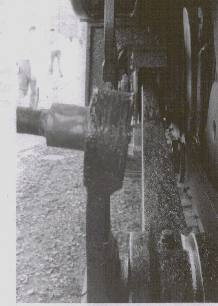

Unless the main pin is screwed up, looks like the hardest would be the eccentric crank. Heat n beat n check. Should be OK, just extra work. My biggest concerned would be what the valve area of the cylinder and the valve look like.

To the comments on straightening motion work:
So is that why so many of the engines I have worked on have numerous hammer marks all over the motion work?
 Post subject: Re: Stretching her legs 63 years later
PostPosted: Sun Oct 28, 2018 6:43 am
That's also how they are taken off and put back on.
Walschaert gear also sets the valves by altering the length of the rod. Generally this is done by heating and beating to either draw it out or upset it.

Looking at the photo, I theorize that the engine was traveling in reverse when it happened. It does not look like the return crank would clear the rod, and thus the stopped position must be at the end of a reverse rotation. Also, I could see the valve motion freezing at mid stroke and then the return crank bending back as the return crank made its loop around towards the front again. It must have been caught and stopped really fast, because I can not imagine any of this still attached if it made multiple rotations.

I’ve been sitting here looking at the bent parts wondering about getting things apart. I guess they’ll start by removing that bolt/pin where the eccentric rod connects to the expansion link. Odds seem high that the parts are still under tremendous load, so it should be a pretty exciting job to get the first part off.

In 1959 CB&Q 6315 "threw a rod"-presumedly the eccentric rod, bending the eccentric crank as shown. Fortunately, 5632 was up to the task of taking lame loccomotive plus train to Galesburg where the photo was taken.

Ex GTW #4070 threw an excentric rod on an excursion with ex Reading 2102 on Horseshoe Curve back in the latter 1970’s. Funny, people in the preservation community didn’t completely lose their minds back then. Complex antique machinery can and will break down.

There is nothing in the photograph that I see needs to be replaced, just blacksmithed straight again. The side plates of the expansion link are probably going to be about the hardest thing to straighten up and correct, since they have fitted bolts at each end needing to align precisely with the holes in the link. Hopefully the link itself has not been distorted.
Given the age of the engine, it is doubtful that any of these parts are made of particularly high carbon or other high alloy steel. Therefore, with care every part shown should be able to be straightened out and salvaged for further use.
Kelly,
I agree. Now, I know this is impossible to surmise without being there in person, but what do you think the likelihood is that the crankpin is bent/distorted?
Best,
DC

Oh, but the consequences of the Steam Tours failures with the early Conrail trips in the mid-1970's poisoned the waters for steam excursions on Conrail for the better part of the next decade. The Midwest Railway Historical Foundation #4070 crew was able to find a large machine shop in the Pittsburgh area in the week between the Horseshoe Curve trips and get the engineer's side eccentric rod straightened out and reinstalled. My memory of the incident was that a cotter key holding the rod on broke and allowed the rod to fall off. There is a dramatic photo of the incident happening taken by John B. Corns that appeared in Trains in, I believe, the August 1977 issue. John was riding the running board of one of the helper Diesels and got incredibly lucky in snapping a frame at just the right second. That particular trip lost hours getting going again and got back at something like 3 am the next morning. The train broke knuckles in two places and left potentially dangerous gaps between vestibules. I remember talking to someone who was on the trip and standing at an open vestibule door when the train went into emergency and grabbed a woman just about to cross between cars that parted and pulled her back to safety.

Not only is Brother Woodring's account exactly accurate, there was even an audio crew recording in stereo on the back tender of 2102, with one mike pointed forward and one back at 4070. The recording is still perhaps one of the most dramatic recordings, albeit in a gory way, made in the pre-omnipresent video camera era. (Just imagine a RR allowing such a crew to ride on a tender today, or allowing the van that paced 2101 on railroad access roads up Sand Patch and Seventeen-Mile Grade........)
