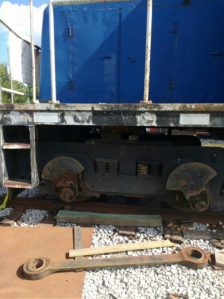

I just noticed something. Why does the axle on the left look like it has been subject to a large quantity of heat?
But isn't it the axle on the left in the photo you reposted (the outer axle) the one that appears properly quartered? The crank pins on the inner axle (on the right in the photo you reposted) are the ones that appear to be out of quarter by about 40 degrees.

Which axle is the powered axle? If the rear one is the 'idler' it wouldn't be really hard at all to extract that axle and take it to a shop who can press it apart and find out what happened.

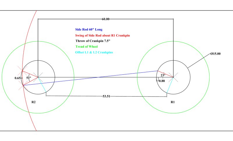

On all the other 4-couipled wheelsets, the side rod is horizontal and parallel to the rail, frame, etc.
This rod has a noticeable slope. This is not the same as all the others.
What are the consequences?
The wheel set is locked:
1. If the R1 wheel tries to move clockwise, the R2 wheel will be pulled counter clockwise by the rod.
2. If the R1 wheel tries to move counter clockwise, the R2 wheel try to move clockwise.
A 7/8" forward movement of the R1 crankpin above the wheel centerline and a corresponding 5/8" forward movement of the R2 crankpin below the wheel centerline causes the L1-L2 distance to be shortened by 6-1/2" inches! The 23 degree offset is arbitrary for clarity of the drawing, but indicates a 51 degree offset of the 2 crankpins. The principles should be obvious.
1. First, VERY FIRST make sure the axles are trammed 60" +/- 0.015".
2. Verify all the pedestal liners are in place.*
3. Jack both cranks on one side to a horizontal dead center. Use a level. (Verify the rail is level).
4. Verify the crankpins are 60" apart.
5. Verify the crankpins on the opposite side are 60" apart.
If there is still a problem, it is a serious problem.
*I have seen a 25 tonner(chain drive) running (slowly, in service) with all the pedestal liners sitting on a shop shelf. Slop was 3/4" per pedestal. "We didn't have time to put them in and it works fine."

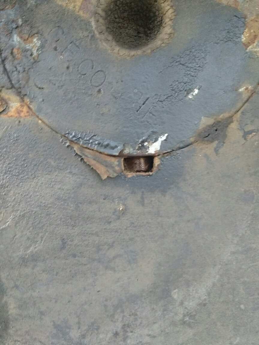

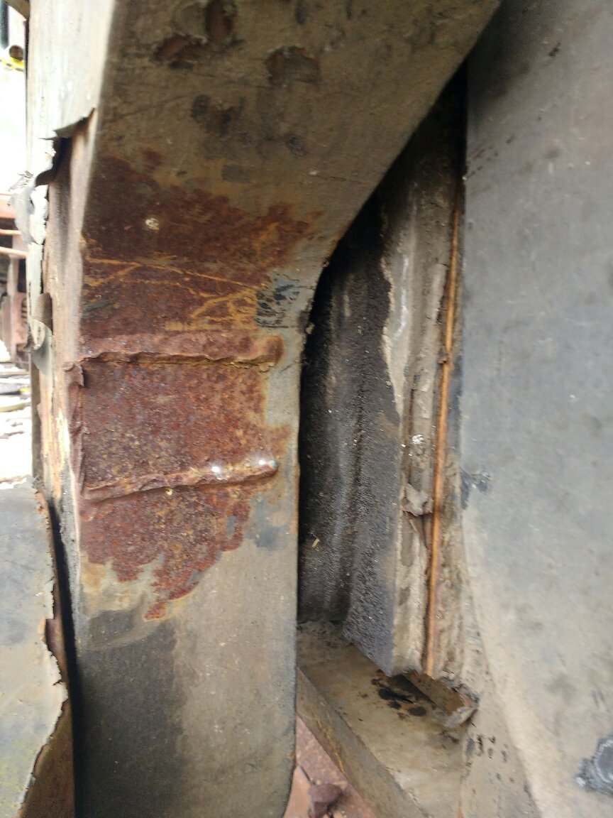

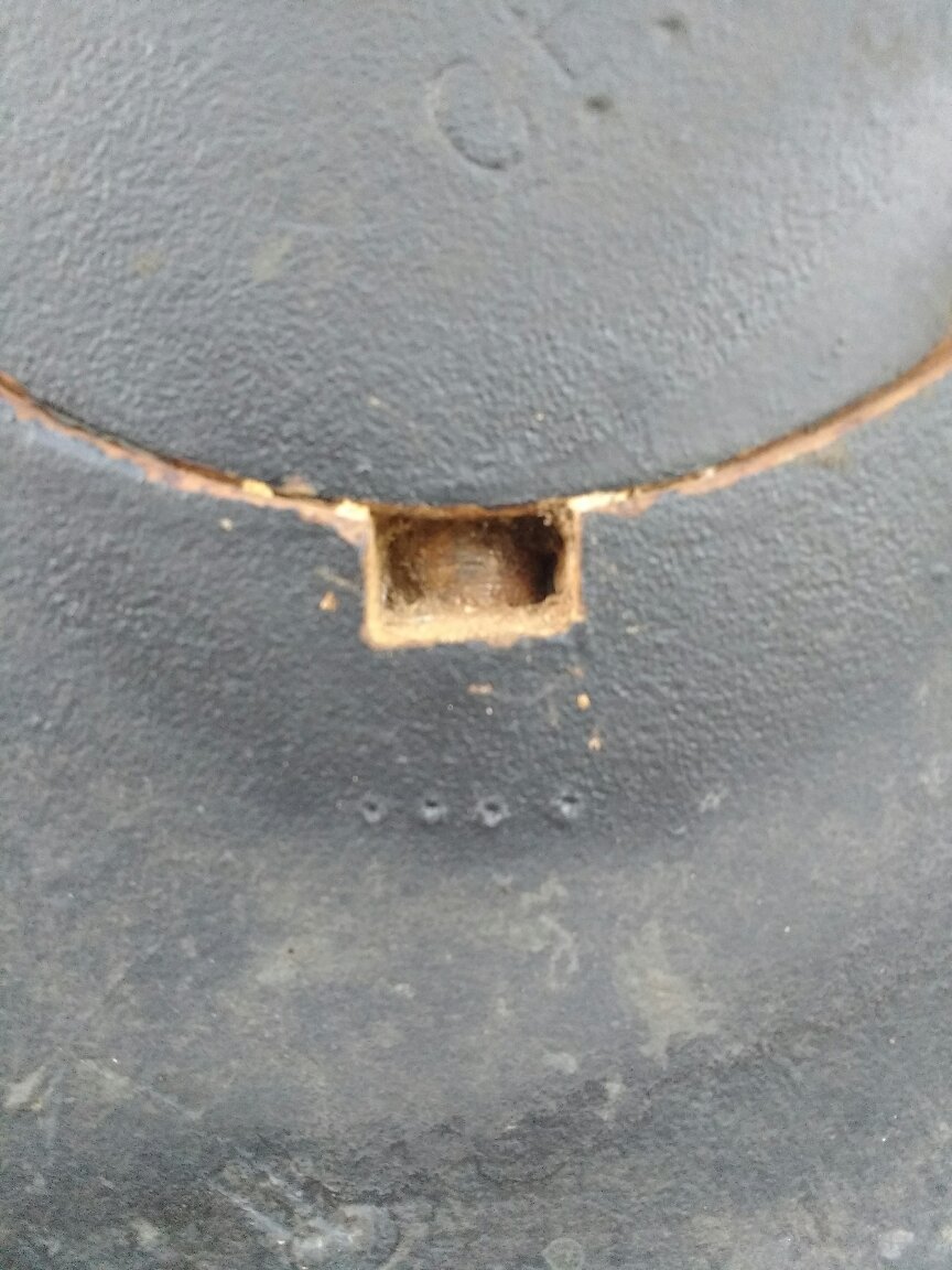

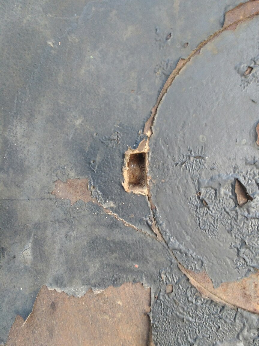

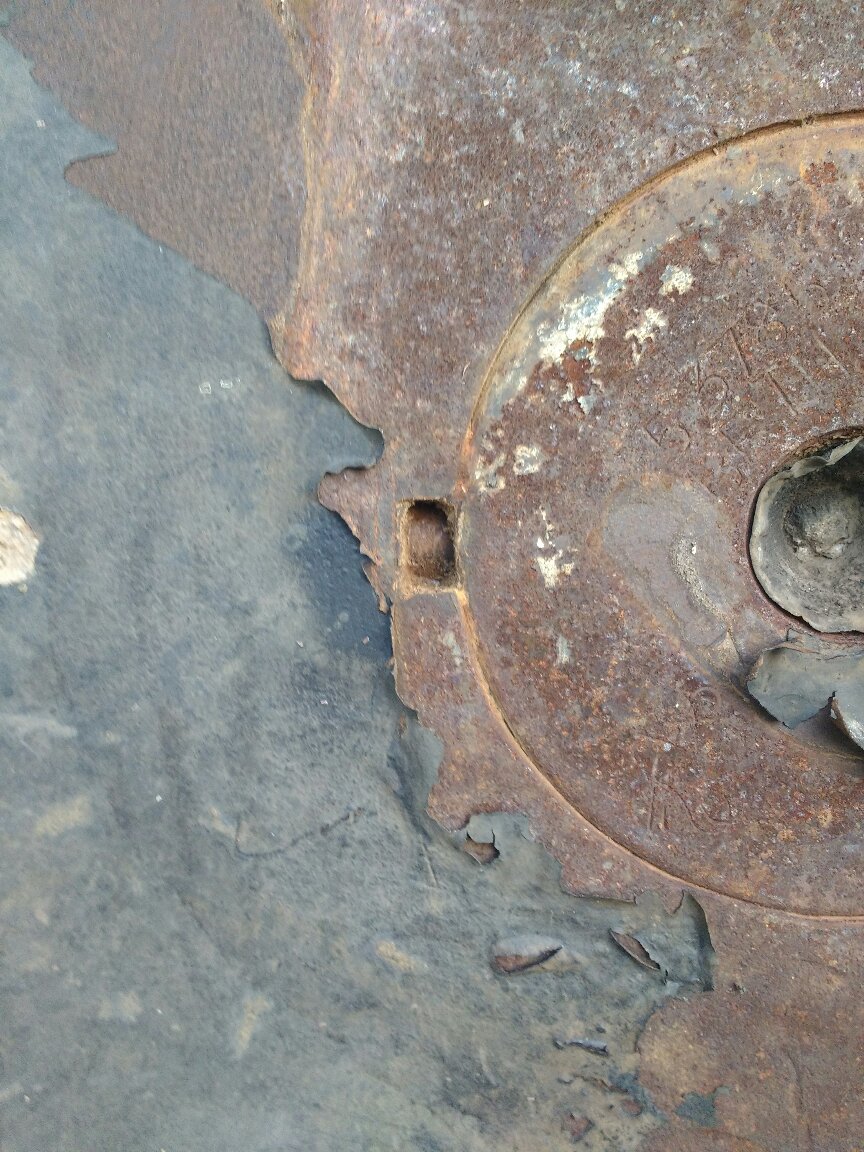

Anyway, it looks to me like the powered axle fireman side counterweight is probably the one causing problems. I attached pics of all four key ways on that truck. They are in order fireman power, fireman idler, engineer power, engineer idler. They are in order bottom to top on this page.
The fireman power axle counterweight looks to be not pressed all the way on the axle. The surfaces of the weight and axle are not flush like the rest. It is the one ith 4 dimples below the keyway.
We have no plans operate it any time soon, however operation might be something we look at in the future, so I would like to find a sweet spot where I can get the engineer rod in place so it isn't laying in the dirt forever. More jacking and pulling.

The weight with all the rust looks like it had something welded to it. Makes me wonder if it was cracked or something.
 Post subject: Re: GE 45 ton side rods
PostPosted: Fri Aug 03, 2018 11:28 pm
Posts: 245
Couple of the last bunch of pictures looks like the counterweights been working . Last bottom picture shows punches maybe for lining up the key. What do you think?
