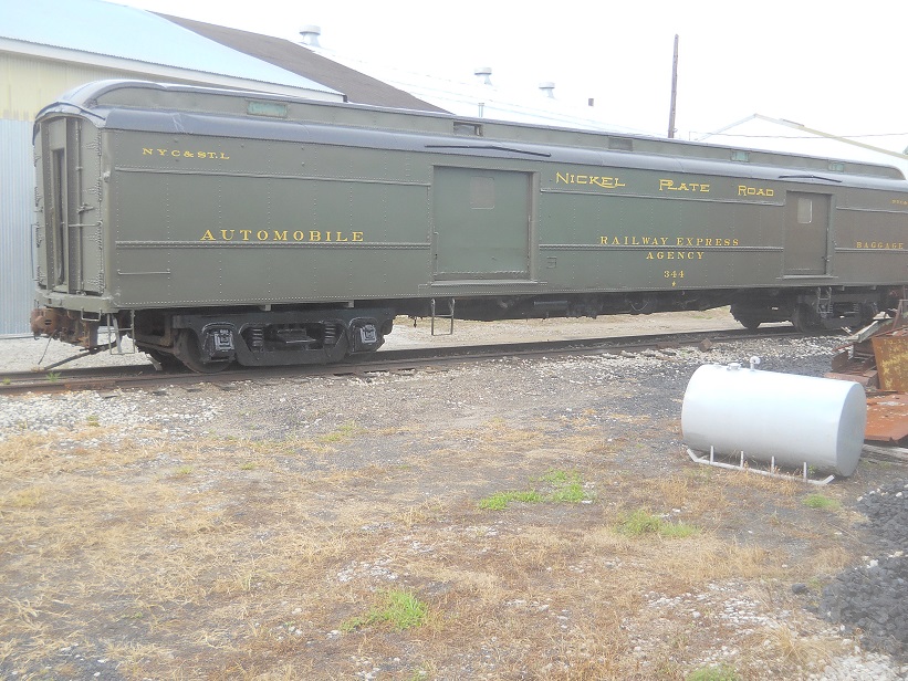

Mark managed to make it over to the museum later today and took this photo after he removed the tape from around the NYC&ST.L lettering on the one end of the car.

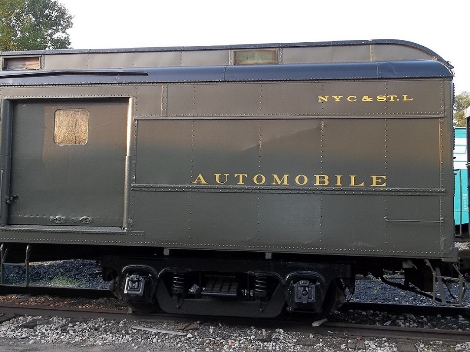

PostPosted: Sun Aug 12, 2018 10:52 pm

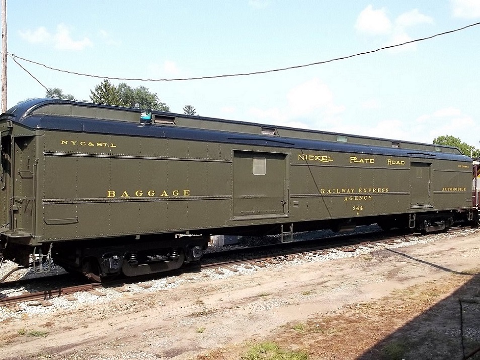

Mark was at the museum today in the heat and submitted this photo of the now finished south-facing side of NKP 344. Now.......on to the north-facing side where it all has to be done again!

Les,
That's a good looking car now. Tell Mark nice job.

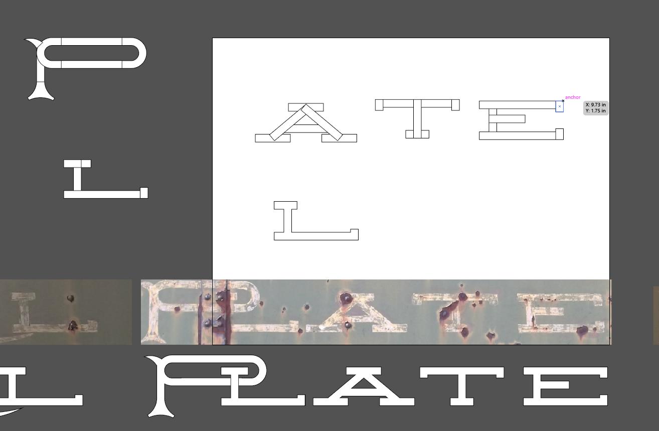

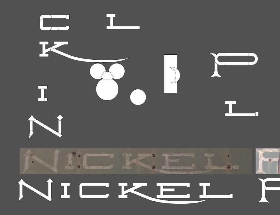

Thought some folks might like to know the story behind the lettering on NKP 344 at Hoosier Valley. The museum did not have a Nickel Plate Road stencil for the letter board of the car. I checked with HVRM's Bob Barcus who said that Bob Albert of the museum told him that those letters were 5" high. Using some photos that Mark Knebel had taken of the car where the paint had been sanded off exposing the original lettering, Mr. Barcus did his vector artwork using the "Adobe Illustrator" program to draw from scratch (with just a bit of artistic license) for Mark to use for the letter board. I think if you check the two attachments, you can see how Bob was able to make the new artwork from the photos of what was on the car. These were also shared with the museum at Bellevue, Ohio who in turn sent the tracings for the NYC&ST.L lettering up on the two corners of the car. The BAGGAGE, RAILWAY EXPRESS AGENCY and AUTOMOBILE tracings were made from standard Nickel Plate lettering from Mr. Albert's collection. Mr. Knebel came up with the star and used that standard Nickel Plate lettering for the cars number.
Hope this might be of interest to some.

Interesting to me at least. Mr. Barcus' drawing approach is similar to mine. I build most of the lettering from rectangles and circles before I do a final outline of the letters, even when tracing from an original drawing. Working with perspective corrected images is a big plus, too.

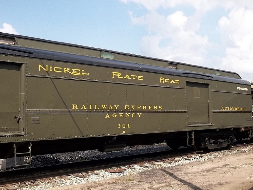

Missed two Saturdays at the museum due to family obligations and in those two weeks, Mark finished the lettering on the OTHER side of NKP 344. I've included a photo I took today of his latest work.
Mark is currently waiting for a set of screens being made for the vents up in the celestory roof. In the meantime, he has moved on to another museum project which I will save for another thread.

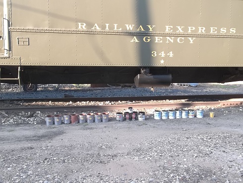

Is there a final tally on the materials used?

Emmo213 -
I asked Mark, and here is the report he recently furnished to HVRM's Board of Directors in what he described as a "past-the-time" project as weather and free time permitted:
Exterior prep and paint of 344 car body used a bit over 18 gallons of paint as follow as below:
8 gallons of primer
4-1/4 gallons of black
6 gallons of green (started with a 1/3rd gallon of old MAB and have 1/2 gallon of Sherwin-Williams left over)
1 quart of gold
4 black spray cans
10 wire cups
9 roller covers
1/2 dozen paint brushes
2 gallons of paint thinner (for clean up)
3 rolls of masking tape
misc.
Mark also furnished this photo to the Board.

That little quart can is too small to see, but am I correct that the lettering was done with One-Shot brand lettering enamel?
