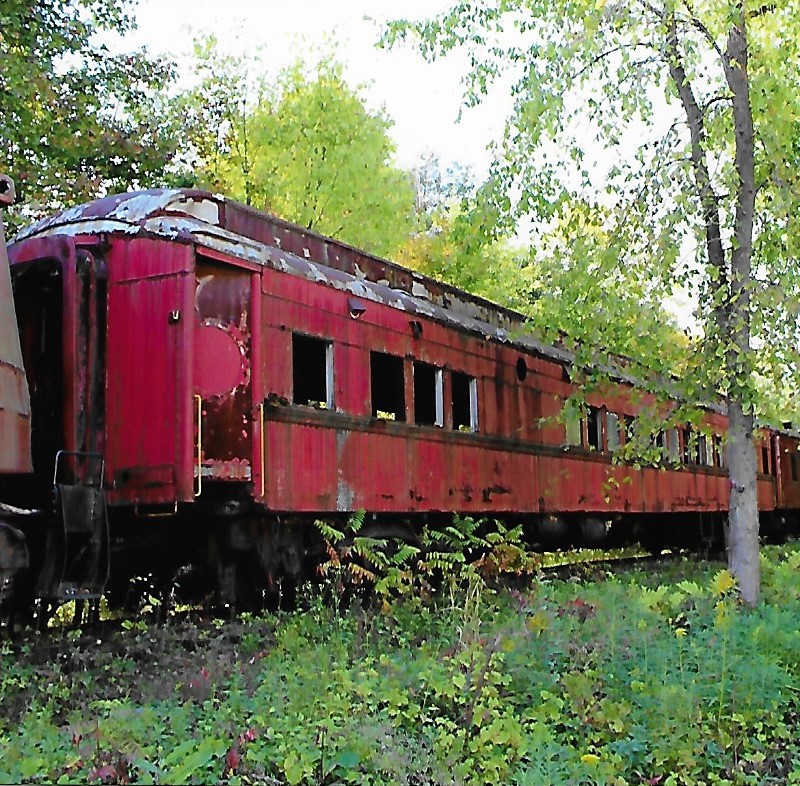

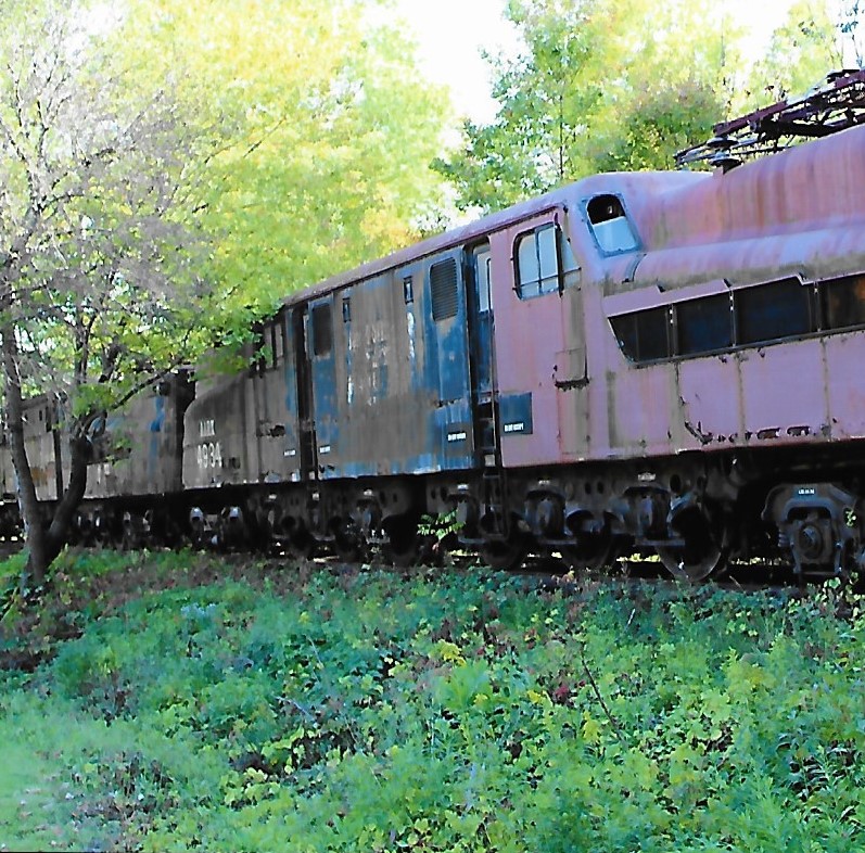

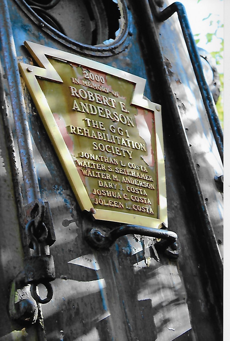

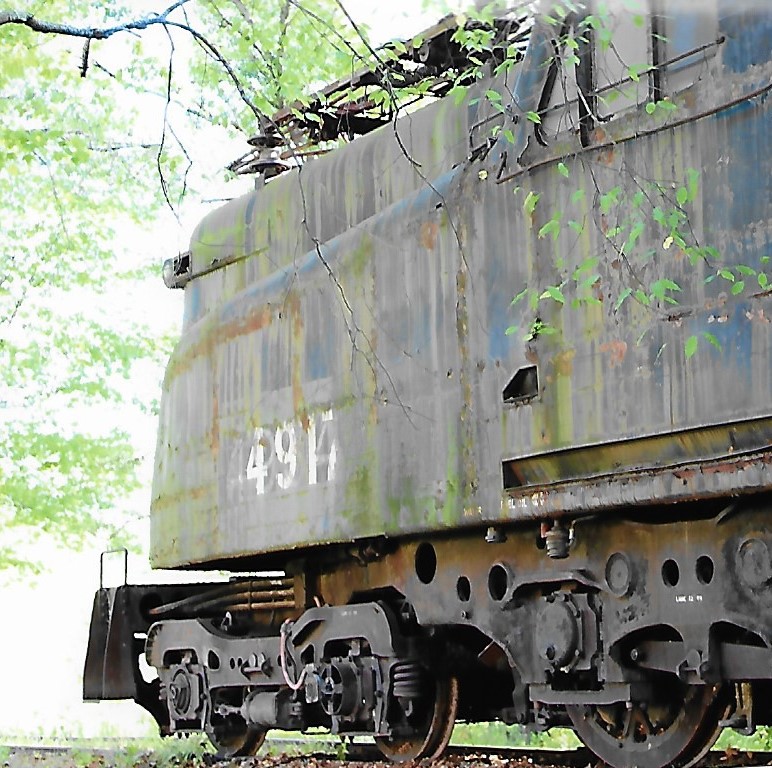

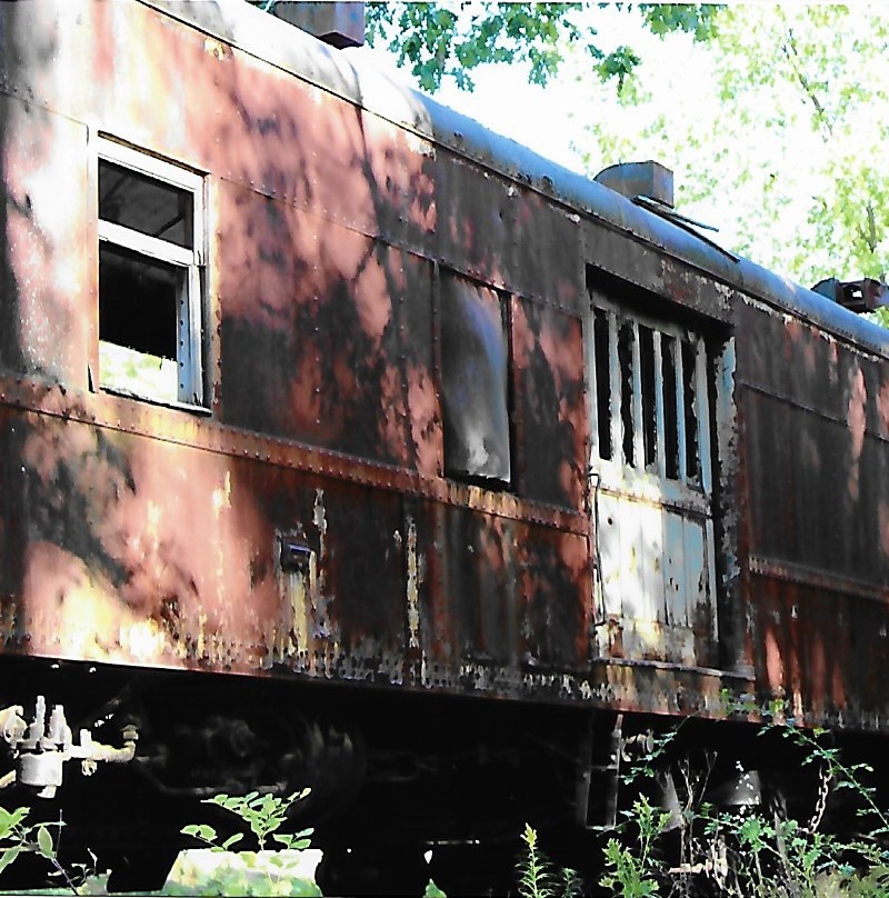

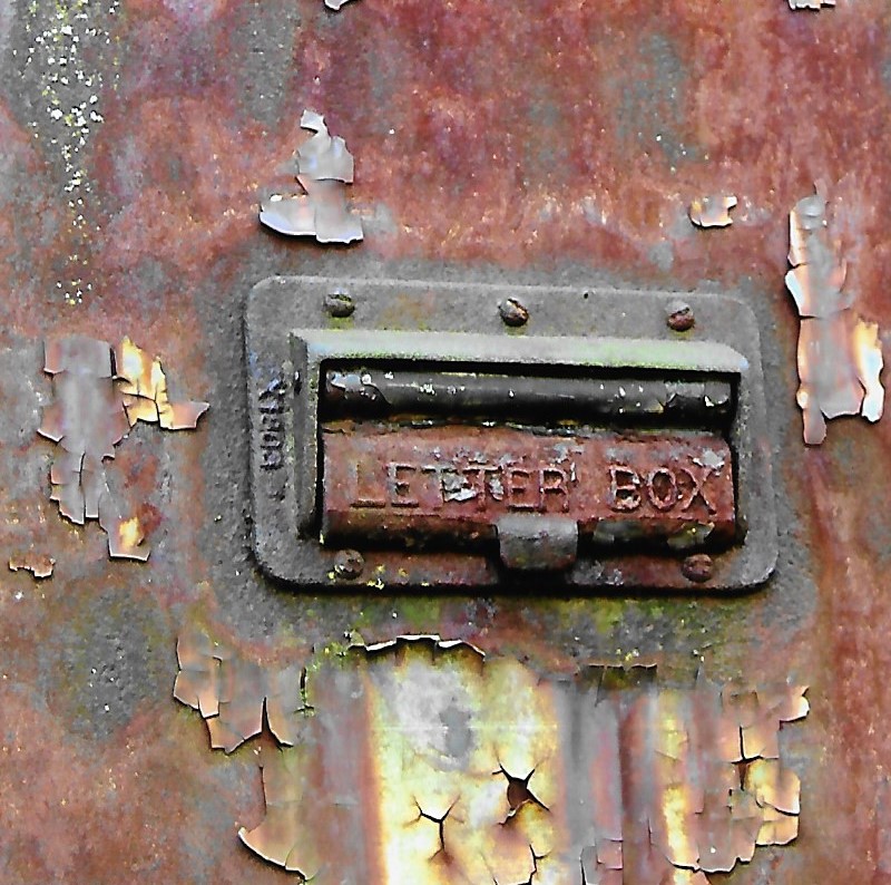

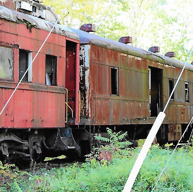

Curiosity finally got to me so my wife and I drove up to Cooperstown Junction yesterday to check out the stored GG1's. It was sad to see them slowly rusting away with very little hope of preserving them. One thing that we noticed after looking at our pictures when we got home that Pennsy 4909, Amtrak 4932 appears to be numbered 4917 which was the Pennsy # for Amtrak 4934. Not sure what happened there. Didn't find any markings on the passenger car but I assume it was an ex D&H. A little puzzled by the car behind but I'm guessing that it may have been an Railway Post Office car because of the letter drop slot on the side of the car. Would appreciate it if someone could fill me in on those 2 cars.
