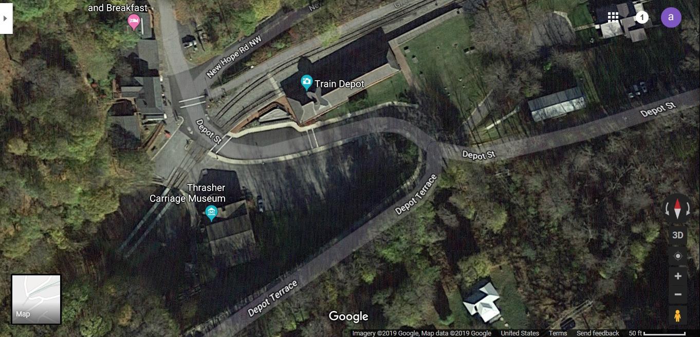

There's only about an engines length of track between Depot Street and the turntable. With the road being so close, I don't know how a level stretch could easily be achieved. I suppose you could raise the tracks and Depot Street but that would probably disturb the alignment between the passenger cars and depot. The turntable was shoehorned next to a steep hill in the only available space when the WMSR was established.

From the Google Earth photo above, it looks to me like No. 1309 will have to push its train back to Cumberland, unless another locomotive is stationed at Frostburg to pull the train into the clear so the big engine can escape to the other track, then couple to the rear of the train to lead it back to Cumberland in reverse. Is there a second passing siding in Frostburg?
Some years back, I was able to talk to a member of the management, and if my memory is right, he said they were planning to extend that siding, as well as adjust the curves at the turntable (that's the one place where things might be a bit tight for the 1309). Of course, that still leaves the vertical curve--actually a kink--to get onto the table.
I don't think the job would take that long to do, it would just cost money.
I rode the WMSR this past October and did not notice any other passing sidings at all. It would be difficult to install one now since a Rail/Trail runs alongside the excursion route. The trail mostly is laid over the ROW where the second track used to be.

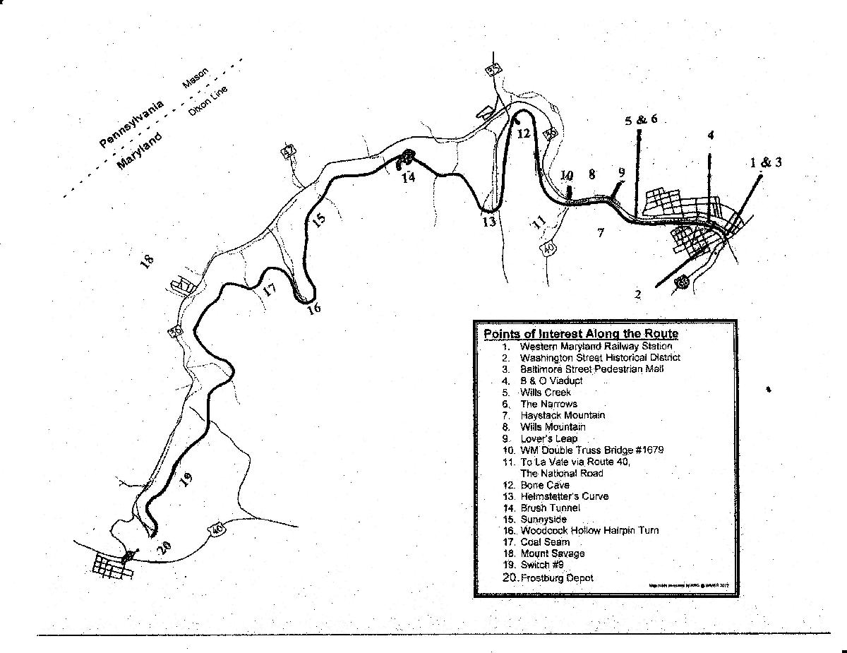

The stretch of railroad from Switch #9 to Frostburg on the old C&P ROW is uphill (about a mile, I think). If they are installing a passing track down on the old WM roadbed at switch #9, there shouldn't be a need for a diesel. 1309 could reverse the trainset slowly down to the new relatively level passing track and do an engine run-around and pull the consist (tender-first) back to Cumberland. Not as aesthetic as turning the engine but is the standard practice on most tourist operations (Strasburg, Wilmington & Western, etc.).
