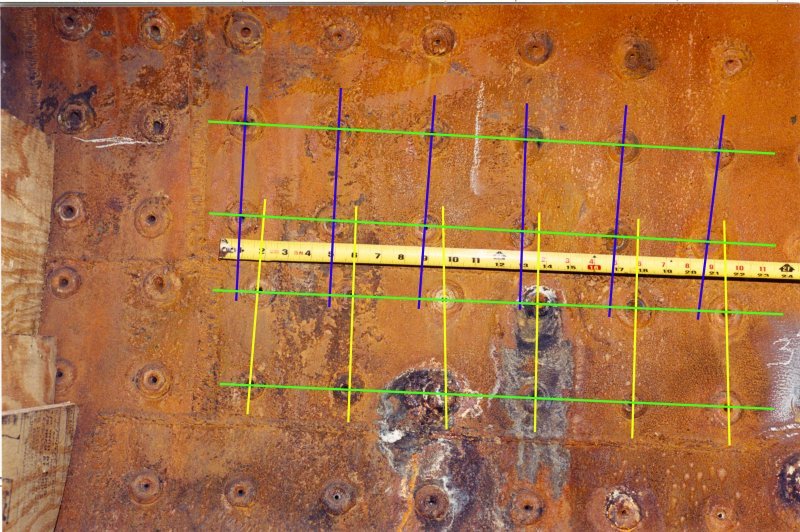

Kelly Anderson wrote:
This is not to say that older boilers didn’t have issues with staybolts being out of square with the sheets. There are plenty of cases of entire sheets having their holes patterns offset to their mating sheets, but generally not by an extreme amount. Off the top of my head, an error of more than ¼” would be unusual.
The old UP 844 crown sheet.

Greetings:
In an earlier post on this thread, Scranton Yard asked if there was "another way to maintain proper staybolt hole alignment".
There have been quite a number of firebox sheets made (mis-made) during the preservation era where some or all of the holes in the new sheet didn't line up with it's mate.
One method usually ignored because it is time consuming and labor intensive is to layout the new sheet empirically, using the mating sheet as a guide.
This is the method we used when we renewed the side sheets and door sheet of our No.40 in 2006-2007.
We fit up and tack welded the undrilled sheets in the firebox and then used a transfer punch (with a guide to insure the correct angle) stuck through the original holes on the outer sheets, to lightly mark the new sheet. Then the tack welds were cut, the new sheets were removed and layed on steel saw horses. The transfer punch marks were then "squared up" as needed to insure nice straight lines and proper spacing, then center punched and drilled to a size that the reamer end of our staybolt taps would start in. Then the sheets were re-installed and welded in place. Fit up bolts were used to hold the sheets with the proper spacing between the inner and outer sheets, staybolts applied and mudring rivets driven.
The sheets fit perfectly (first time).
Be well,
J.David
PS: Check www.essexsteamtrain.com Engine House Blog June 26, 2007 for photos. JDC

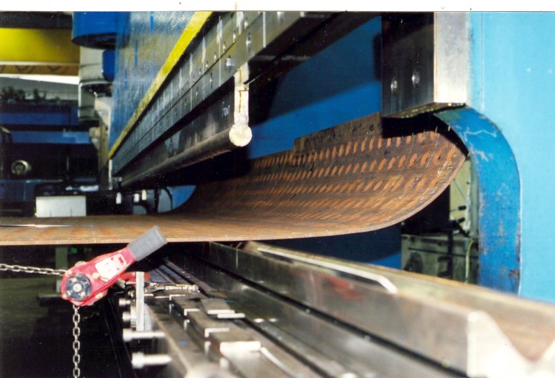

Newriver400 wrote:
Since they used a press brake, are the radii at the top corners a true curve or many small bends that accomplish the same thing? Or, did the press brake have rounded dies to facilitate something closer to a radius than several small bends?
UP 844 new crown sheet. No CNC, just 2 guys, a 1400 ton press with a 30ft throat, a bucket of shims and truck load of experience.

M Austin wrote:
Matt,
Thanks for the pic. I note that the top die is round which answers my question about the process.
