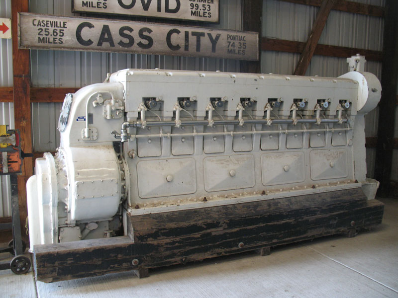

As a separate matter, here is one of the prototype Winton 201 engines from the Chicago World's Fair as shown on the 2nd page of this thread powering the demonstration Chevrolet assembly line. The 201 begat the 201A's that powered early EMC production. This one is on display at IRM.
I never knew that one of these old Winton 201 engines was at the IRM.
Thank you for pointing that out and the photo.
Now I have to make a visit this spring to the IRM and see it.
