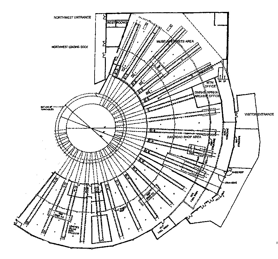

It does not HAVE to be round, you can have long and short stalls.
-Hudson

Hudson,
Very nice plan for the redevelopment of the Jackson St. roundhouse. Groups that have a real, live, actual roundhouse to start with are way ahead of the game. However, I thought the purpose of THIS exercise was to come up with the most cost effective (read cheapest) way to turn a virgin corn field (or any other "greenfield") into a representative roundhouse for museum display use, and hopefully do it with pre-engineered building components that would make it adaptable to several organizations needs.
Although, the more I think about the modular nature of the pre-engineered buildings, the less I agree with Mr. Ruiz that offests in the rear wall will increase costs. They will, but that increase will be offset by the savings of not building unneeded square footage to house shorter engines.

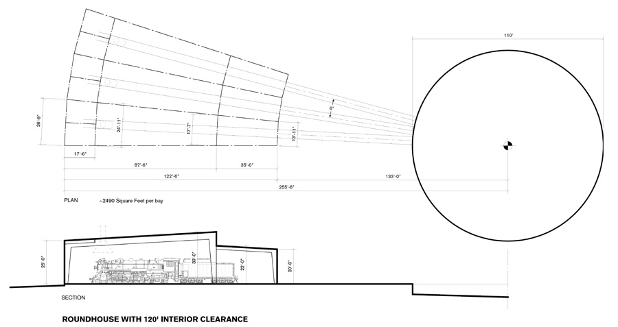

CSRM's roundhouse dispenses with economy and uses really wide angles between their tracks for this reason.
For the 120' roundhouse we are now talking about, it will need monitor or clerestory windows to light its deep interior. I have made a sketch based on Southern Pacific's 1929 Taylor Yard roundhouse, which maintained a 120' clear interior. A larger addition was planned to house the ACs, but was never built. Since this was in Los Angeles, they didn't bother with doors, and larger locomotives were allowed to hang out the back. You may notice that there is an extra girder spanning between the frames 17'-6" from the rear of the building. These support a beam between each frame. This keeps our purlin spans to 25' or less.
In this design, the bulk of the roundhouse is a shed structure that has a lean-to toward the inside to create the clerestory. I feel it is reasonably efficient. The frame could be done in one shot without the interior columns, but the extra moment connections just add cost, and roundhouses typically had a lot of interior columns anyway. The intrusion of these columns at the clerestory, and back near the tenders is not that bad.
File comment: 120' Roundhouse
About that wall jog issue, I still think it is a bit more complicated than you think, especially with this type of structure. The wall girts need a piece of vertical structure to attach to, so there will need to be additional columns added at inside corners. Keeping everything the same may make the labor cheaper. As I suggested, contractors charge for pain-in-the-butt costs. I could be wrong though, and it really depends upon how much building area we are talking about saving. At some point, it will make sense. Typically, a building system approach works most efficiently when it is repetitive.
In any case, designing for the deepest stall first is probably necessary if you want the roof to be continuous. If you design the small stalls first, you may end up with the roof coming down too low unless you plan for it from the start.

Thank you very much for giving some form and substance to my thoughts. Hate to admit it, but these posts have been pretty much a "stream of consciousness" affair, and after I addressed your monitor design, it occurred to me that the clerestory design has some advantages, as you've shown. Indeed, my last paragraph, which you've interpreted here, was a last minute edit on my part.
Randolph R. Ruiz wrote:
Dennis Storzek wrote:
I'm not so sure it makes all that much difference, at least as far as a steel framed pre-engineered building goes. Keep in mind that the amount of taper in each bay, 6*, isn't that much...
Pretty much, but I'd still want to see what the manufacturers say. Remember that at the inside wall, we will not be able to brace any of the openings since they are all doorways. There will need to be another set of frames along this side to provide lateral bracing. While I am not concerned about the 3º crank for the purlins, anything connecting larger structural members is going to need some attention.
These buildings seem to be braced with tension members because steel rods are a heck of a lot cheaper than compression members. The main cross bracing for the front of this building is going to have to be at the front wall of the clerestory. At 30' high and just under 18' wide at this point, the tension rods can be at almost 45* and not intrude on the clearance diagram. Adapting the rod terminations for the 3* wedge shape would not seem to be too much of a big deal. A secondary advantage of tension rods is they can run past windows with no effect on the light, so allow the max. glass area without any custom designed sash. Hopefully, L section corner braces in the door openings will be enough to satisfy the structural guy. These will need to be custom, I'm sure
My thoughts exactly.
About that wall jog issue, I still think it is a bit more complicated than you think, especially with this type of structure. The wall girts need a piece of vertical structure to attach to, so there will need to be additional columns added at inside corners...
In my experience these buildings do not use a clear span frame in the exterior wall; formed section columns on about 15' centers is cheaper. The way I envisioned the jog detail is to put the first shorter frame on the wall line of the jog, and the rear leg of that frame becomes your corner post. The exterior wall of the jog is then a post and beam extension on the same line as the short frame. Hopefully, column length is easy to customize so that the top of the frame matches the frames of the longer stalls. If not, it may be more cost effective to make up the difference between standard lengths with the height of the foundation. More than one way to skin a cat.
Again, exactly my thinking.

I confess I had not thought about using the tension braces above the track at the clerestory. Interesting idea, and the roof bracing might be capable of transferring the lateral loads from the front wall back to that line, but then again, it might likely need its own set of frames. At a certain point, these ideas begin to become academic. Sketching out a rough outline and trying to think through the issues of a building like this is as far as I feel comfortable going without talking to some manufacturers.
Yes, of course, but it is still a complication. Simple = cheap. On this big roundhouse, the back of each bay would need two of these vertical members to frame the windows, hold the girts for the siding, and allow for back doors and/or oopsies. We would not want to have one of these verticals centered in the bay.

Um, don't take the image too seriously. I eyeballed it, and it is not to scale. I was not sure how long the Hudson was supposed to be, so I made it 85'.

J3a-614 wrote:
Dennis, the engine is a Canadian Pacific 4-6-4--specifically, a class H-1b. This series is where the restored 2816 is from.
Thanks. I suspected it was Canadian, but I'm not that familiar with their steam.
No Fair! No wonder it looks like it rattles in the building... Kinda like the real estate pix that are always taken with a wide angle lens to make everything more spacious.
At 91' long, it's really short for a modern mainline engine; it carries a short tender. Part of our display space problem is the huge tenders that became common towards the end of steam, at least on roads that did capital improvements on facilities to allow their use. Sure hope no one finds a PRR T1 hidden in a barn, at 122'-9 3/4", it won't fit any better than ATSF 2903.
