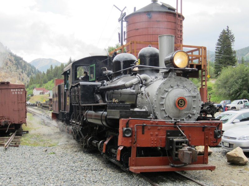

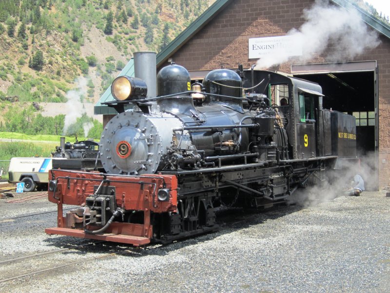

The Georgetown Loop just returned ex-West Side Shay #9 to operation. Even though it had run occasionally on the Midwest Central up until two years ago, a full 1472-day inspection was completed by the Loop, resulting in a quarter million dollars in restoration work over a year-and-a-half time span. A Form 4 will be filed (if it has not already been filed). The Loop stumbled a few years ago under the previous management, which brought the FRA knocking at their door. During the 31 years previous to that, when the Ashbys ran the railroad (until 2004), every effort was made to stay up with all the then-applicable regulations, and the FRA left them alone.
The FRA is not here to make your life miserable. Compliance will save your posterior in the event that a mishap occurs. If you're not in compliance and a smart plaintiff's attorney gets a hold of that fact, you're mincemeat. That's how it is. So stop gnashing your teeth over the 1472-day requirement. Smile, do the inspection, pay the bills, and realize you now have 15 years to pay attention to your business and make a buck with a safe and reasonable reliable locomotive.
Mike

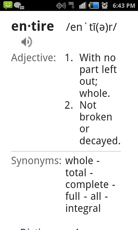

Do the regs actually specify what it means to inspect the "entire" boiler?
Steve
 Post subject: Re: DNE 28 2-8-0 Under Steam!!
PostPosted: Sat Jul 07, 2012 7:43 pm
Posts: 834
Location: Bowling Green, KY
Perhaps they don't, but Websters does.
Cheers, Jason
