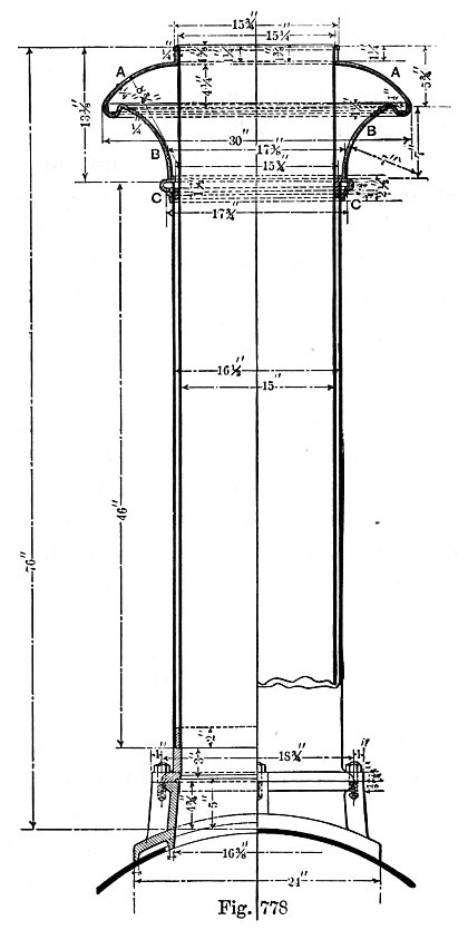

Regarding the material of which the capped was formed:
J.G.A. Meyer included the attached drawing of a capped stack in his Modern Locomotive Construction of 1892. He stated: "The cast-iron top consists of three pieces, namely the ring C, the flare B, and the cap A. The ring C rests on top of the outer shell, the flare rests on this ring, and the cap A is placed on the top of the flare; these are not riveted nor bolted together, but they are firmly held together by expanding the top of the inner shell over the flange on the cap A."

I'm inspired by the sharp reverse curve (drip lip) where the cap and flare come together on Meyer's drawing to wonder if the design originated as a means of limiting condensate running down and streaking the stack.
 Post subject: Re: Diamond stacks
PostPosted: Thu Dec 15, 2016 10:16 pm
Posts: 1543
In looking at the drawing posted on the previous page by Philip Marshall, the cross section indicates a relatively thin wall that might be sheet material. But the bumps that suggest a continuous ring shown in cross section suggest that it may be showing the cap as a casting. But even if that were the case, one might expect that bump to be cored out on the inside like an open “U” shape.
Now in the drawing above, posted by D. J. Sullivan, I see that the cap is a casting, and the open “U” is exactly how the circular external ring is made. Particularly in considering the cap as a sheet iron part, I was wondering if it might be made as an assembly of a few individual parts in order to make the whole cap easy to manufacture. Now I see that is what they did in the drawing above.
I suppose there could have been a lot of variation in the manufacture of caps throughout their era.
If they did make the cap as an assembly of 2-3 parts, the question is how to attach them to each other and to the stack. On all of the caps I have been looking at in photographs, I have not found any with the appearance of rivet or bolt heads around the base of the cap. Apparently, they want to replicate the look of the tops of the old style dome casings with the ornate tops used before the hemispherical dome tops that came into use around 1900. None of those show any fasteners either.
In wondering how they might have held an assembly of cap parts together, I had not considered the amazing approach shown in the above drawing posted above. It looks like the stack is two walls with the inner wall (called a “shell”) extending all the way to the top, and then rolled over the top like rolling a tube over a tube sheet. That would capture the three parts of the cap and the outer shell with its bottom resting on the casting that bolts to the casting that mounts the stack assembly to the smokebox. But what I do not understand is what fastens the inner shell to that stack bottom casting that bolts to the smokebox mount. It looks like the inner shell just telescopes into the upper bore of the stack bottom casting. How would they secure that telescoping fit? If that lets go, the remaining four parts could freely separate from each other.

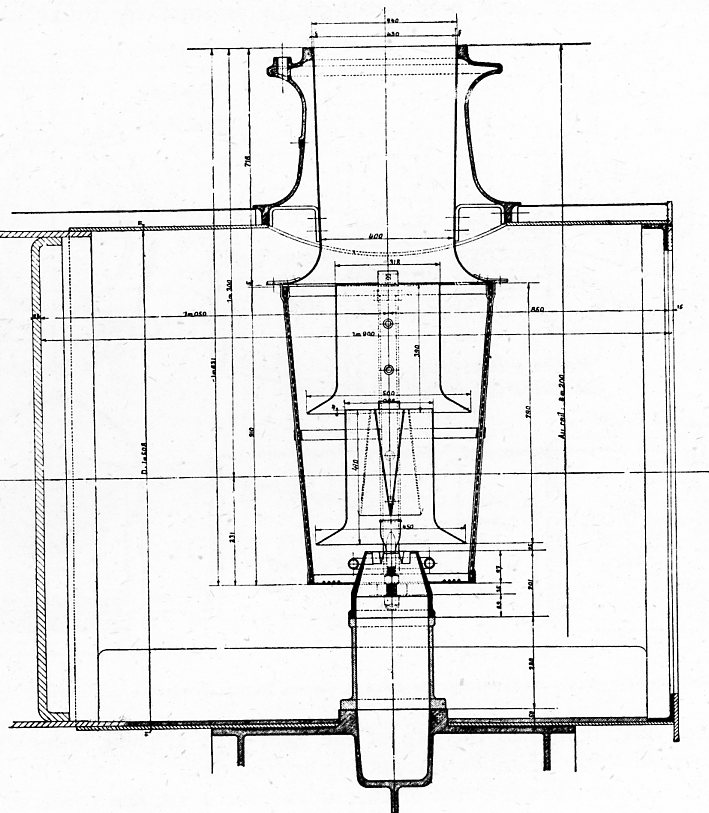

Just to show one way our cousins made a capped stack: this from England in a 1946 publication.
The issue with a tapered stack appears to surface in the late 1890s. And, like nearly everything else associated with the front end, it was subject to debate and interpretation.
