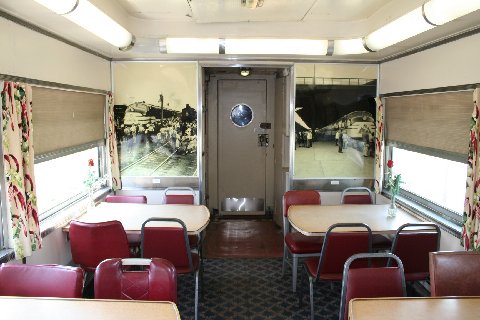

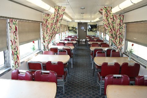

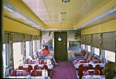

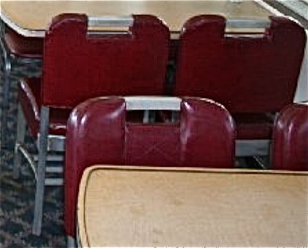

ahh.. in the spirit of turning this thread into something positive.... I had a an opportunity to speak with a young lady in Bowling Green at the ex L&N depot, who had the responsibility of taking care of the station and equipment... Although I don't believe per say she was involved with the actual restoration work ( which is done by volunteers ) she asked me a few questions, and had a few things they needed as a group... Of particular interest to her, were dining car chairs, for the ex Southern Pacific / Amtrak diner that were either correct for that particular car, or period correct for a diner of that age... Per the photographs attached of the SP diner, it has a mixed matched set of chairs, some being railroad chairs, other being auditorium style chairs.... I never knew much of the happenings in Bowling Green, but even though they ( in theory ) are replicating an L&N train set, they seem to have the overall best interest of the equipment, and the public at heart... So if anyone has a spare set of 1940 era dining car chairs ( I think many were produced by... was it General Fireproofing of Youngstown Ohio... perhaps a deal could be struck....( in a back room at the depot was a pile.. perhaps 6-8 wood bottomed art deco style to some extent... chairs that they claim were in the car.. that perhaps could have been original ?... Not too sure .. if anyone has a photograph or could link a photograph showing the original chairs .. that would be helpful )
I am not a spokesman nor involved in their activities, however just thought that perhaps we could change the course of the discussion to something more positive... and perhaps a group has a large collection of un-needed chairs, that could go to what would seem like a very good home ( yes.. even in Kentucky ) .. I could provide more information if necessary...
Dean Levin

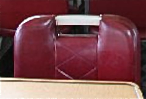

In case anyone has a remote interest, a good friend Robert Zenk, emailed me a photograph of sister car 10204 in service in 1968... ( Robert took a tremendous amount oh high quality SP photographs prior to Amtrak...)
In the photograph you can see car 10204 in use, which shows its diner - lounge configuration and the chairs that were on the car, that match a handful of the chairs on the car in Bowling Green KY... if you compare the current pictures with the 1968 photographs, note the murals from 1968 and the images today.... alot of interesting things... such as the car kept its original tables ..
so... sorry to carry this thread a different direction ( in theory we are still in Kentucky ) ... however we are talking SP dining car chairs for a car built for the San Francisco Overland being replicated as an L&N diner ( .. but it is in Kentucky... )
Any help finding this group some more matching chairs would likely mean a tremendous amout to those in Bowling Green....again.. I can provide the contact information should someone or a group be willing to help...
Dean Levin

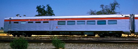

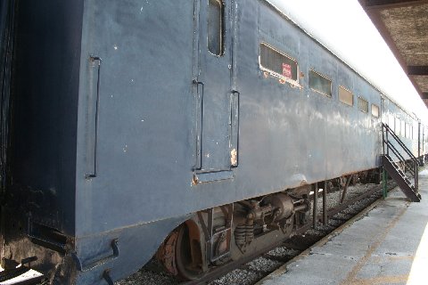

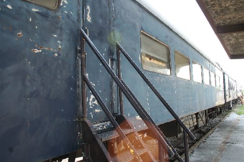

SP diner 10202 ... in the SP era and today ..it would appear in Bowling Green only the visible side of the cars ( to the public ) have seen paint and lettering ( not sure why ? ) ....it was said that this car was involved in an Amtrak derailment that led to its retirement... does anyone have any information about this incident ?
Dean Levin

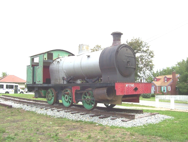

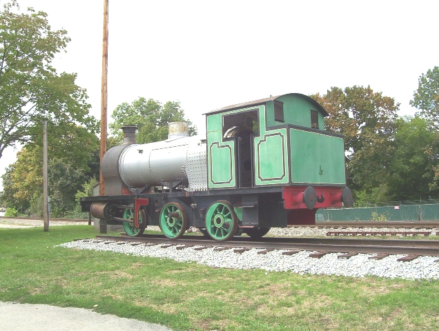

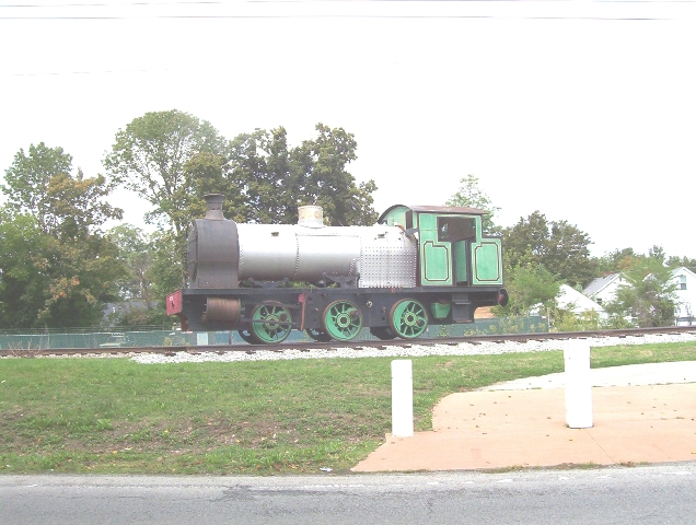

I'm a veteran of Bluegrass RR Museum as a volunteer, and Big South Fork Scenic Railway as a paid professional. Both are here in Kentucky, and I've been through the ups and downs with both of them, and have the caked on mud and battle scars to prove it. I've seen the ups and downs at KRM. With that in mind, I'll keep my posts to the original topic.
I had the opportunity to perform a hydro test on this engine back in the late 1980's when it was all in one piece. It had been taken apart by volunteers a few years ago in an effort to do some preservation work, but this is as far as the work progressed. I talked with the folks at the storage area today, and they assured me that a container with all the parts was shipped along with the engine, and that container was packed by several volunteers and the prior owner of the engine over several days. Thus, I can only hope that everything is accounted for.
I had to work in LaGrange, KY today, so took my camera to take a few pics:

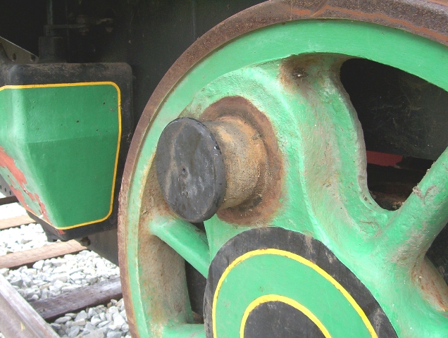

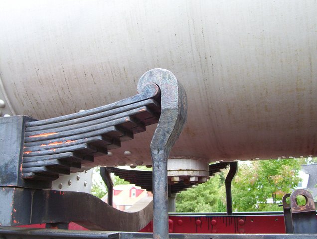

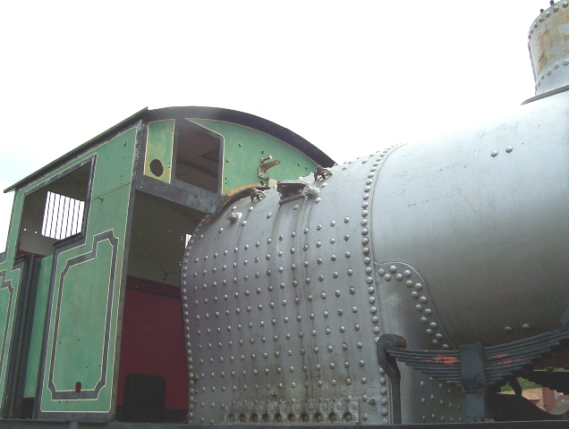

Steam loco mechanics will note a few differences from our "built in USA" stuff:
1) There are what appear to be transverse thru stay rods in the wrapper sheet that go across the firebox. Just above them are two hand plate washouts.
2) There is no equalization....each axle is sprung independently. Notice how the springs attach to the spring hangers.
3) The crank pins and collars are one piece. The rod brasses must be split and go over and then taken up to fit.
