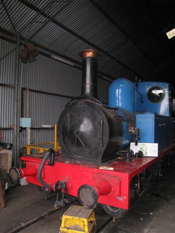

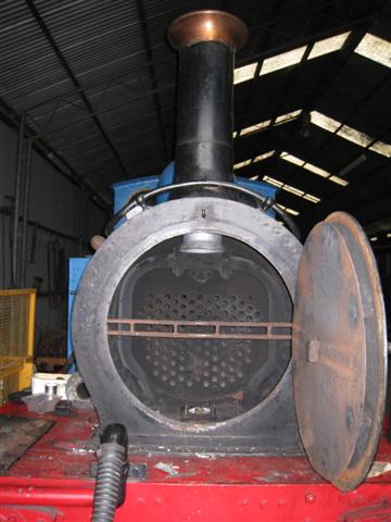

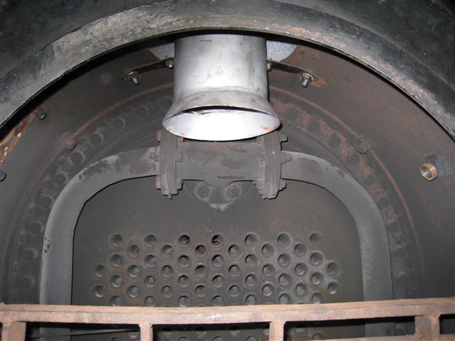

A little more progress
Latest work on the Fowler involved replacing the chimney on the smokebox.
The saddle now has a fibre glass tape gasket to seal it against the smokebox and better fitting bolts.
There are brackets fitted to the mixing chamber and some of the smoke box saddle bolts to ensure its kept central.
There is no news on the nozzles.
I also refitted the right side eccentric rods uncrossed and the lower rod on the left side, that is after fitting the rebushed rocking lever.
The eccentric rods were previously crossed.

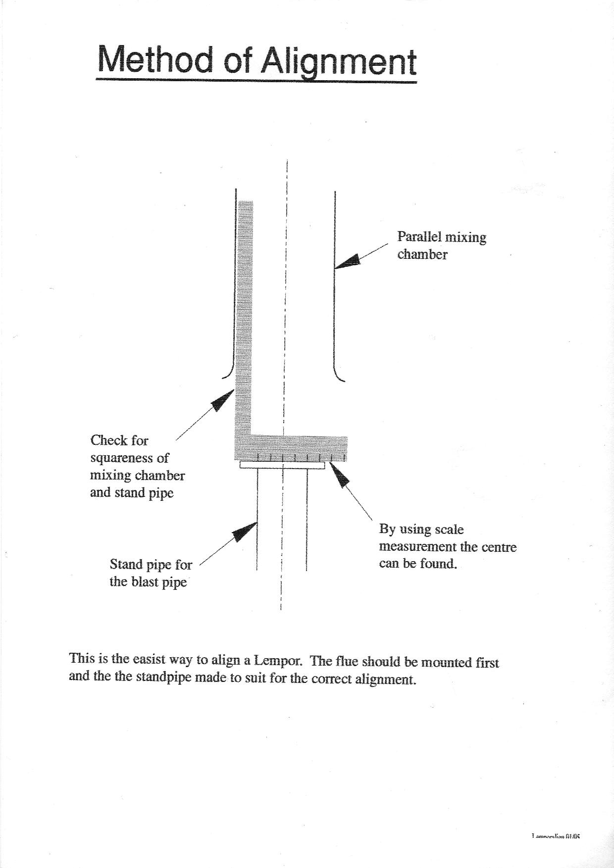

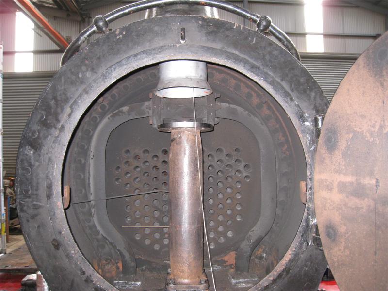

    Nigel asked me to post this instruction for aligning the mixing chamber with the blast pipe and I have included the latest photo of the Blast pipe and mixing chamber.
    Unfortunately I am still waiting for the nozzles to be machined but I am told they are being done.
