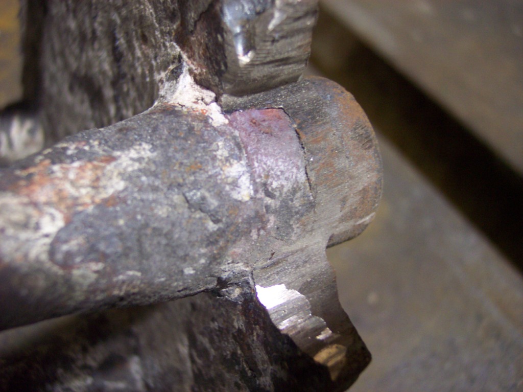

Thought I would post some pictures from my staybolt collection. This picture is of a BDR 26 staybolt and cross-section of the surrounding wrapper sheet from a German Class 01 Pacific built in the late 40's and removed from service in 2005. One can see the shiny area from the 6mm fillet weld removed from the bolt and not much going on in the crevice. This boiler was on an excursion locomotive with operating characteristics and water treatment typical to the U.S. It also started out a coal burner and was converted to oil firing. Germany is very humid, and the wrapper is pretty corroded, however, I did not get specifics on why the boiler was being replaced. Boiler life in Germany and surrounding countries is typically 50 years and the locomotive number is related to the frame as opposed to the boiler.

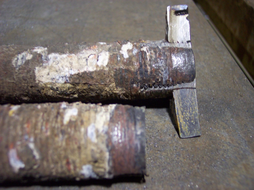

Here are two staybolts from a locomotive in the U.S. with a 1940's or 50's era firebox. It has a very similar service history to the German boiler boiler I posted the pictures of. These threaded staybolts were "seal-welded" at some point in its service life, probably because they were leaking. The threaded area of the bolt with the firebox sheet removed (close) shows clear signs of working in the sheet. The far staybolt has had the "seal-weld" removed - it now freely articulates on the sheet and could probably be pulled off by hand. The staybolt was functioning well in service, however, and was replaced due to firebox sheet corrosion. This is a great example of an undocumented and unintentional conversion to fillet-welded staybolts and is probably not limited to this example in the U.S.
