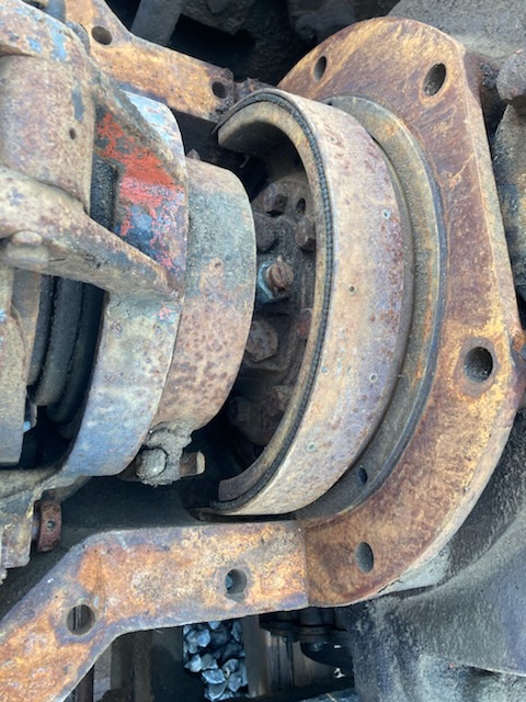

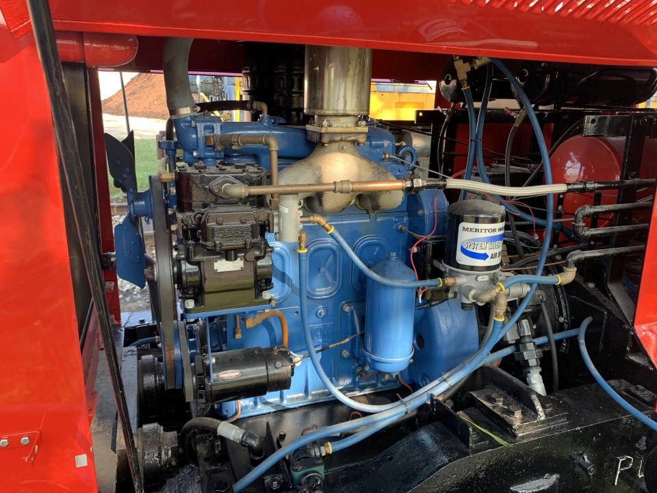

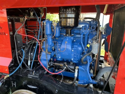

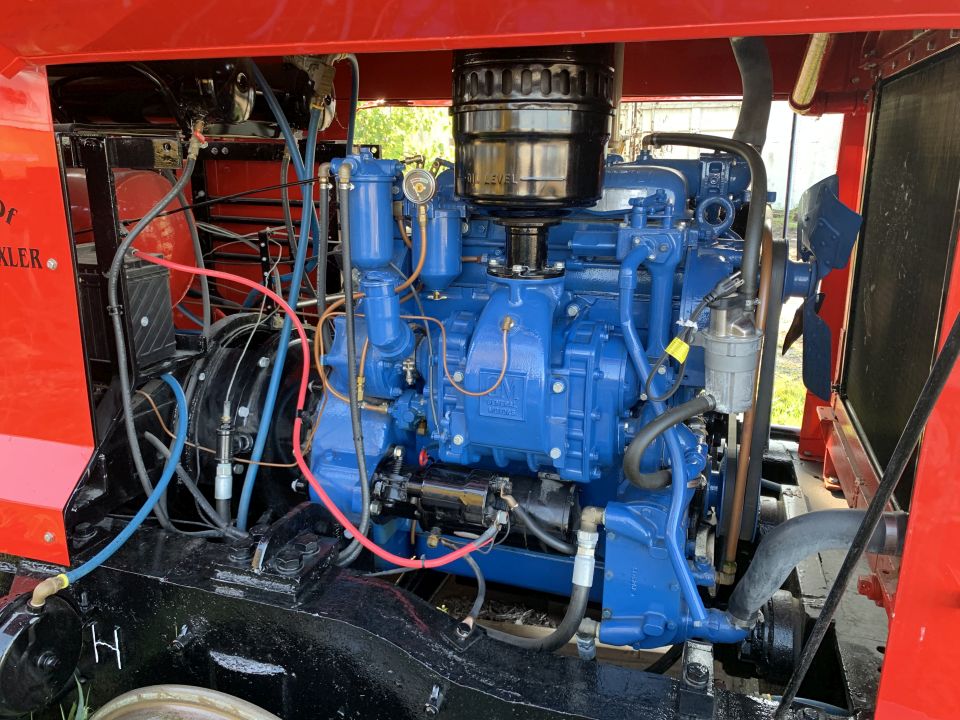

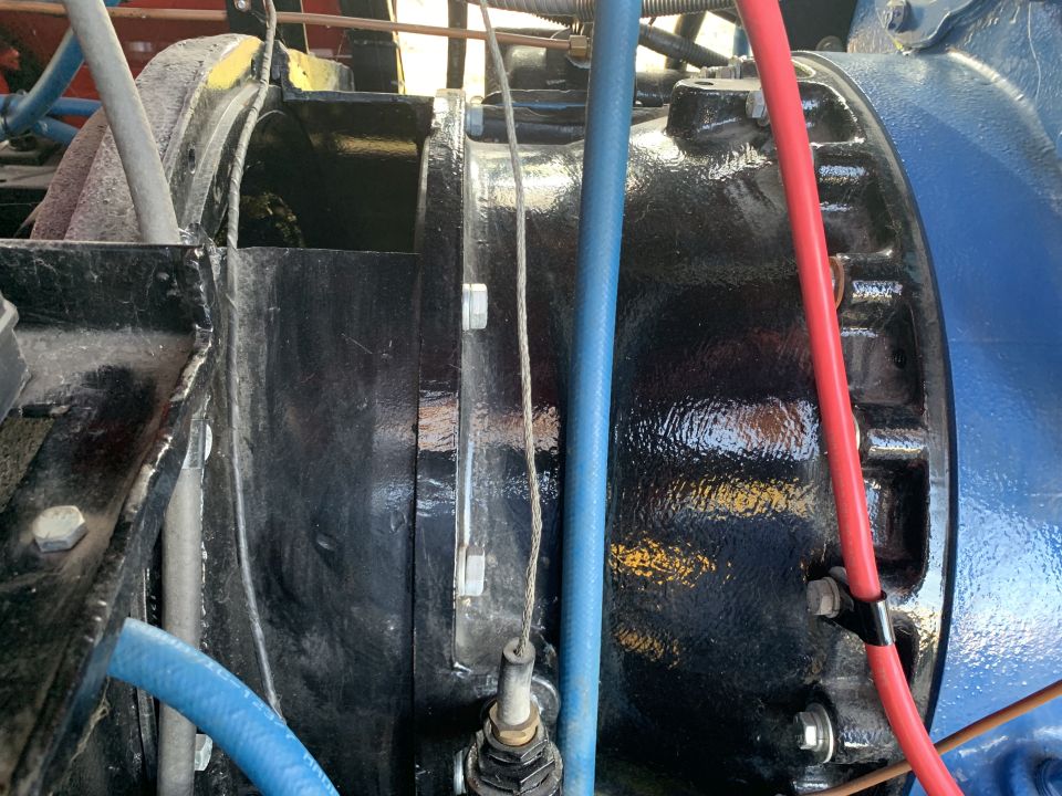

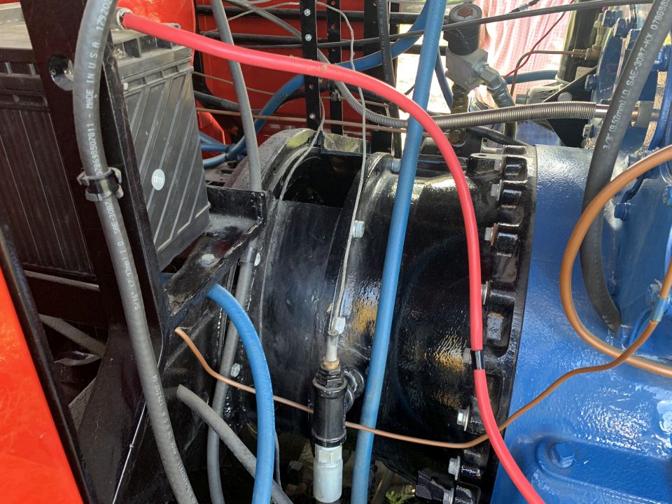

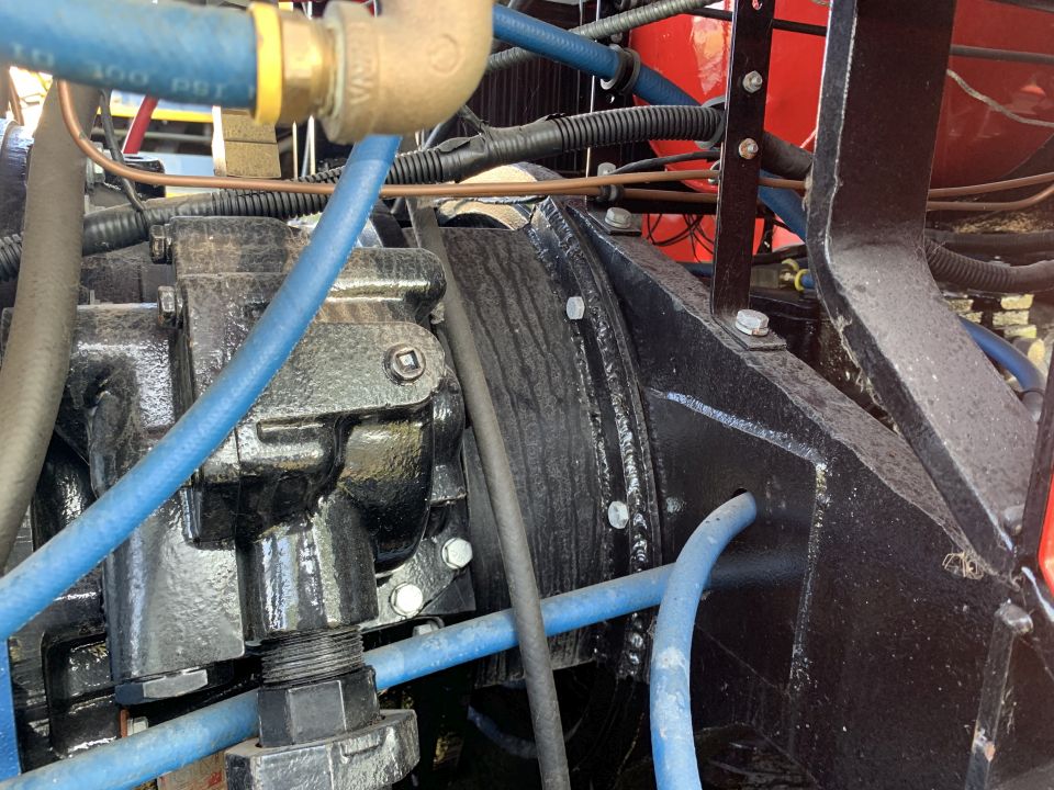

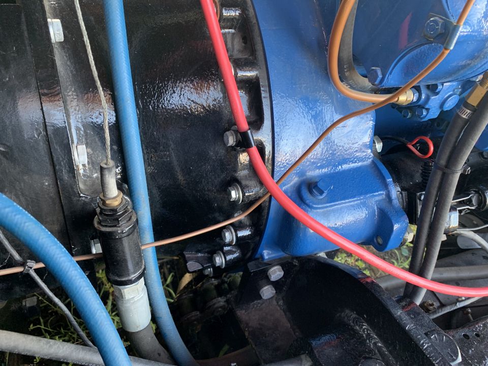

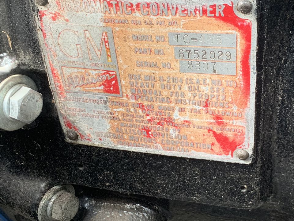

I have no info on how our conversion came about or who actually did it but ours now has a Detroit 3-71. There’s an adaptor/extension housing between the engine and transmission where your typical bell housing would be, in which resides an Allison torque converter. The torque converter drives the original Plymouth 4-speed transmission. The torque converter is definitely a plus cutting down how much you’d use the clutch starting and stopping.

Images of our 8-ton setup:

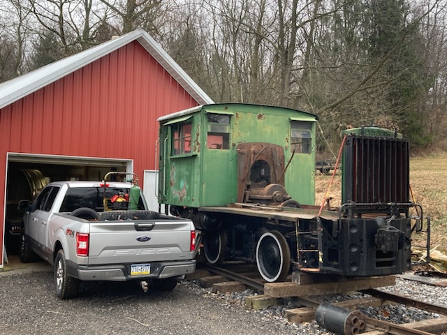

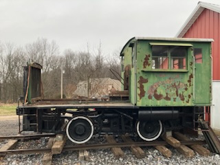

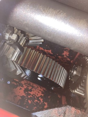

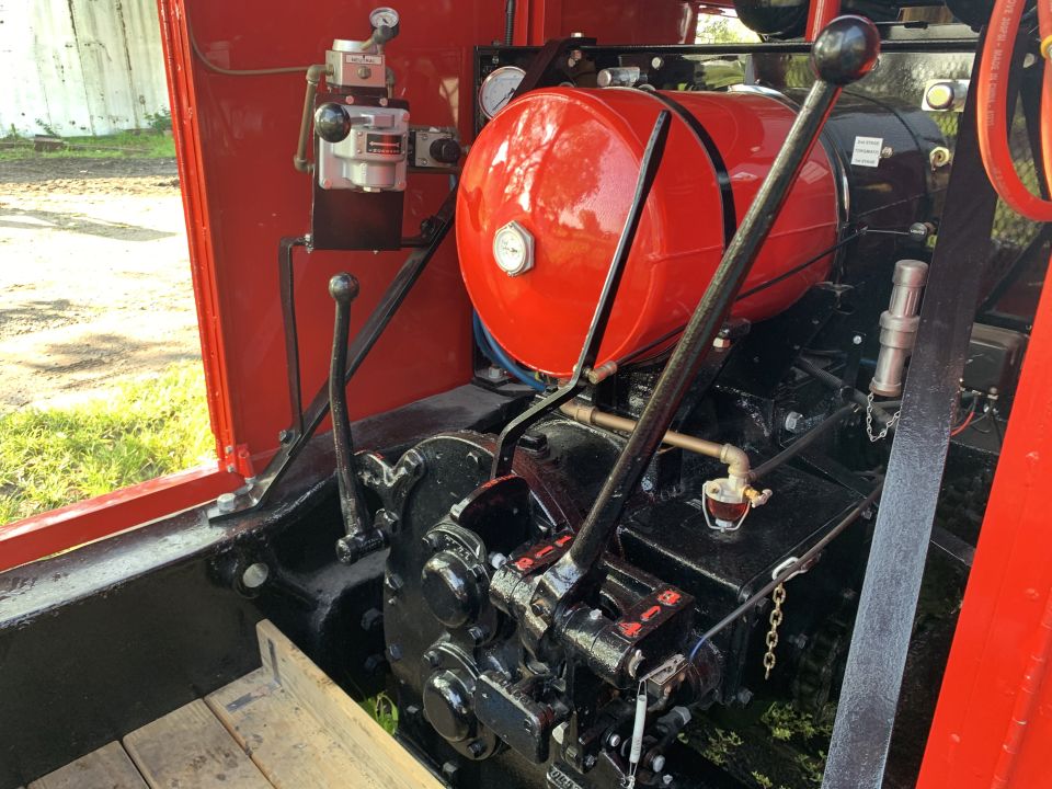

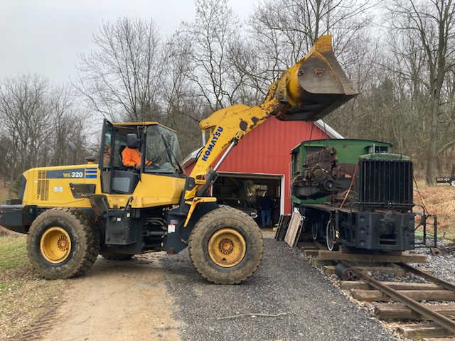

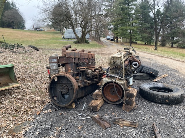

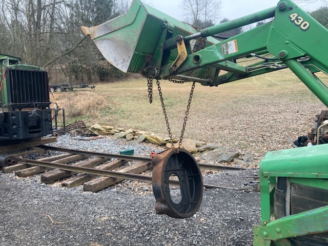

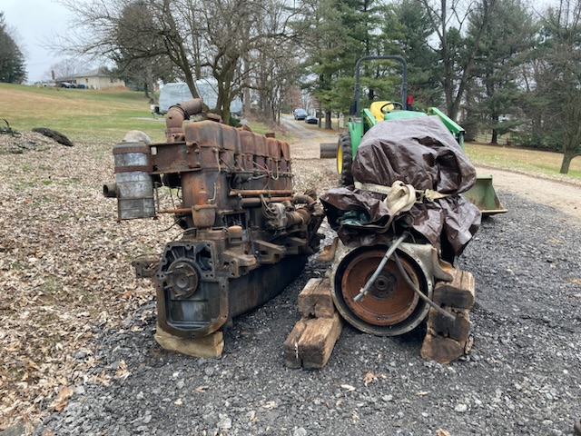

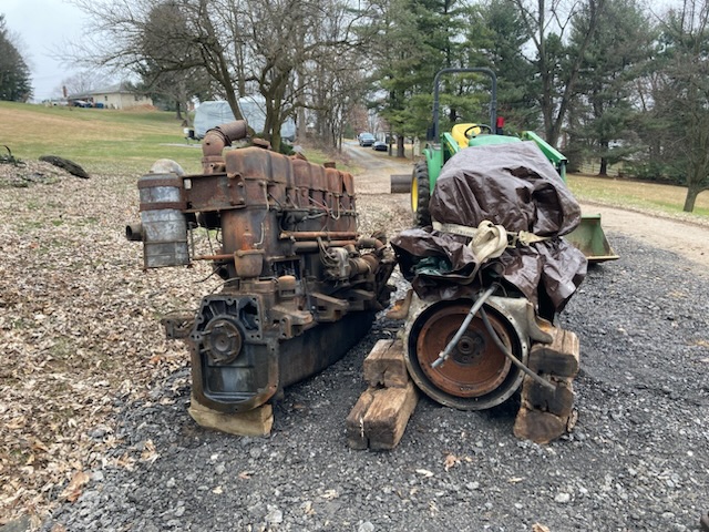

The engine is removed.

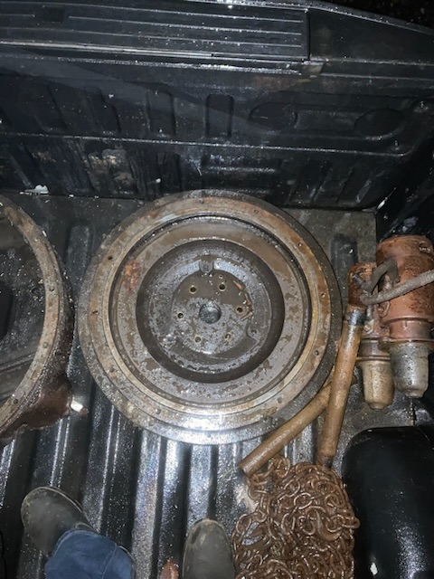

I have the flywheel and bellhousing removed from the LeRoi. Will need to make a puller to get the flywheel off the Cummins. Then I’ll figure out what needs to be fabricated to adapt the LeRoi parts on to the rear of the Cummins.

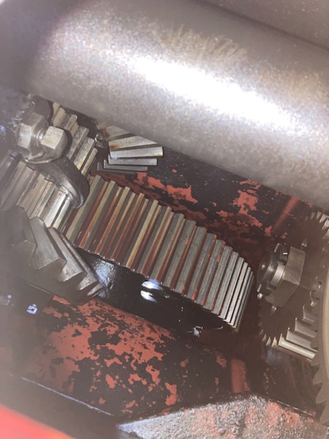

I also got to look inside the transmission for the first time. Looks like I just need change the fluid.

I can’t really tell from the photos, but I’d guess the adaptor for bolting up the engine is gonna be easier than figuring out the brackets for the engine mounts so everything lines up straight and stable.
Does your transmission have the internal disks or is the clutch flywheel mounted? I don’t know much about Plymouths, but I am curious. We’re eventually going to have to pull our engine as the internal disks won’t release. We have to almost kill the engine to stall the torque converter to put it in gear or change gears. If we’re pulling one car, the converter allows you to just start in 3rd or 4th gear and go without shifting, easing the throttle and watching the fluid temperature as you get rolling. It’s only a teeny 8T so there’re no fast starts without slipping anyway.

I see that I didn’t include any of the flywheel installed on the engine. Here ya go. Pardon the picture quality, it’s dark and rainy here. Basically the Plymouth clutch housing bolts to the rear of this flywheel with the outside set of holes. The system won’t currently let me attach the picture to this post. I’ll submit this one and try again.
Also, the new engine mounts will be tricky. The cover for the clutch that bolts to the bellhousing doesn’t seem like it’s designed to be the only rear engine mount. I’ll have to add mounts on each side of the bellhousing and a sturdy mount at the front. The original engine had 8 engine mounts.

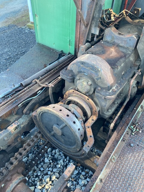

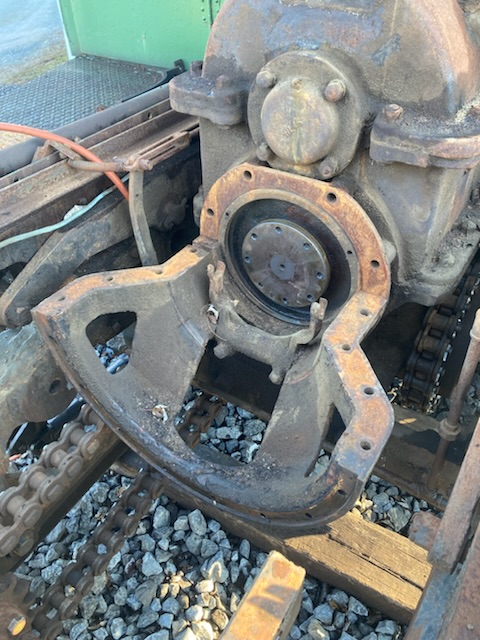

PostPosted: Sun Jan 01, 2023 2:45 pm
Joined: Fri Jun 03, 2022 8:04 pm
Posts: 130

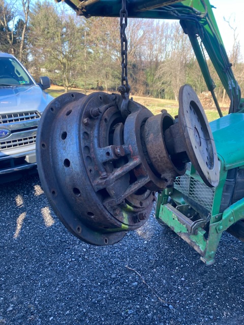

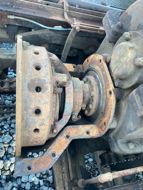

Here are some pictures of the clutch and clutch brake removal today. I removed the clutch as an assembly and will take it apart tomorrow.
For some reason, the transmission input shaft has about 1/4” of side to side movement. I’ll have to remove the input shaft and see what’s worn.
